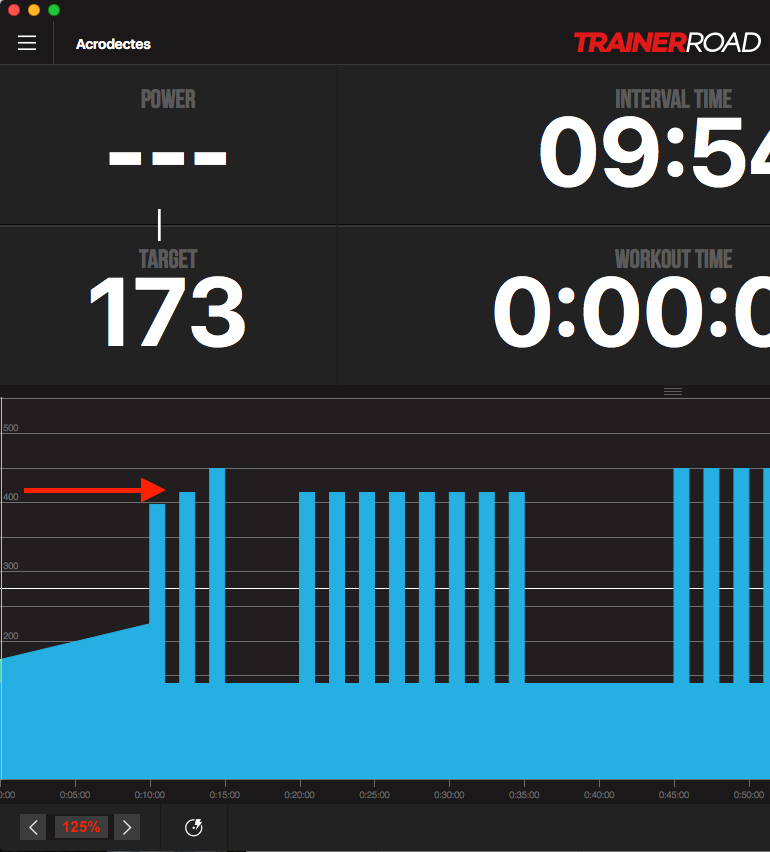

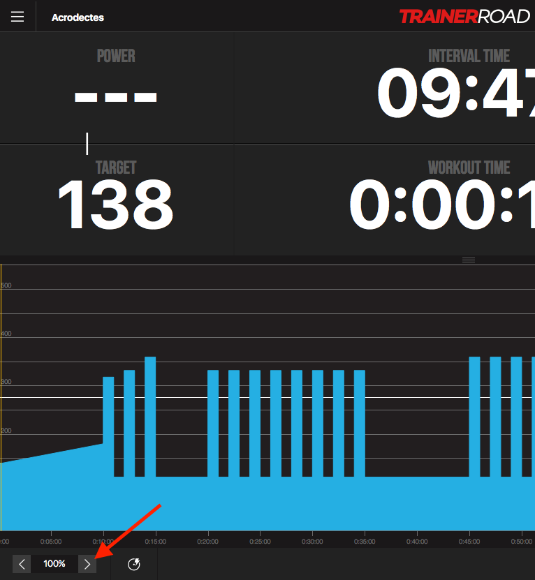

First, open the workout. Then, find the box in the lower left-hand corner of the screen that allows you to adjust the workout's intensity (screenshot below). This tool allows you change the IF of the workout while keeping the workout's intervals the same.
Note that the course profile of the ride below has the same intervals, but a higher IF and higher power.

How will the course profile and green IF line display during the ride and on my Career page?
If you change the IF of a workout, the course profile will adjust accordingly and an inflated or deflated course will display for the duration of your ride. After you complete your ride, the workout will display on your Career page in its original form. However, the green "Actual" or IF line will display the intensity of the workout that you did. The screenshot below is an example of what a ride with a manipulated IF looks like on your Career page (without the power data).
