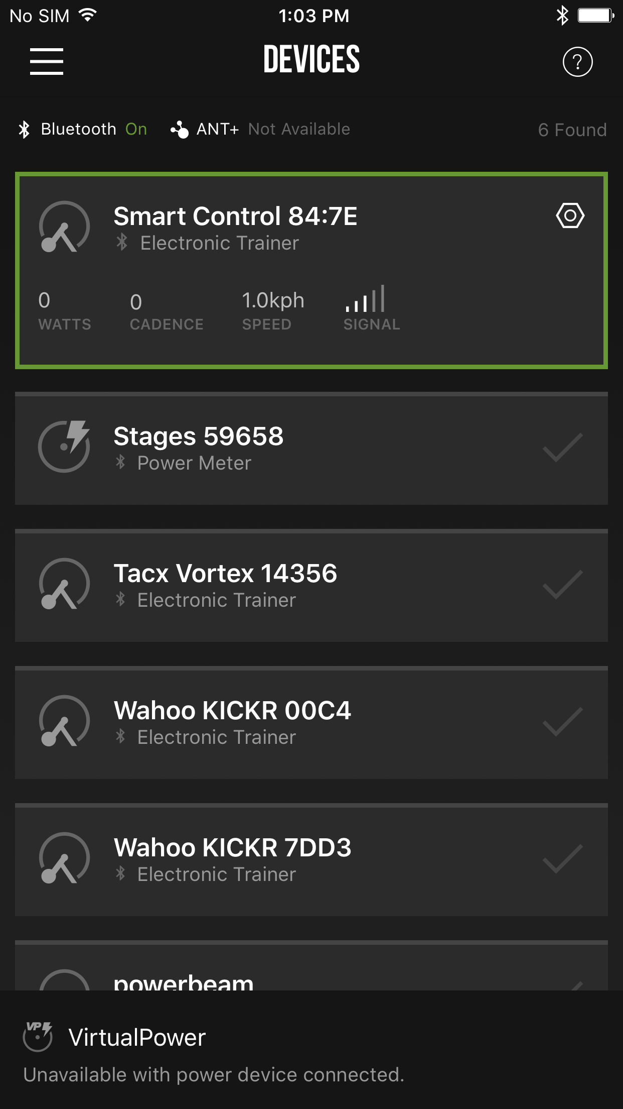

1. Open the TrainerRoad app and go to the Devices screen.
Make sure your phone's Bluetooth is enabled and your Smart Control is plugged in and awake. Currently, the Smart Control can only be paired to iOS via Bluetooth 4.0.
Note: ANT+ support is not available for the Smart Control.
2. Tap the Smart Control option to initiate the pairing process.
Once paired, the grey square will be bordered in green.

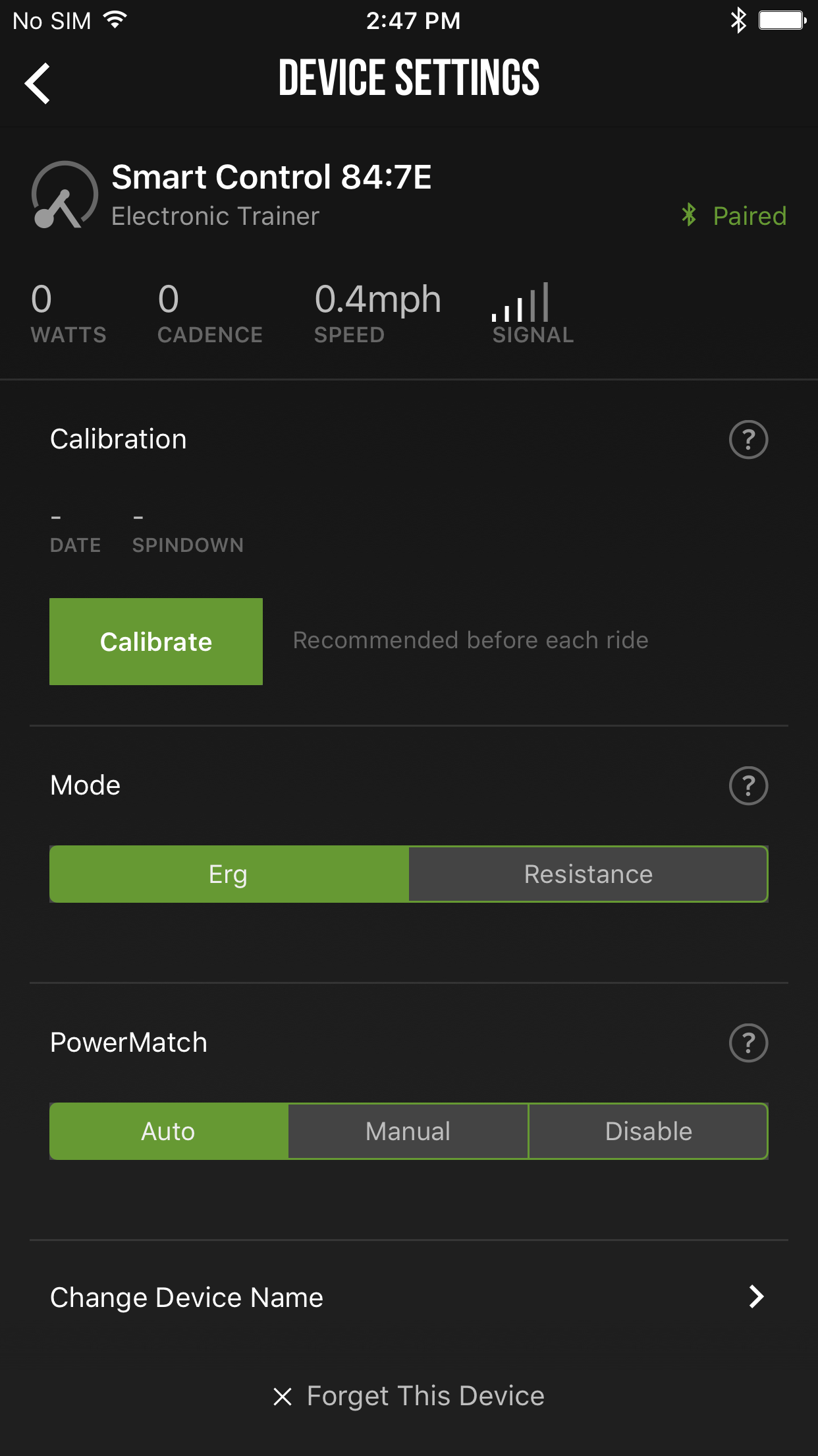

3. Tap the Smart Control once more to open the Device Settings screen.
From here, you can perform a spindown calibration, rename the device, select the trainer mode, and specify PowerMatch options.

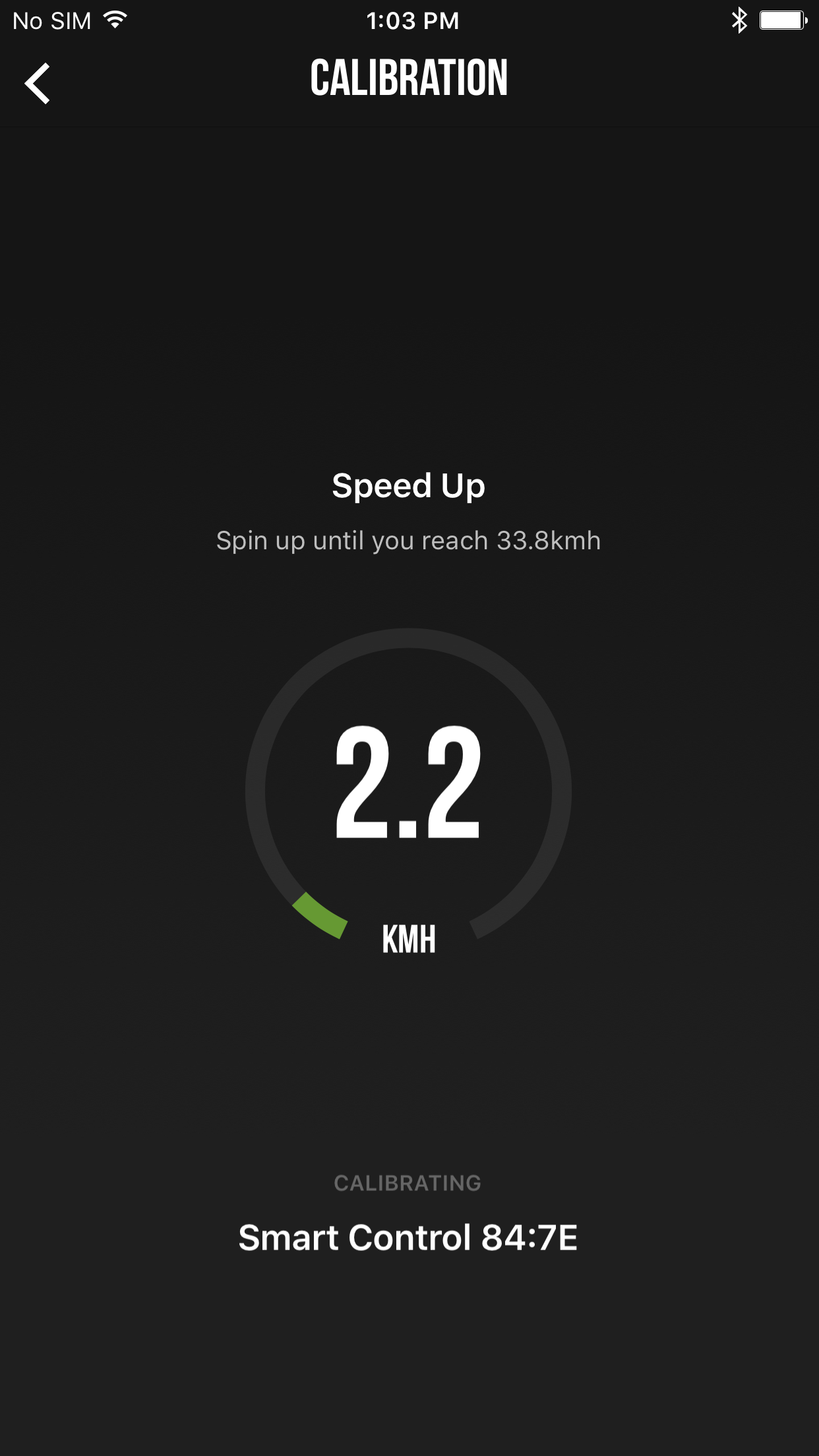

4. Perform a Spindown Calibration. Tap "Calibration" in the Device Settings screen. Now you're ready to ride!

What do I do if the Spindown Calibration fails?
When performing the spindown calibration, try bringing your speed up past the target speed by a few kph/mph. If you're struggling to bring your speed up, you can shift into a bigger gear.
