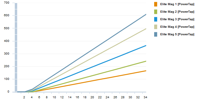

Magnetic Trainers:
These trainers use a magnetic flywheel that creates resistance for the rear tire. These trainers have multiple resistance levels that you can usually change by using a tethered hand brake. They have linear power curves, which means that the same amount of resistance is applied regardless of how fast you're pedaling.
Compatible power curves we commonly recommend are:
  • Elite Mag (5 resistance levels)
  • Tacx i-magic (7 resistance levels)
  • Kurt Kinetic Mag (9 resistance levels)

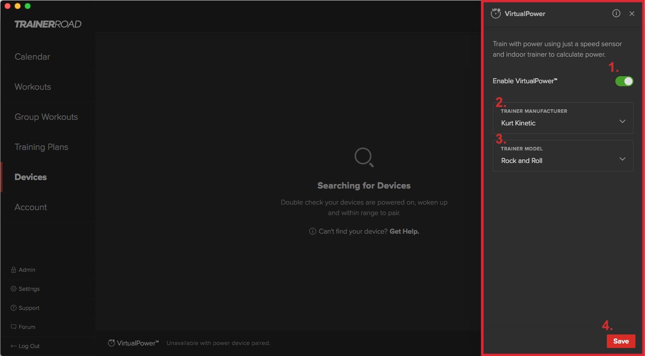

How to set up VirtualPower (Desktop)

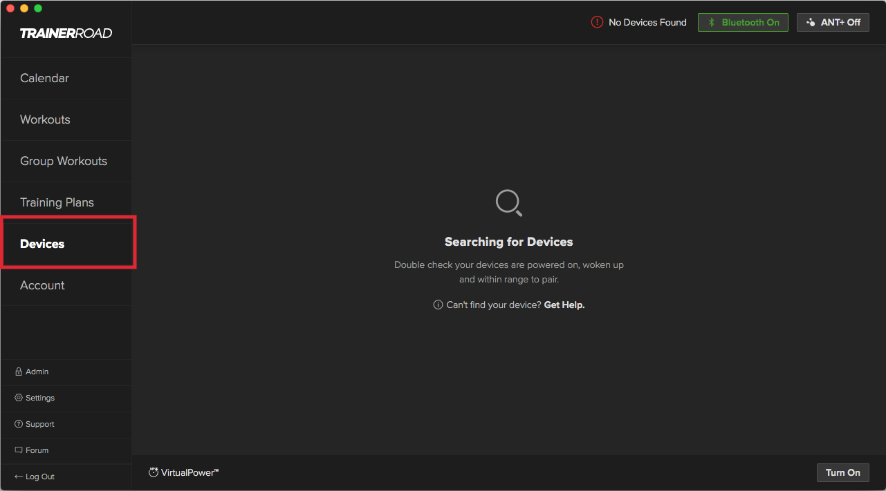

Step 1: Open the TrainerRoad app, and go to the Devices section.

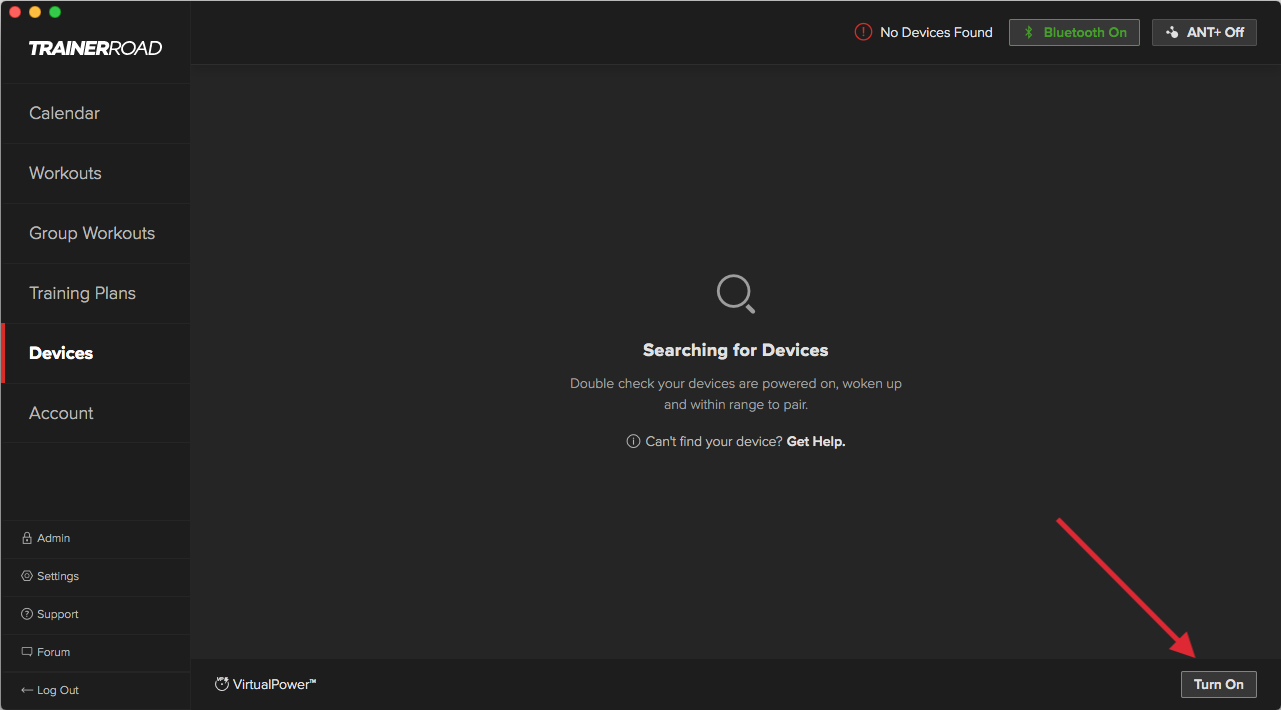

Step 2: Select Turn On in the VirtualPower section at the bottom of the window.
Step 3: Enable VirtualPower, select your trainer manufacturer/model, and select Save.
Note: Make sure your trainer's resistance setting is set to the same level as your VirtualPower selection. If you change the setting, you'll need to change the selection in TrainerRoad.

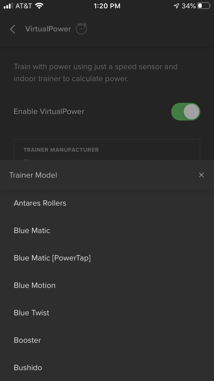

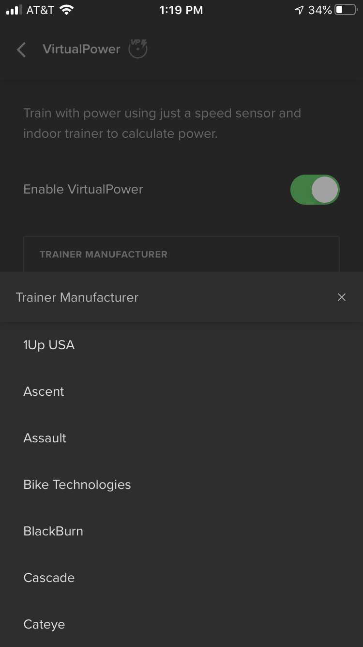

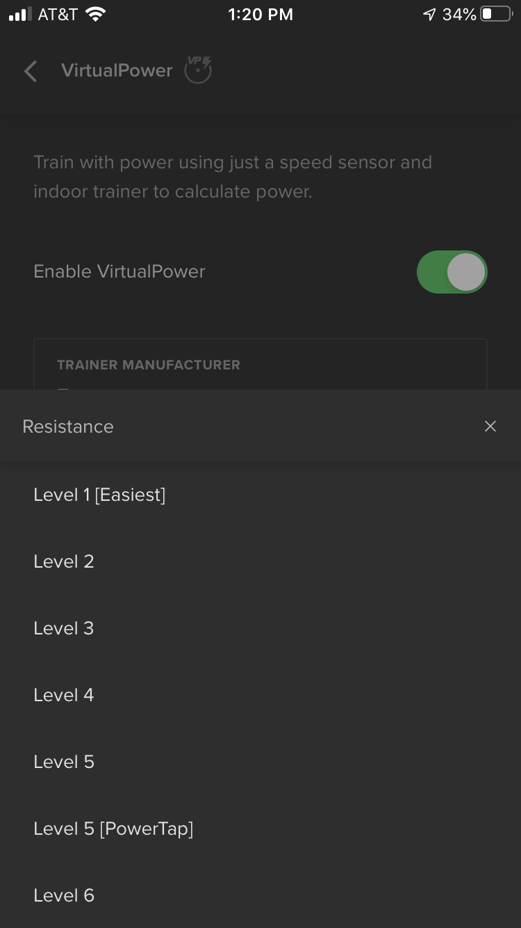

How to set up VirtualPower (Mobile)

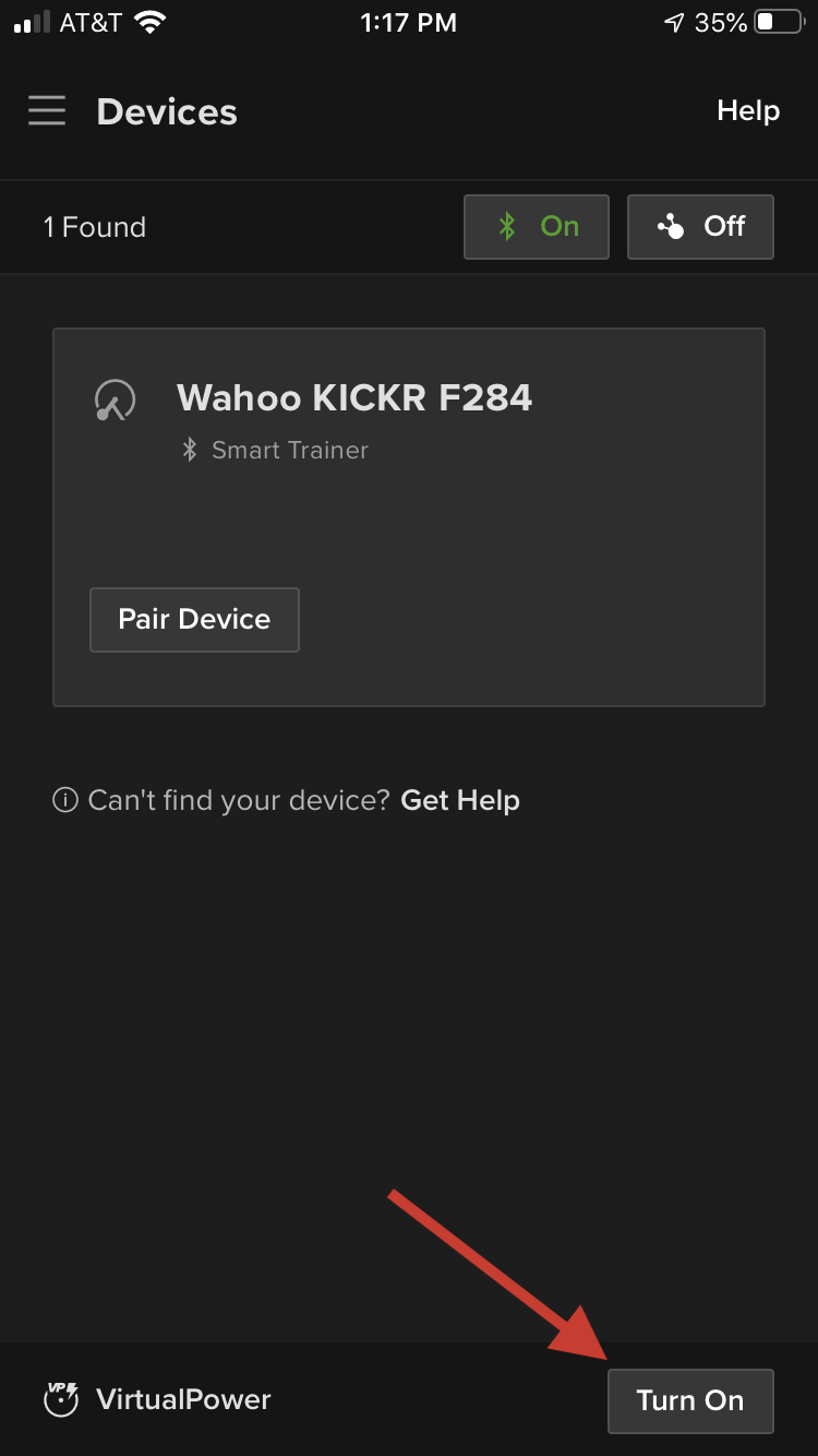

Step 1: Enter the Devices section of the app, and tap Turn On next to VirtualPower.
Step 2: Select your trainer's manufacturer
Step 3: Tap on 'Model' and find your trainer from the list.
Step 5: Select the correct resistance level (if applicable)
