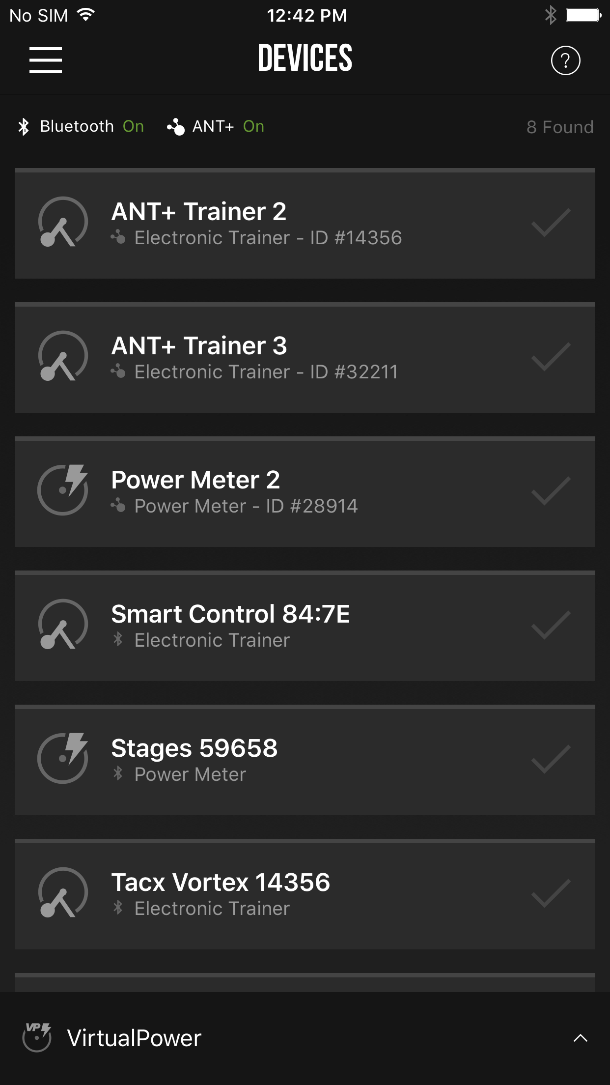

1. Navigate to the Devices tab and make sure ANT+ is turned on.

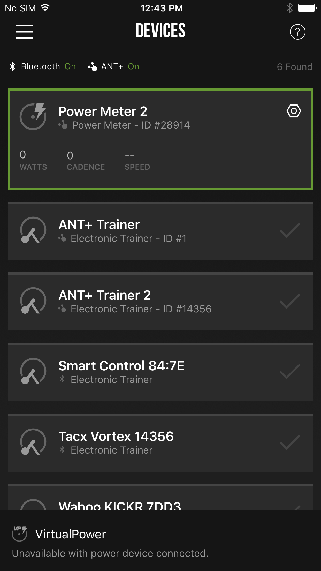

2. Wake up the SRM by pedalling. After tapping on the Power Meter, note the green border showing it as 'paired'.

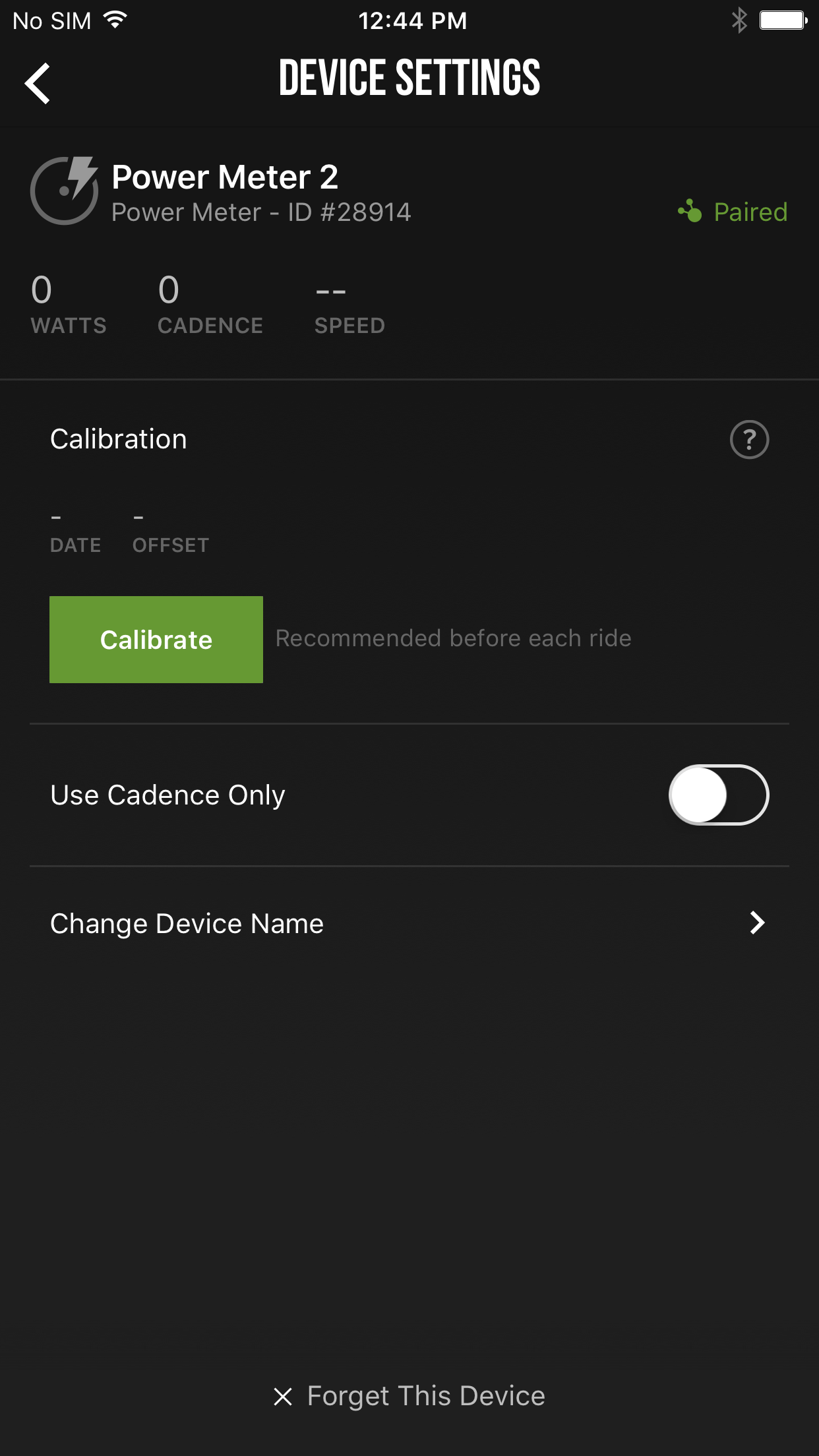

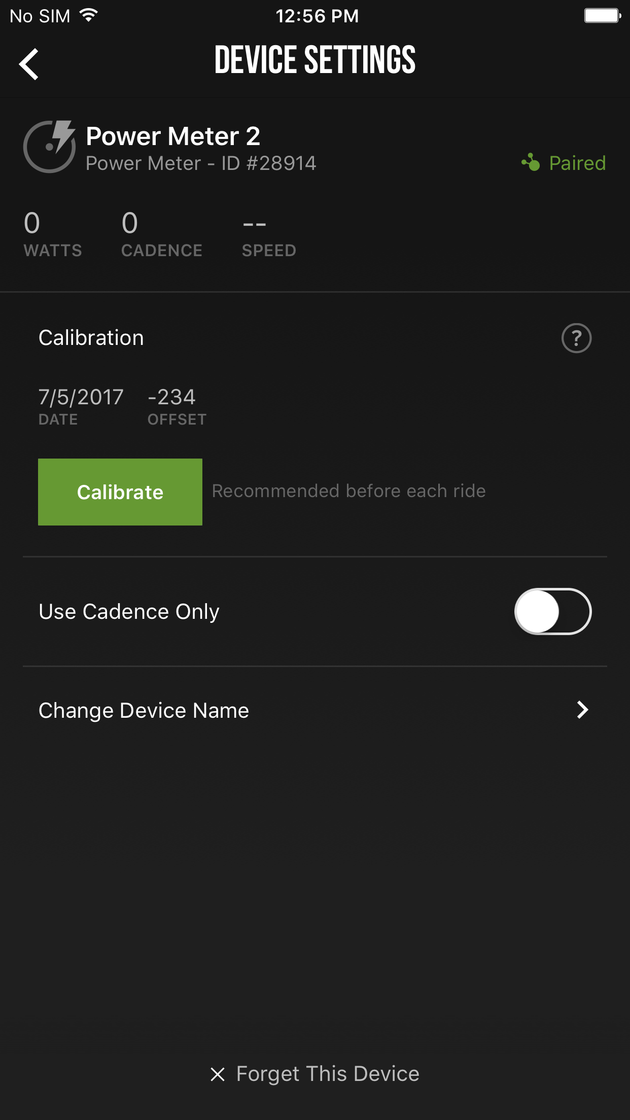

3. Tap on it once more to open the Device Settings screen.
4. Tap calibrate with the crank arms vertical at 12:00 and 6:00.

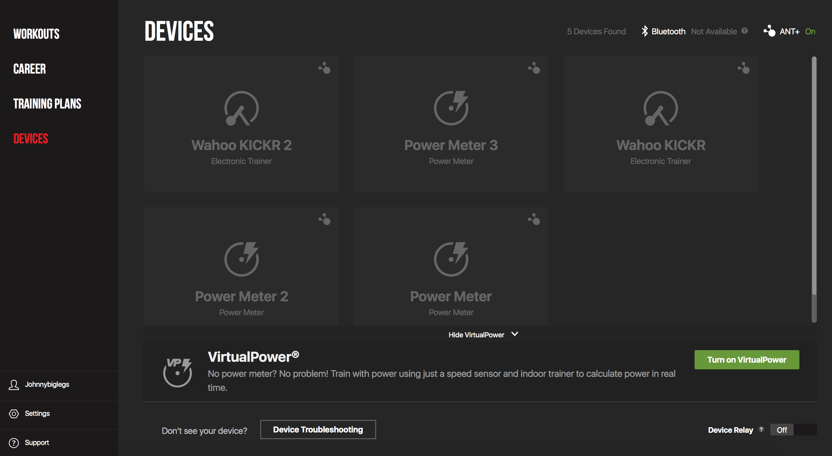

1. Open the TrainerRoad app and go to the Devices tab
You will see this screen:

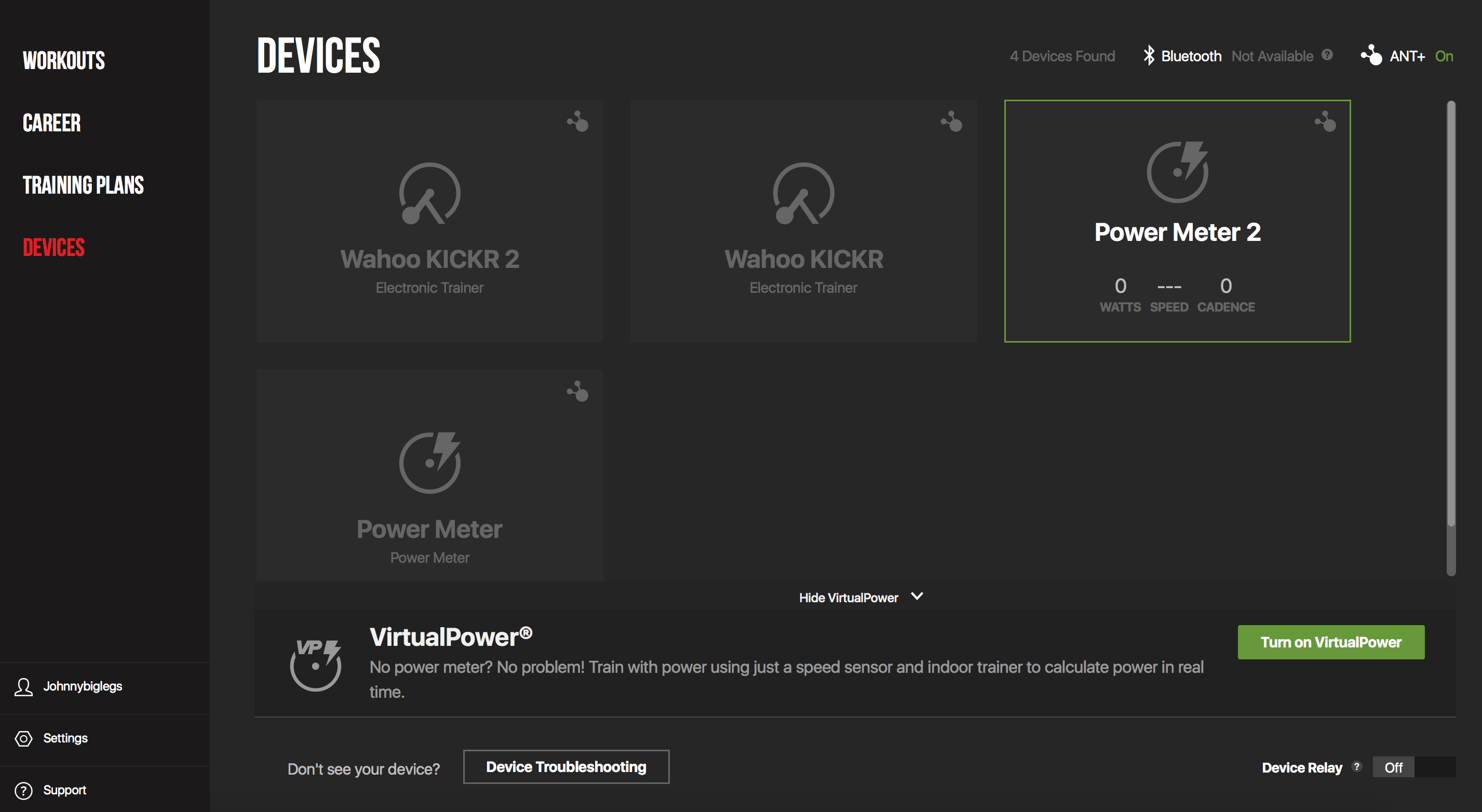

2. Hover over your Power Meter and click to begin pairing. Once pairing is complete, the PM will be bordered in green.

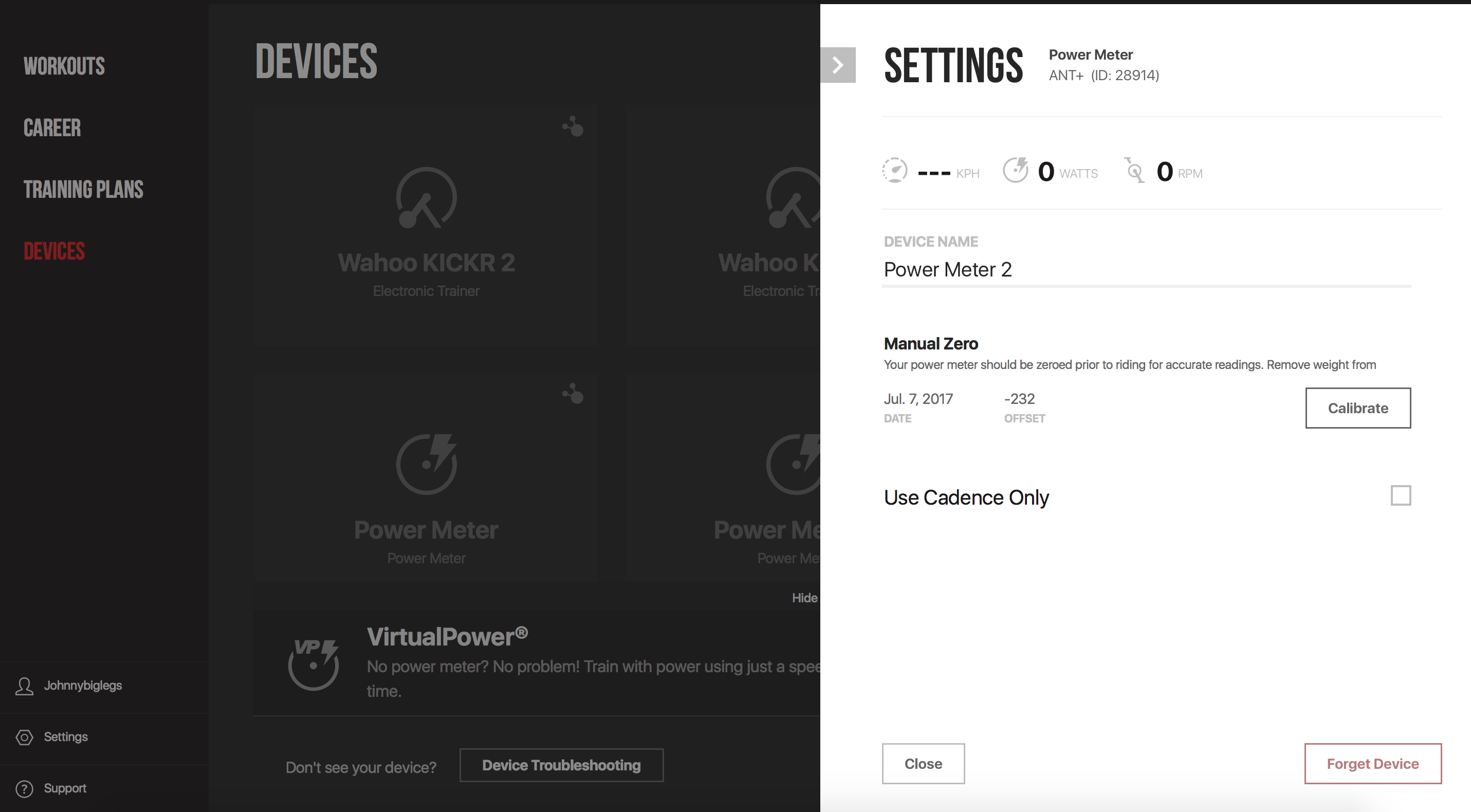

3. Once pairing, you can click on the PM again to open the Device Settings menu. From here you can calibrate the PM.
