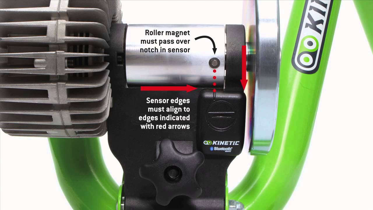

If you're having problems pairing the inRide, it may not be working correctly. To reset the inRide, remove the battery and put it in backward for at least three seconds. After this is done, put the battery back in the normal way, attach it to the trainer with the indentation on the sensor lined up with the magnet on the trainer roller, and try to pair it with TrainerRoad.

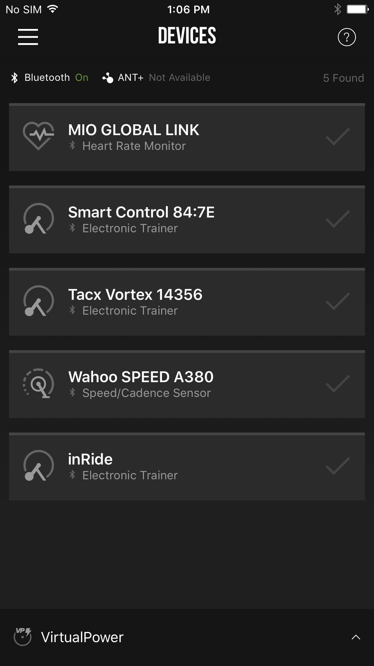

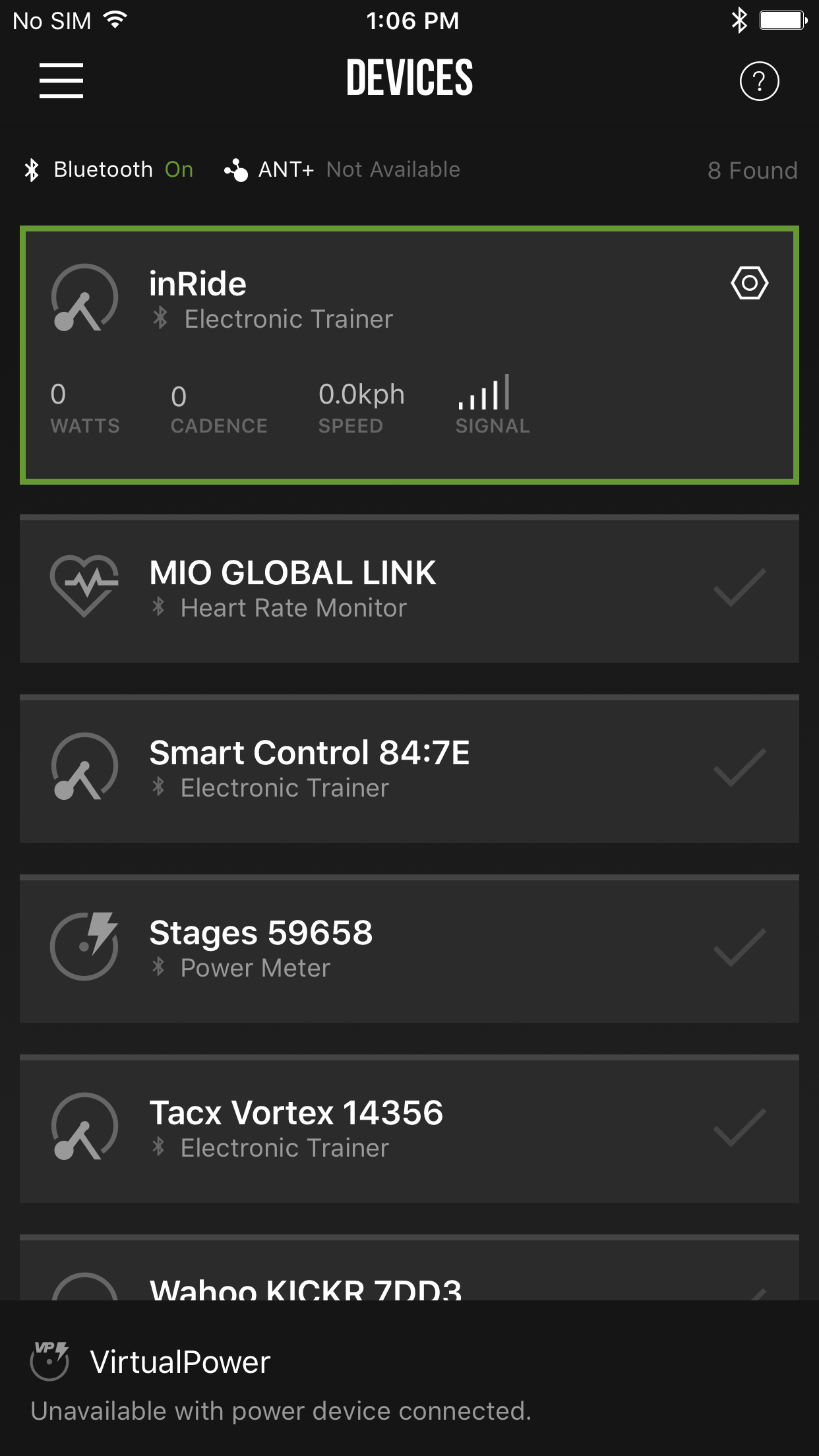

How to Pair Your inRide with TrainerRoad (Mobile)
Step 1: Navigate to the Devices section of the app. Ensure Bluetooth or ANT+ displays as "On".
Step 2: Tap on the inRide to initiate pairing. Once the device is bordered in green, it is paired.

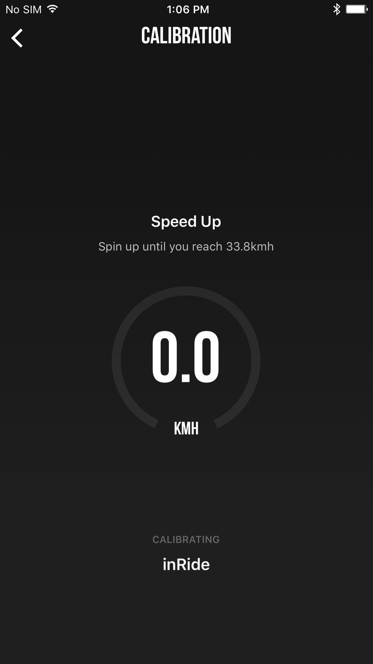

4. Hit "Calibrate" to perform a Spindown Calibration. Once the calibration is complete, you're ready to ride!
Note: Kinetic recommends warming the trainer up for 10 minutes before completing the calibration.

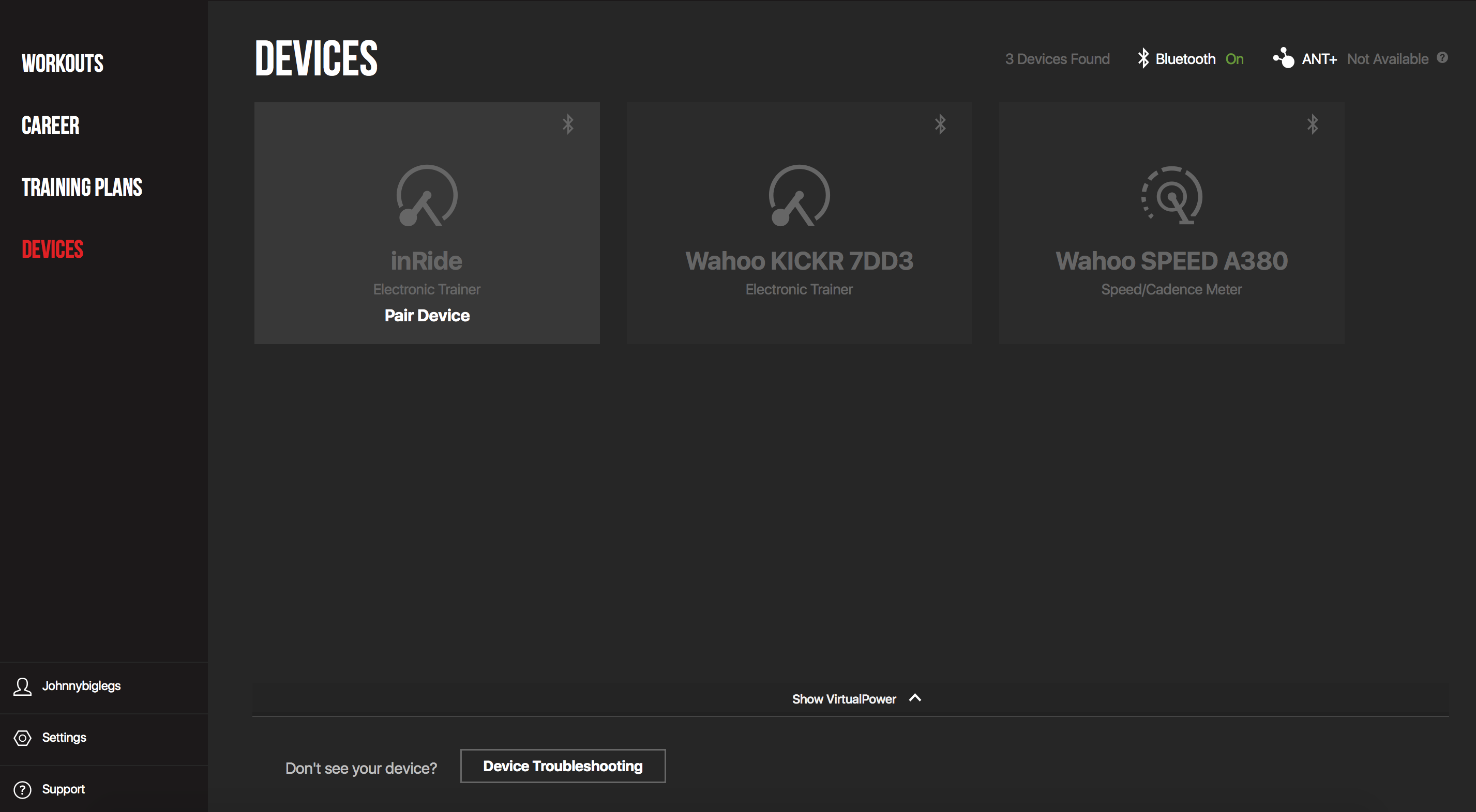

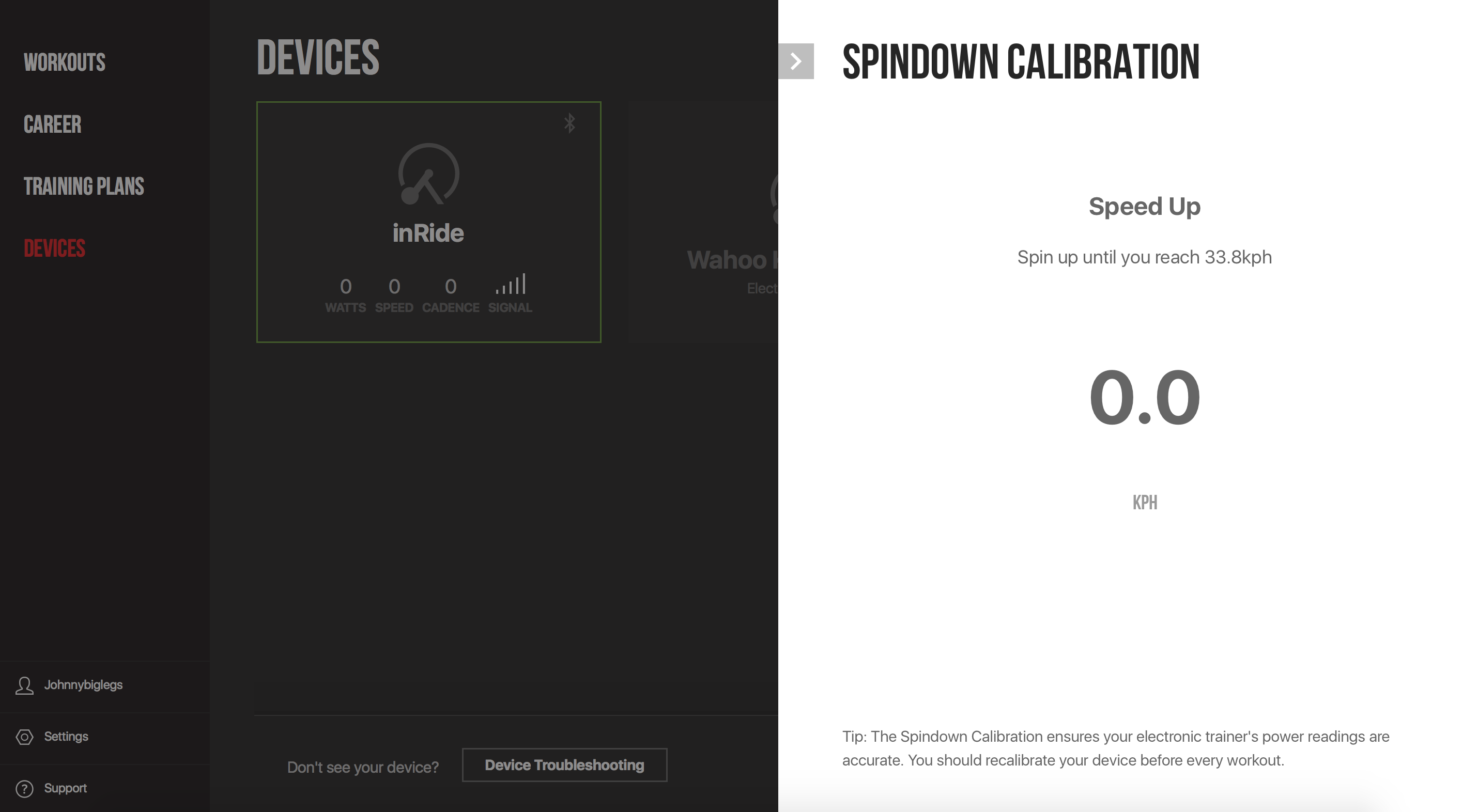

How to Pair Your inRide with TrainerRoad (Desktop)

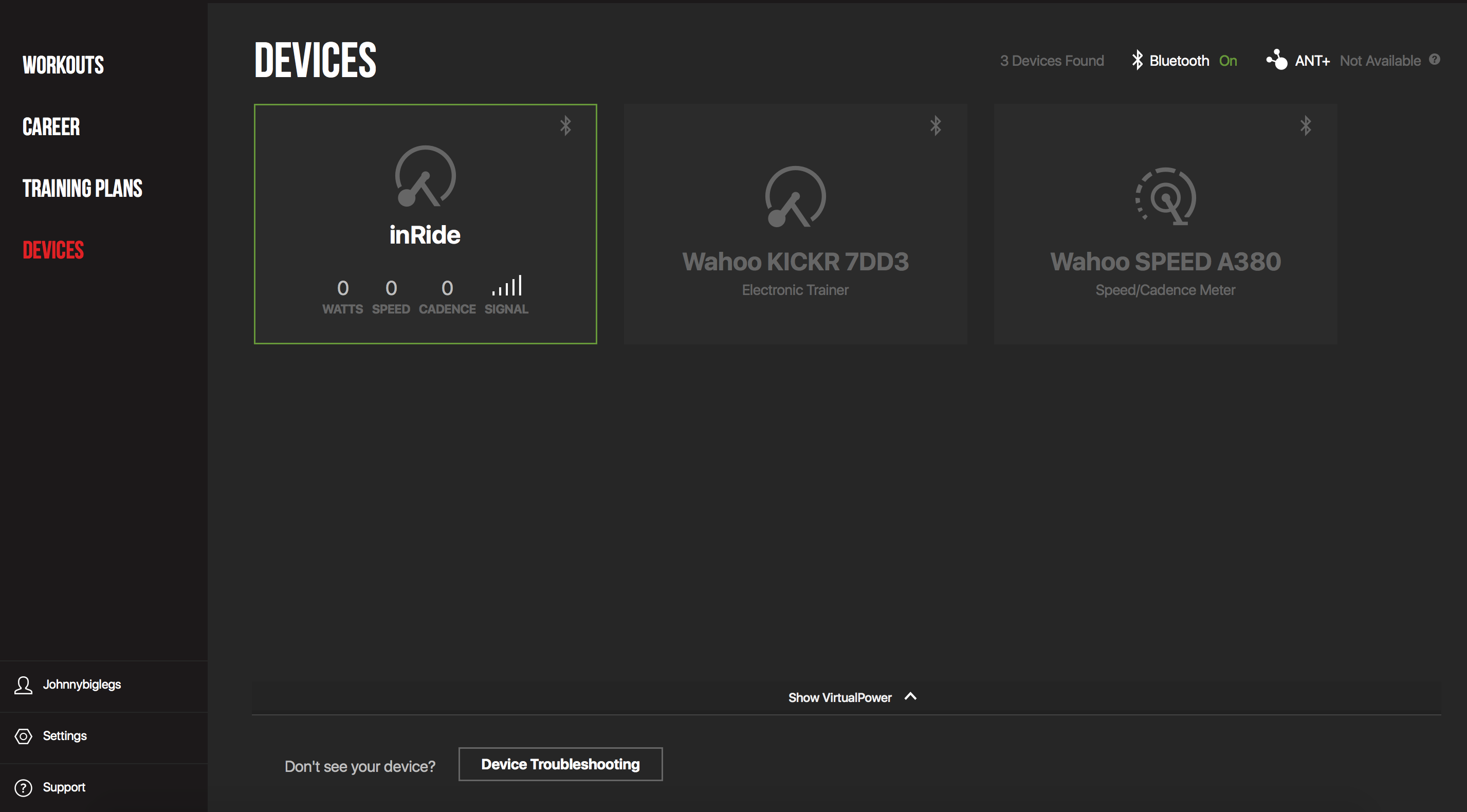

Step 2: Hover over and click on the inRide tile to begin pairing. Once the device is bordered in green, it has successfully paired.

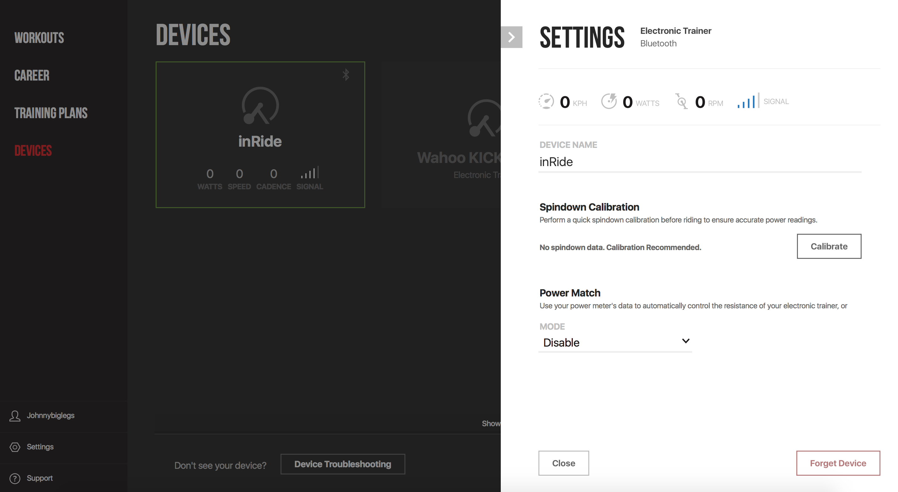

Step 3: Click the inRide one more time to open the Device Settings menu. From here you can calibrate the device.
Step 4: Once calibrated, you are ready to ride!
