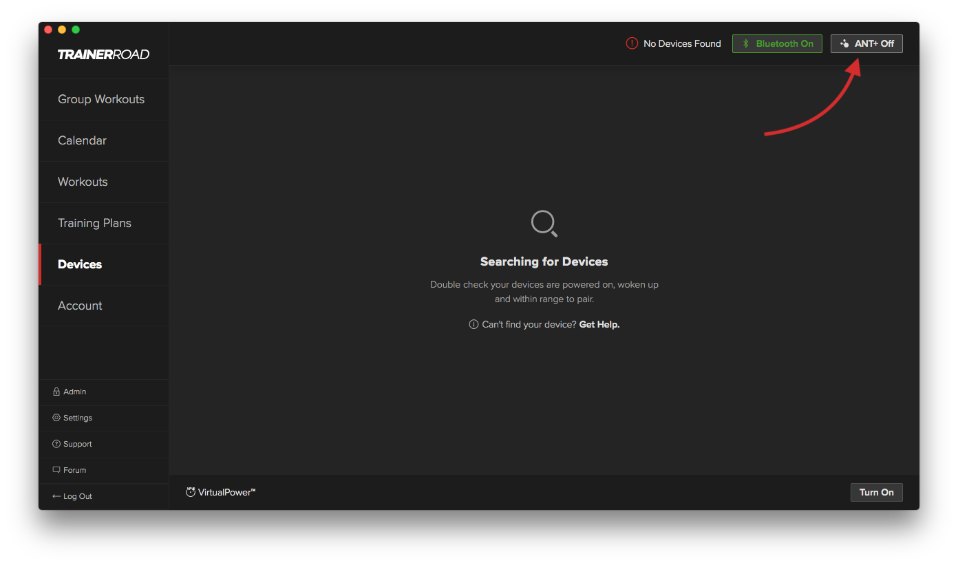

This is what you will see if the ANT+ USB stick is not plugged into your computer's USB port or is not recognized. If the ANT+ stick is plugged in and still not recognized, there may be something wrong with the stick or your computer's USB port.

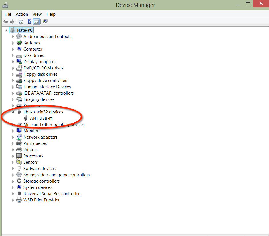

To check if the drivers are installed, go to "start" and type "Device manager". Load the program called device manager. The device might be displayed in two different locations.
libusb-win32-devices
Universal Serial Bus controllers

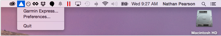

Check for Garmin ANT Agent, or Garmin Express in the system tray. If that program is on, make sure you exit it. See screenshot examples below, or watch this video on How to Disable Garmin ANT Agent.

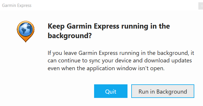

With Garmin Express, you'll need to make sure that it's closed fully, and not running in the background, which it can default to. Check your system taskbar to ensure that it isn't running. If it is still in your taskbar, follow the images below to exit it.
Garmin Express (PC)
Garmin Express (Mac)
Garmin ANT Agent (Mac)
 Make sure to select "Quit" to exit out of Garmin Express entirely.

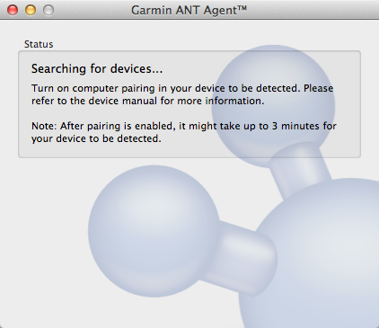

Working: Device is Connected and Active
PC Example
Mac Example

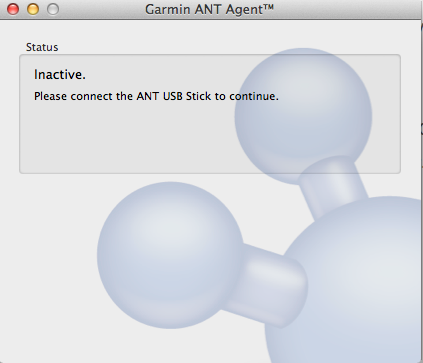

Not Working: Device is Not Connected and Inactive
PC Example
Mac Example
