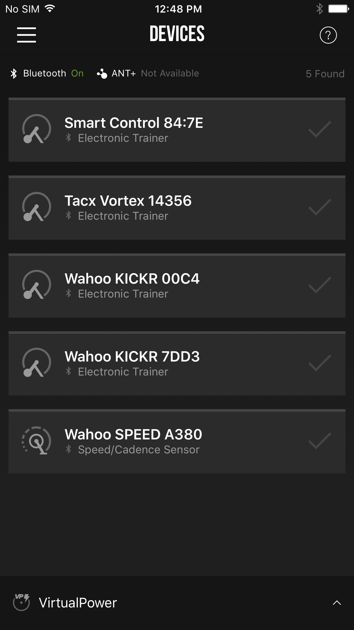

How to Pair Your Speed/Cadence Sensor with TrainerRoad (Mobile)
1. Navigate to the Devices section of the app, make sure you have Bluetooth or ANT+ enabled, and the speed/cadence sensor is awake.

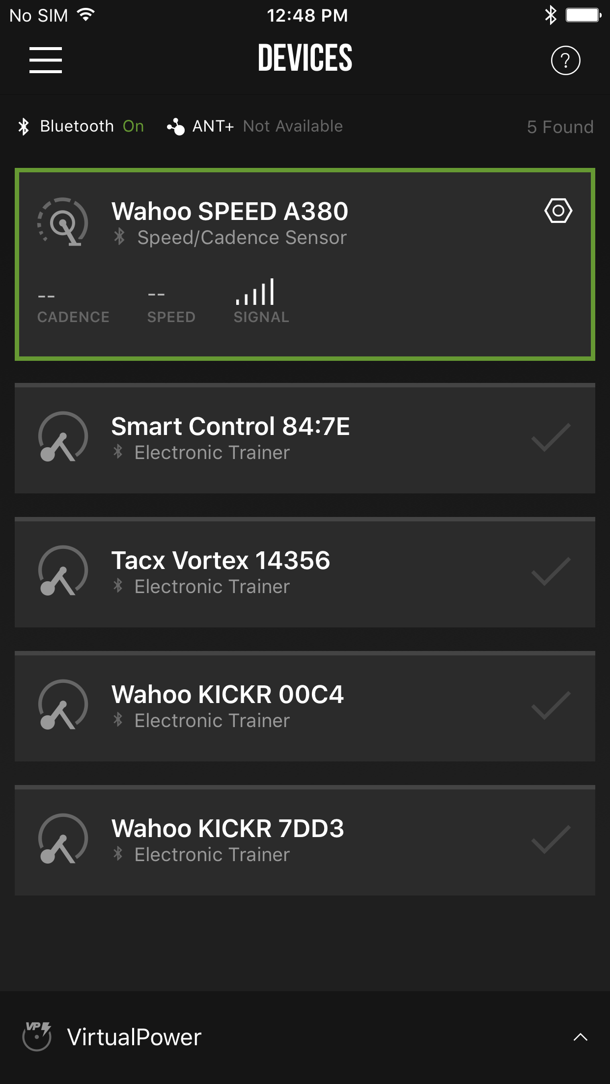

2. Tap on the speed/cadence sensor to begin pairing.
Note: ANT+ users will see the device listed as "Speed/Cadence".

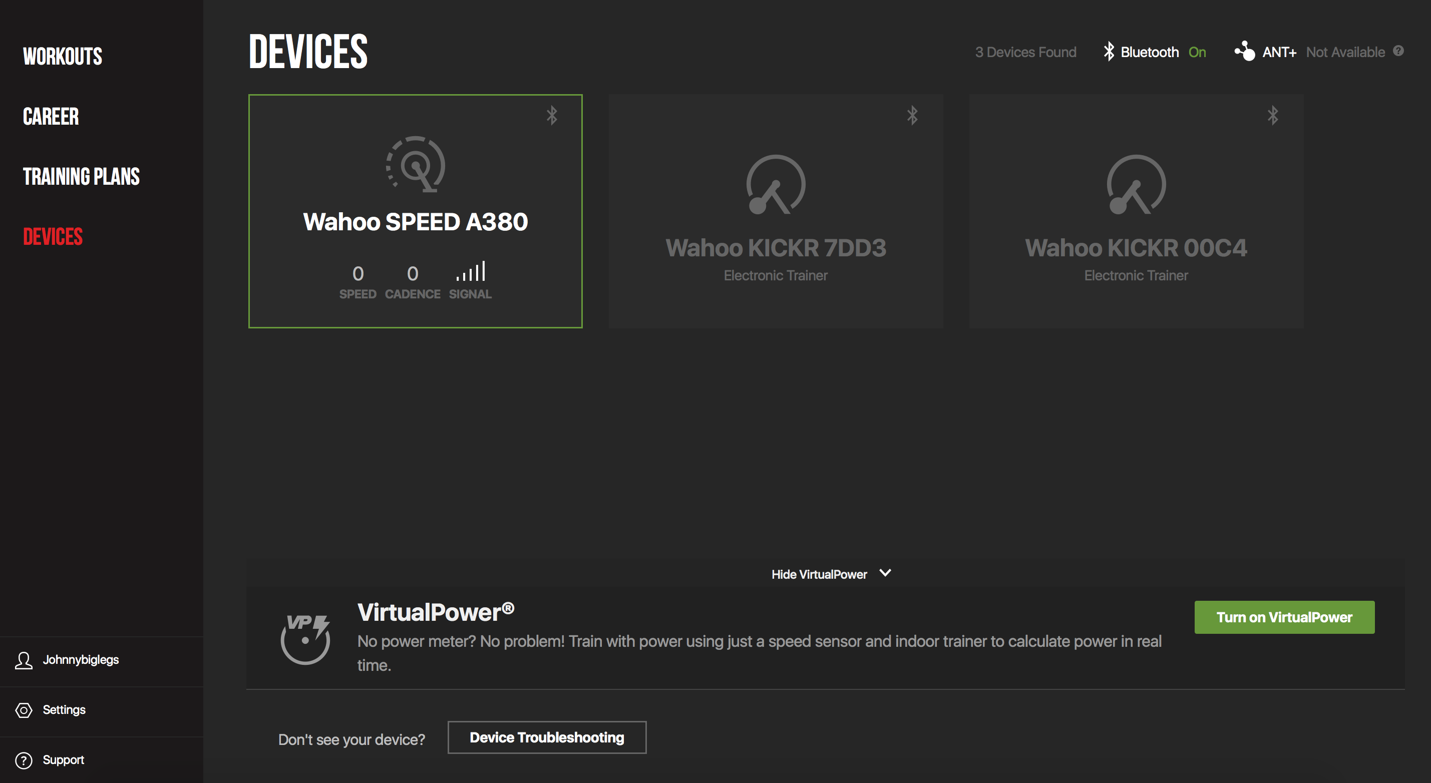

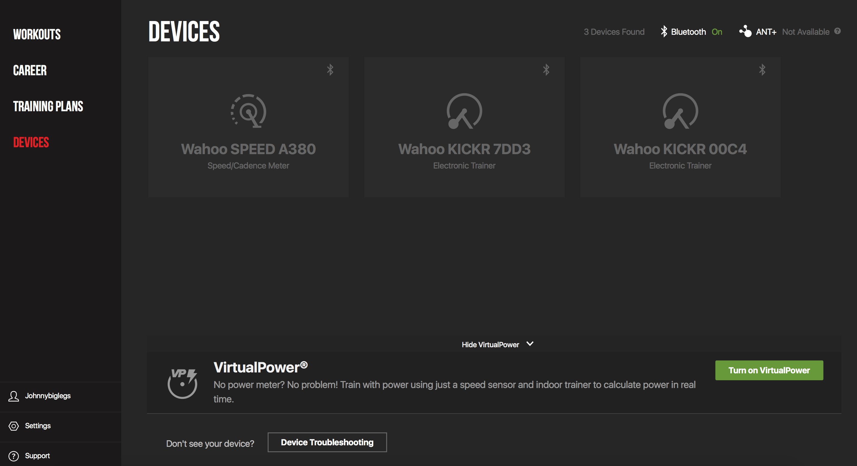

How to Pair Your Speed/Cadence Sensor with TrainerRoad (Desktop)
2. Hover over and click on the Blue to begin pairing. Once the device is bordered in green it has successfully paired.
