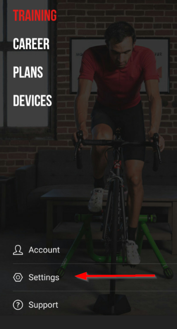

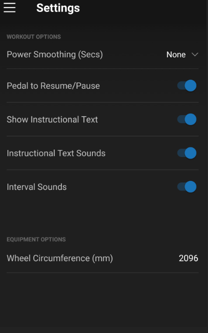

The Muin's Wheel Circumference should be set to 2070mm when using VirtualPower and a speed sensor. You can adjust the Wheel Circumference settings under the Settings tab of your app.
For users with the Elite Misuro B+ Speed/Cadence/Power sensor, follow the Elite instructions regarding wheel circumference. This is (actual wheel circumference in mm/ 13.2). Enter this figure into the above setting.
