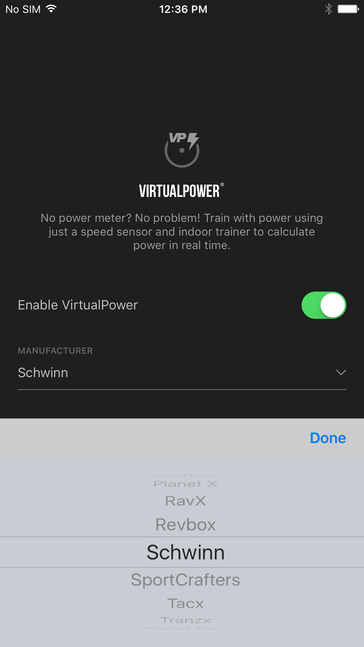

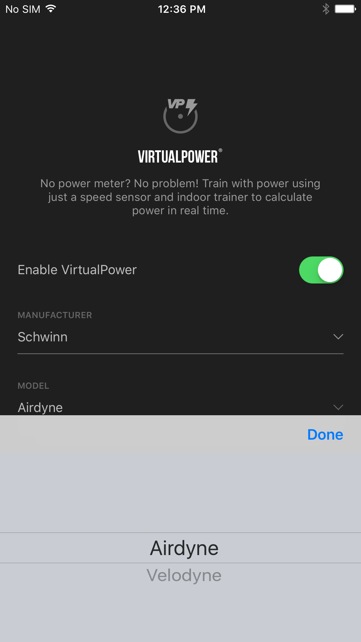

How do I set up the Airdyne with VirtualPower? (Mobile)
- Navigate to the Devices tab
- Enable VirtualPower.
- From there, scroll through the Manufacturer list to Schwinn and the Model list to Airdyne.
- Finally, pair your speed sensor and you're ready to go!
