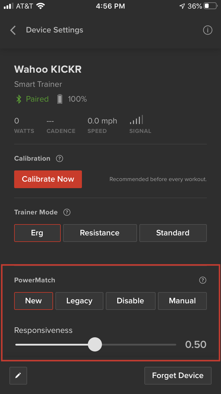

Using PowerMatch with Mobile
TrainerRoad's default PowerMatch setting is to use the power from the power meter to control the smart trainer's resistance. Simply pair the power meter and smart trainer, make sure PowerMatch is set to "New", and TrainerRoad will take care of the rest!
Additionally, the offset between the power meter and smart trainer will be measured, and the trainer adjusted (if necessary), constantly.

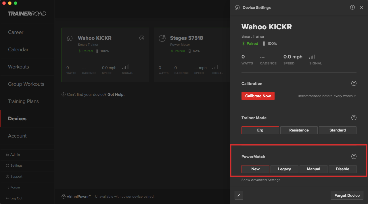

Using PowerMatch with Desktop
TrainerRoad's default PowerMatch setting is to use the power from the power meter to control the smart trainer's resistance. Simply pair the power meter and smart trainer, and TrainerRoad will take care of the rest!
Note that the power meter will display as your power source in your Online Career.
If you wish to disable PowerMatch or apply a consistent offset, you may do so under the Device Settings menu, by clicking on the paired smart trainer.
Sensitivity Setting
Sensitivity is an advanced setting for our newest version of PowerMatch. It is set at 0.5 by default, which proved to be a better experience for most athletes. However, you may find that a different setting works better for your power meter / trainer combination and or personal preferences.
A higher value should translate to quicker update to the trainer / power meter offset. While this may sound desirable, updating too fast can make for jumpy resistance levels. A lower sensitivity will likely result in smoother power, but the resistance adjustments from changes in power offset may take longer.

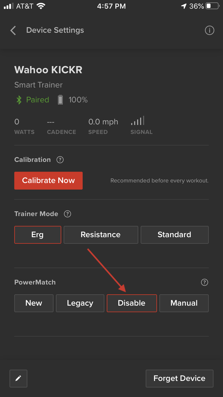

How to Disable PowerMatch
If you wish to disable PowerMatch, you may do so within the pairing screen of your smart trainer.
Disabling PowerMatch will prompt TrainerRoad to display and record power readings from your power meter if both a power meter and smart trainer are paired at the same time.  ERG mode is still available; however, the smart trainer will use its own power data to calculate resistance instead of the data from your power meter. If there is a discrepancy in power readings between the smart trainer and power meter, disabling PowerMatch can make it look like you are constantly above or below the power target.

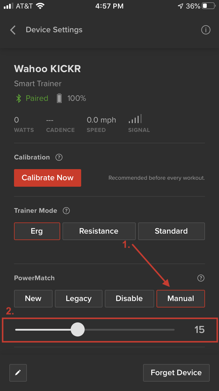

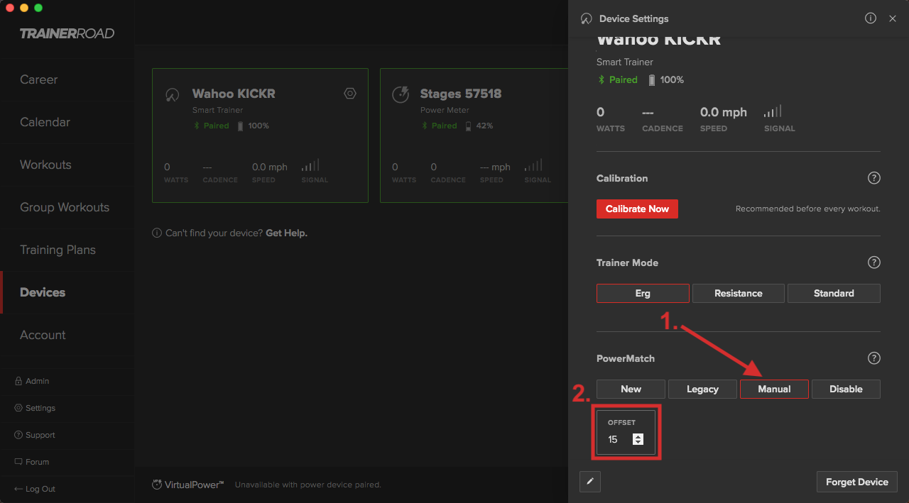

Apply Consistent Offset Between Trainer/Power Meter
If you know the power offset between your trainer and power meter and do not wish for TrainerRoad to continuously measure and adjust this, you can input this offset to be applied to the entire workout. You can do this within the pairing screen of your smart trainer.
Note: The offset calibrates your trainer to your power meter. In other words, the manual offset adjusts your trainer to be at the same output as your power meter.
For example, if your trainer reads 200 watts and your power meter reads 210 watts, you will apply a -10 watt offset.
