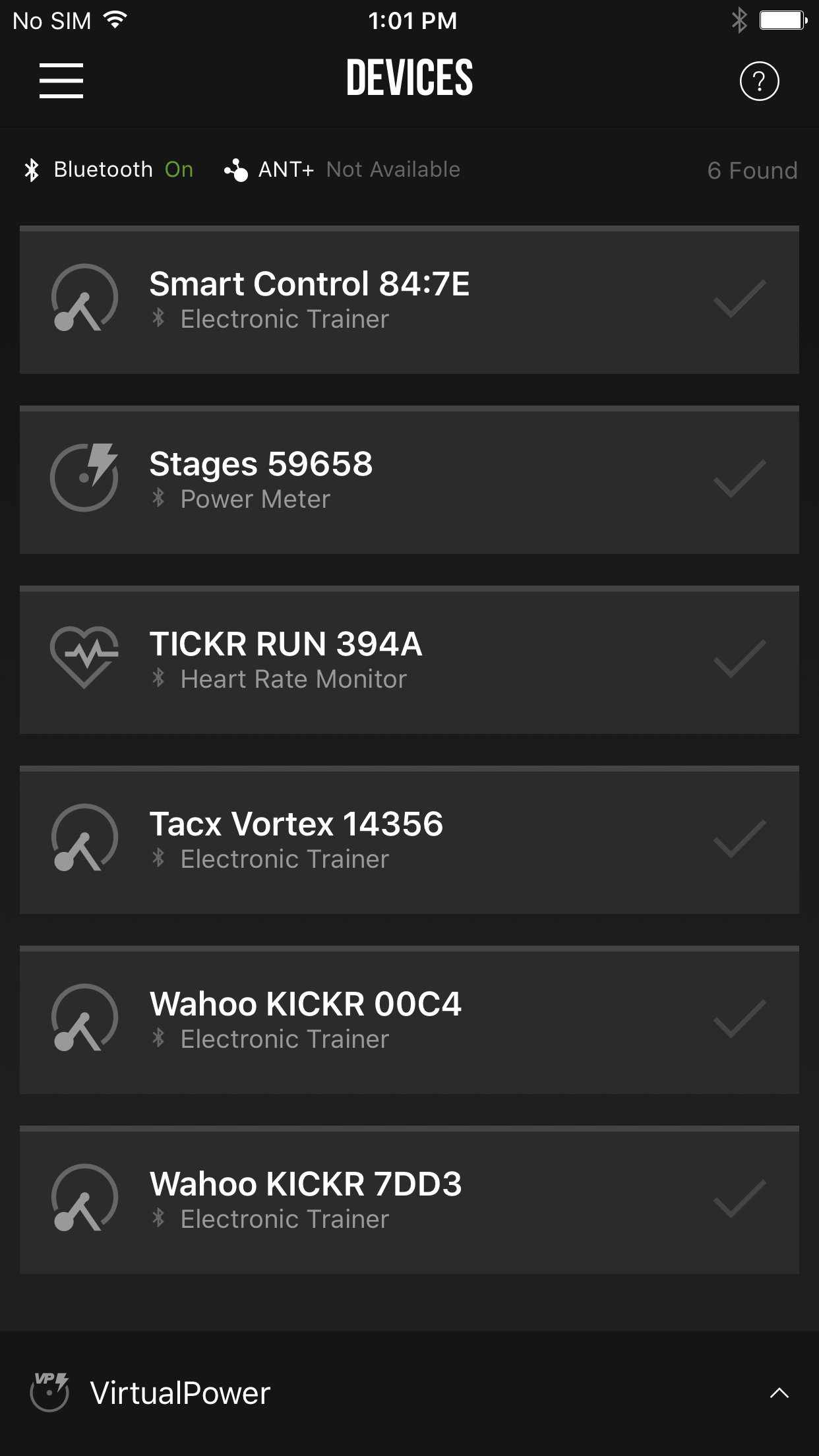

How to Pair Your Stages with TrainerRoad
1. Open the TrainerRoad application and go to the Devices tab.
2. Click the "Pair" button that corresponds with Power Meter, and wait for your Stages to pair with TrainerRoad
"Searching for device" will be displayed until TrainerRoad finds your power meter.

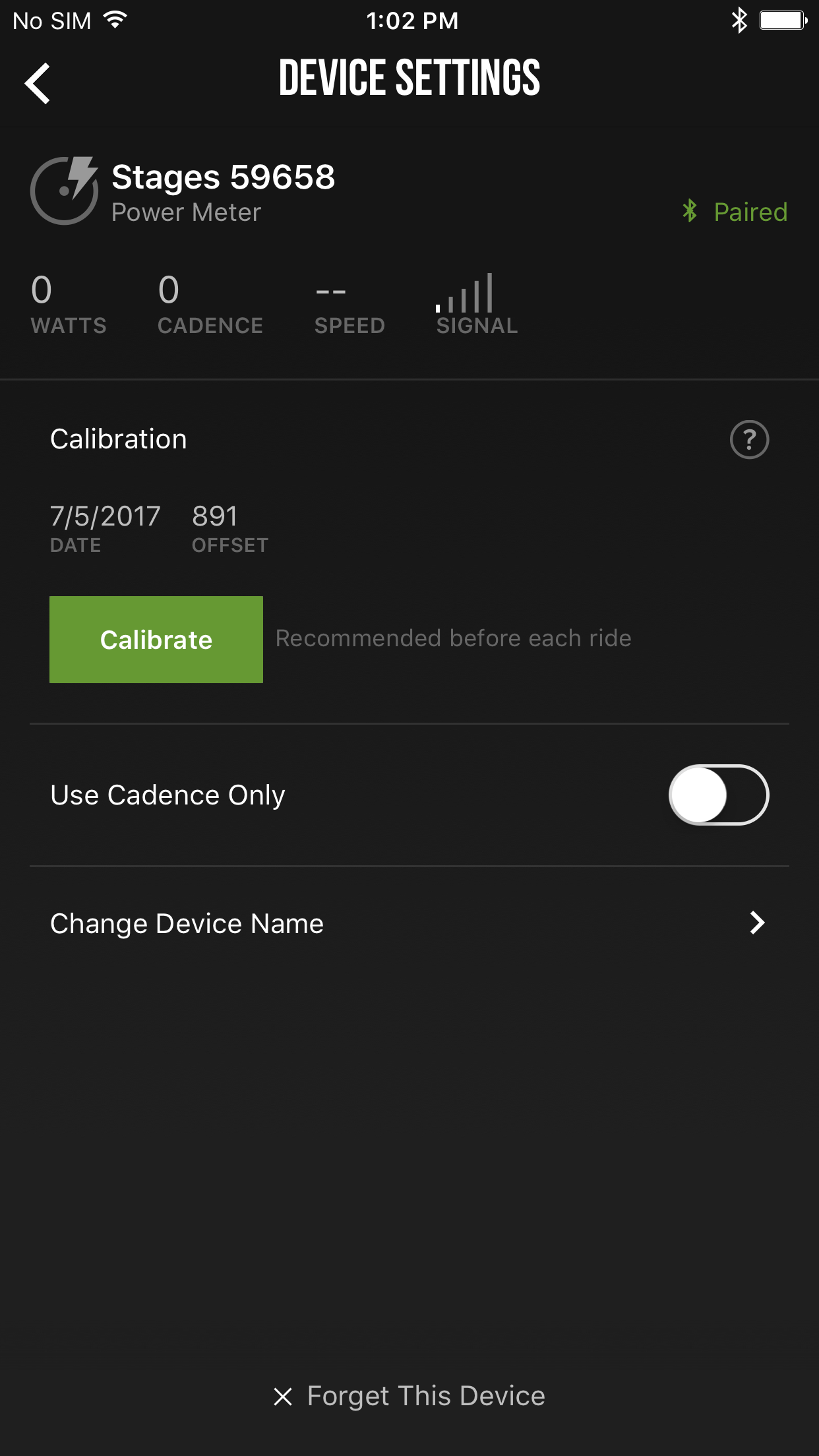

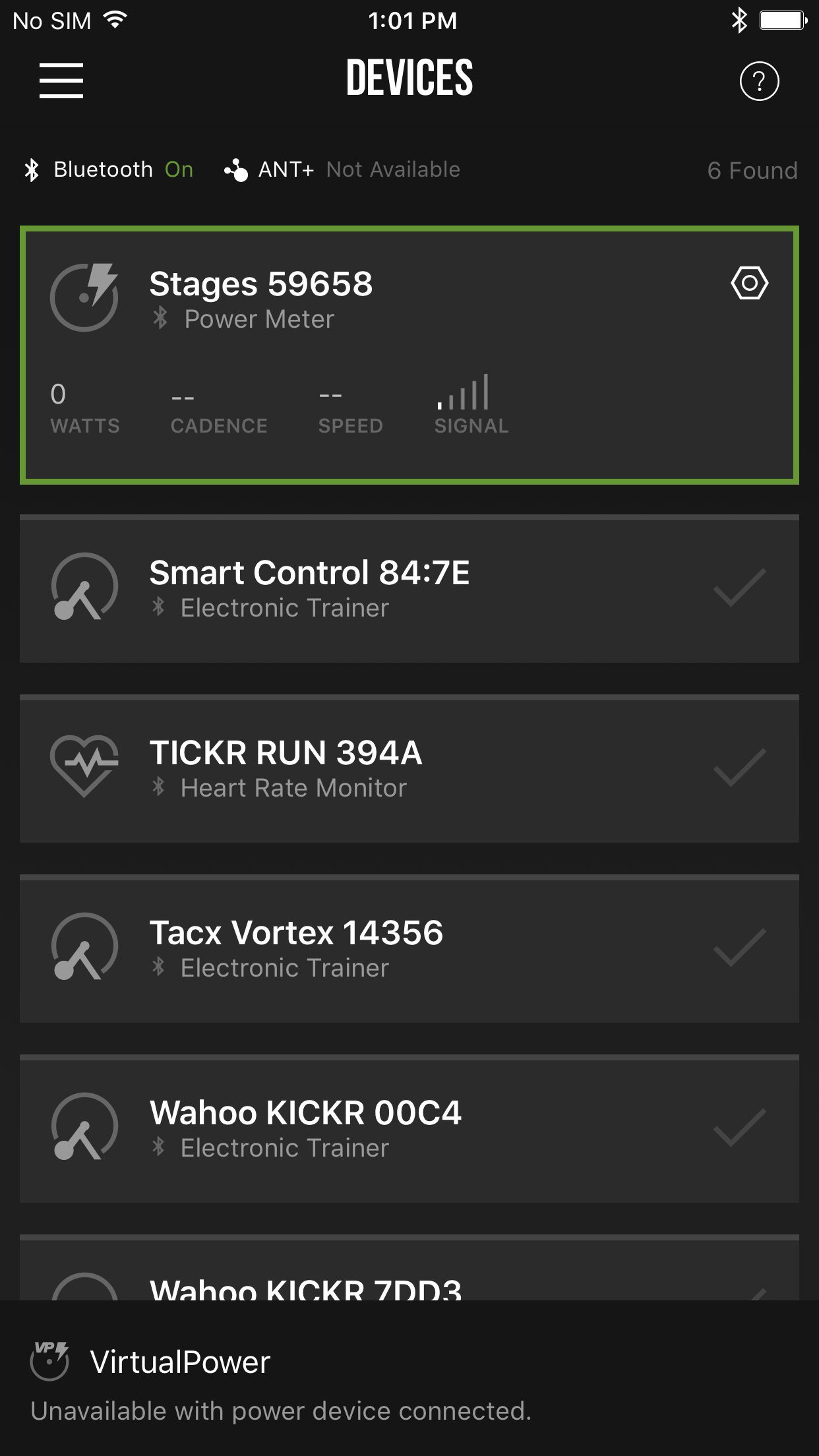

3. Your Stages is Now Paired
The pairing box will turn green once your Stages is paired with TrainerRoad. You'll be able to view power, cadence, the Stages' signal strength, hours since your battery has been replaced, and a button to manually zero your power meter.

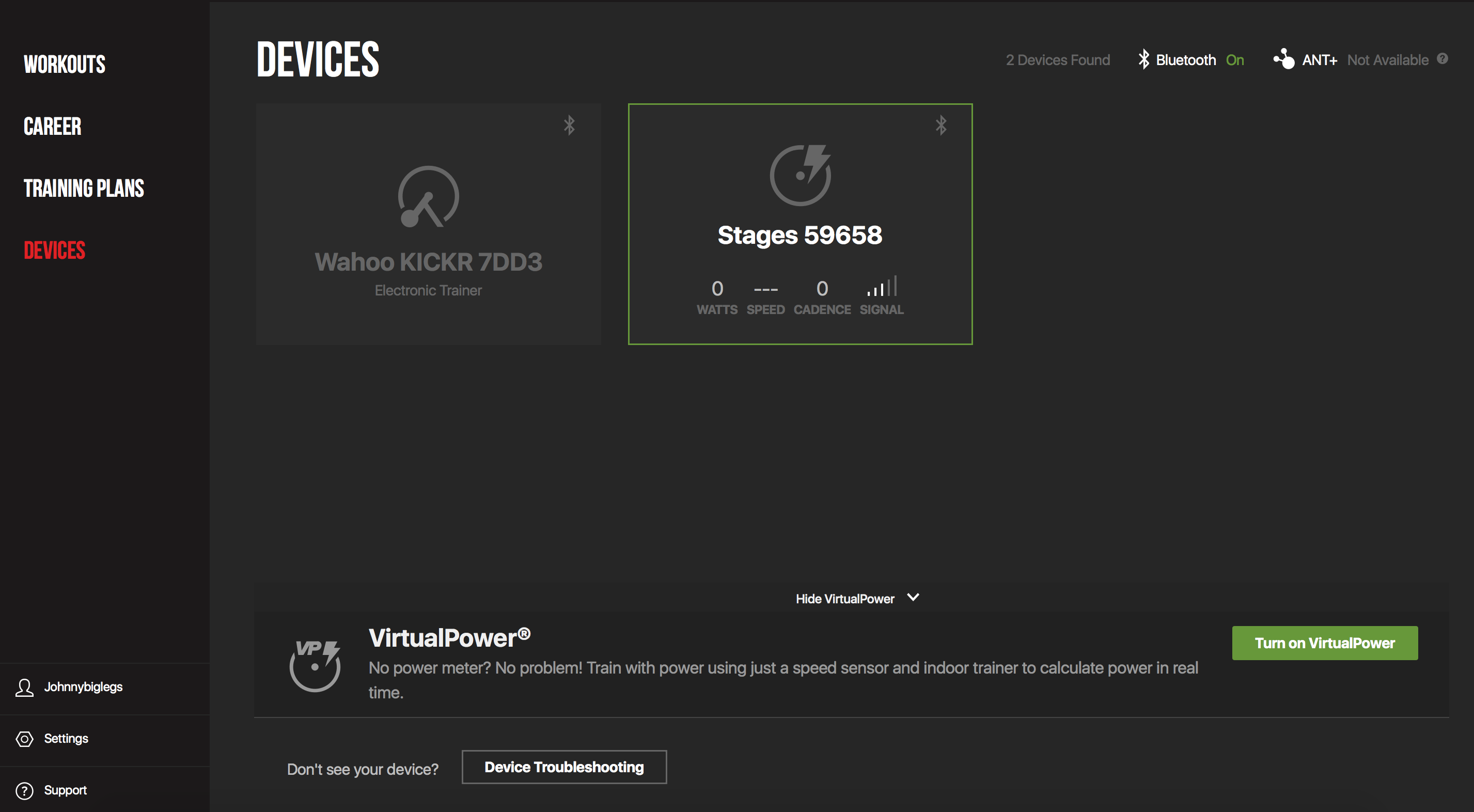

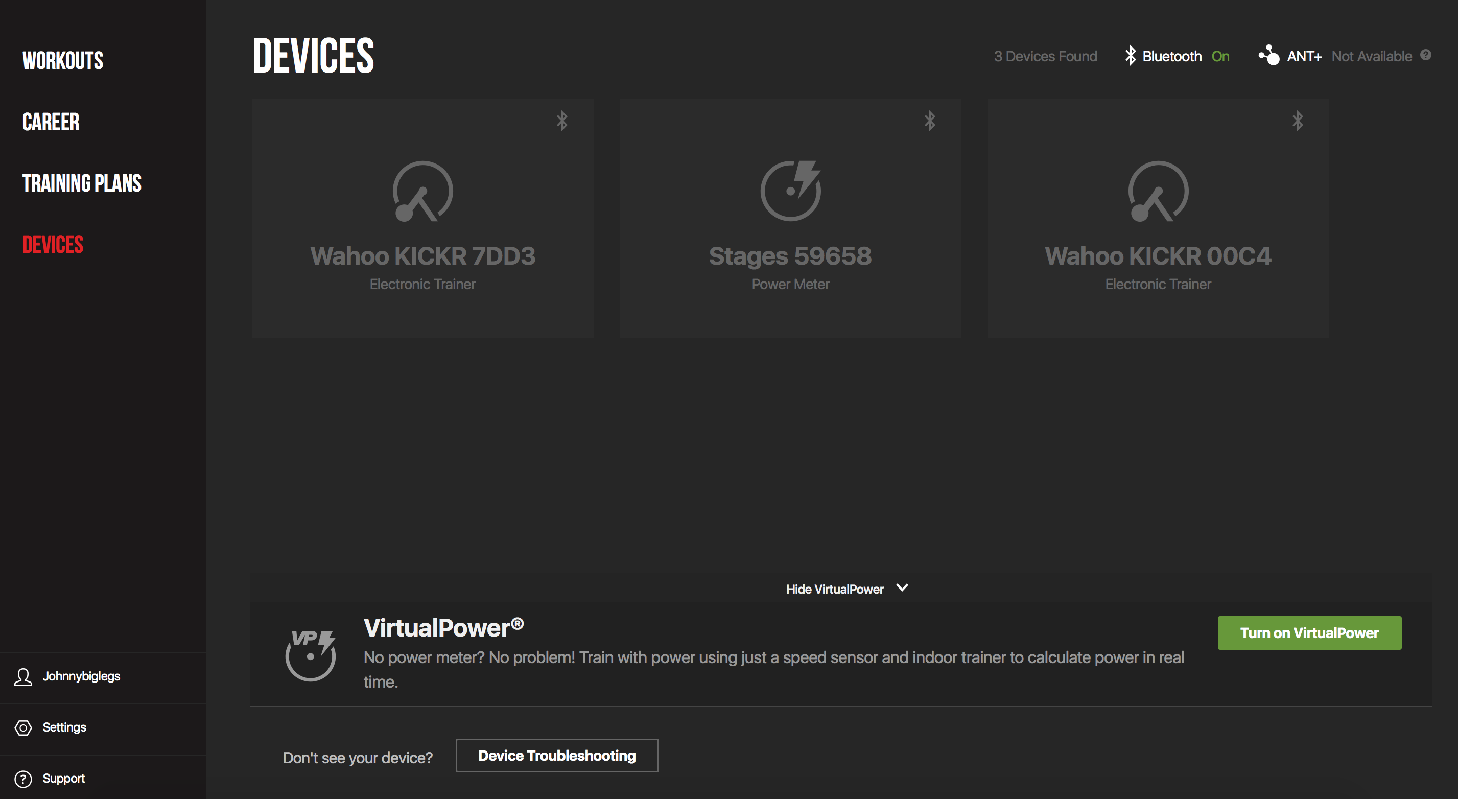

How to Pair Your Stages with TrainerRoad (Desktop)
"Searching for device" will be displayed until TrainerRoad finds your power meter. Once Paired, you'll see the Stages bordered in green.
You'll be able to view power, cadence, the Stages' signal strength and a button to manually zero your power meter.

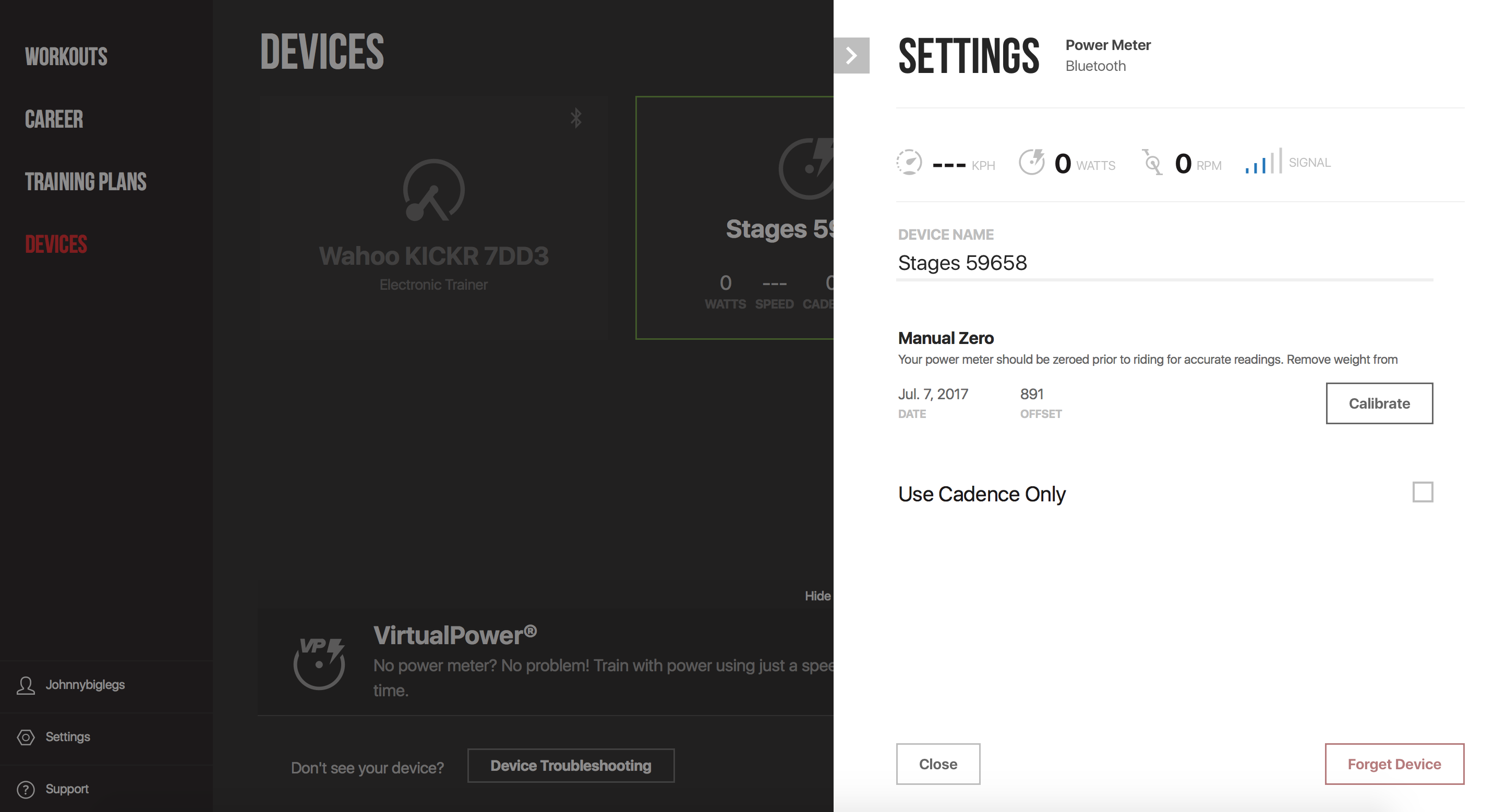

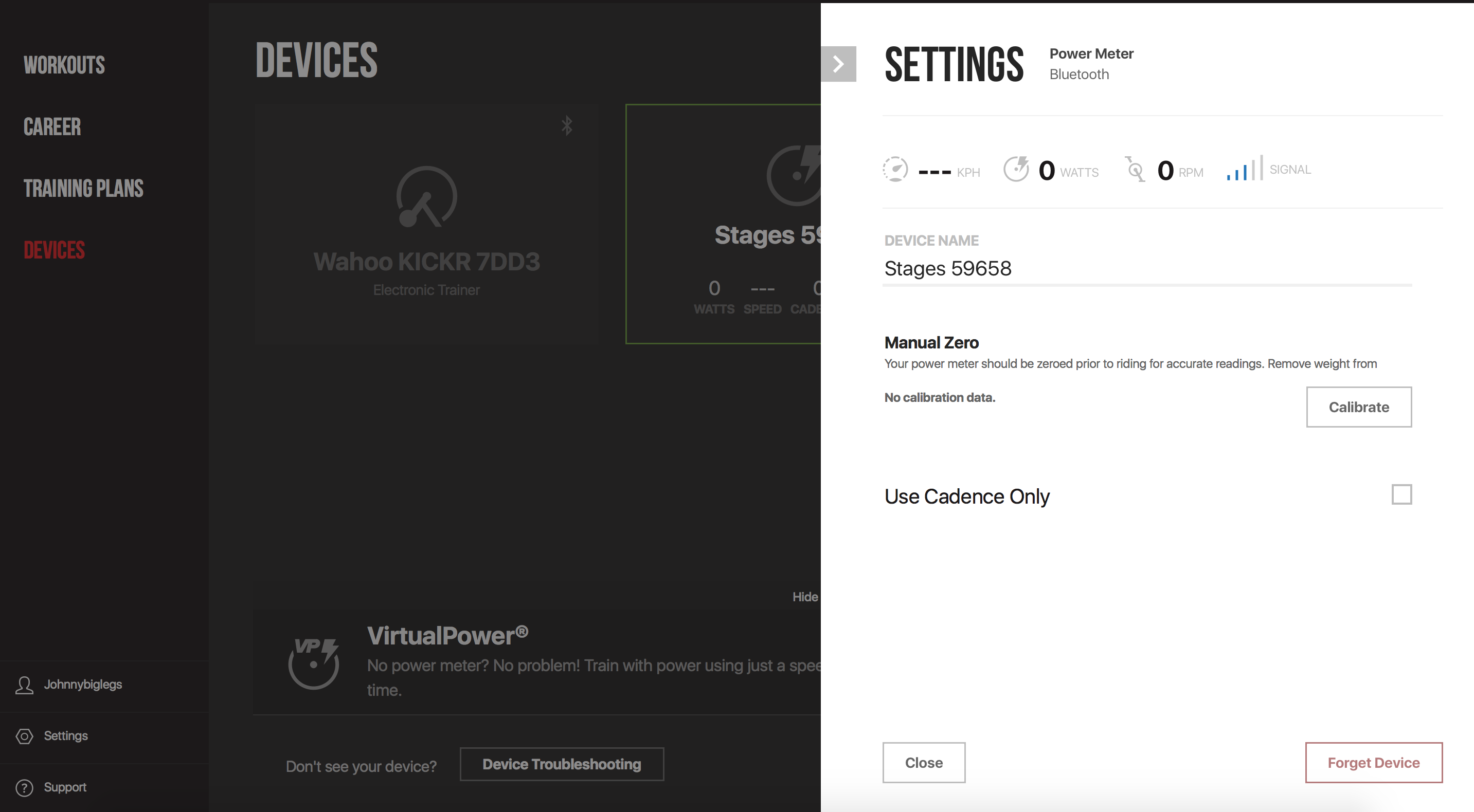

4. Manually Zero Your Stages
Manually zeroing your power meter is akin to zeroing a scale before measuring your weight. Hit the Manual Zero button to complete this process. Although this step isn't required to start a workout, we recommend zeroing your Stages before each ride. Make sure the crank arm is positioned vertically at 6:00 and 12:00.
