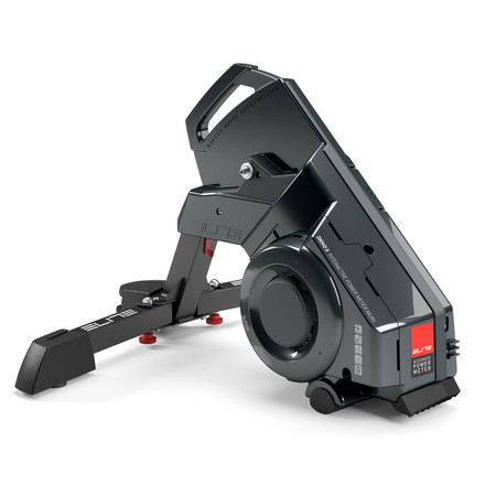

The Elite Drivo II is a smart trainer that connects to TrainerRoad through ANT+ FEC or Bluetooth FTMS. TrainerRoad can automatically control the Drivo II’s resistance in accordance with the workout's profile.
