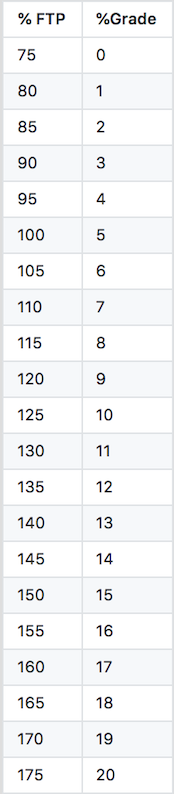

The CLIMB automatically raises on a range from 75% to 175% of FTP. The CLIMB will automatically raise 1% with every 5% increase in FTP within the 75-175% FTP range. That means efforts at 75% of FTP, and anything below, will keep the CLIMB at 0% grade.
For example, if your interval is prescribed at 80% of FTP, TrainerRoad automatically increases the grade of the CLIMB to mimic a 1% grade. Similarly, if your interval is at 100%, the grade will adjust to a 5% grade.
The CLIMB maxes out at a 20% grade. This means the CLIMB won’t raise any higher than 20% once you reach 175% of your FTP. You can reference the scale below for clarity on how the grade relates to changes in % of FTP.
