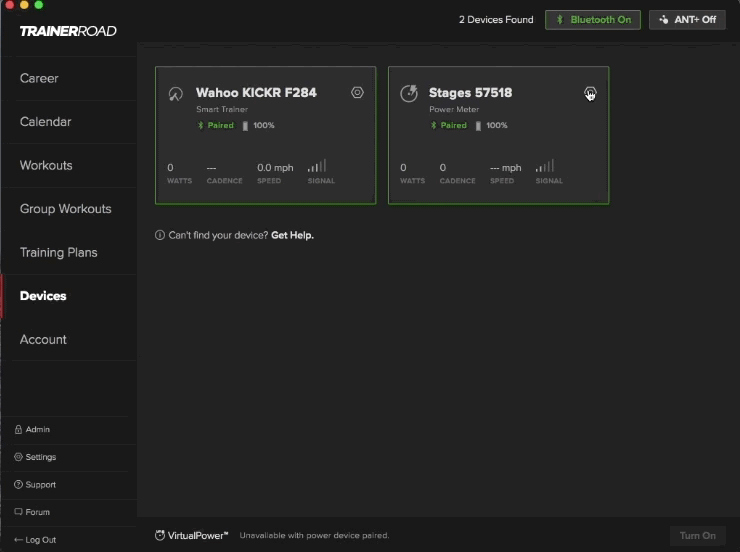

  1. Navigate to the Devices Tab in your TrainerRoad application.
  2. Pair your trainer by clicking its name in the device list.
  3. Click on the device again to open its settings.
  4. Scroll down until you see the 'Calibrate' button.
  5. Click "Calibrate"

Spindown Calibration on Desktop (Mac and Windows)

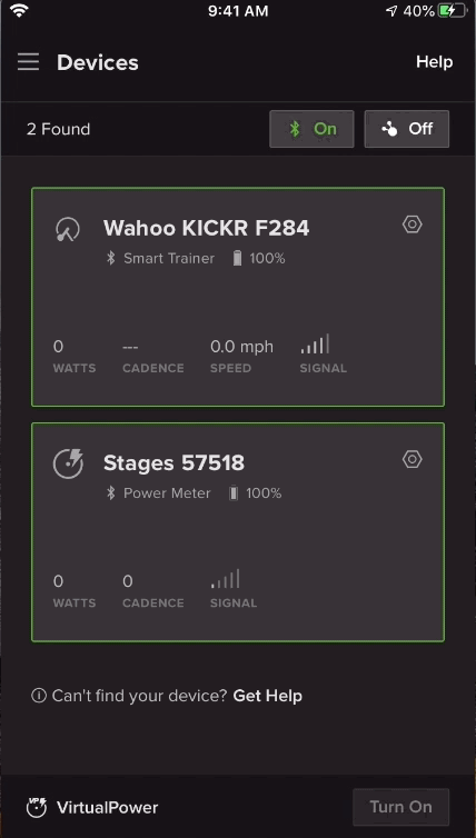

Spindown Calibration on Mobile (iOS and Android)
  2. Pair your power meter by clicking its name in the device list.
  3. Remove your feet from your pedals, and place each pedal at a 6 and 12 o'clock orientation (straight up and down).
  4. Click on the device again to open its settings.
  5. Scroll down until you see the 'Calibrate' button.
  6. Click 'Calibrate'

Power Meter Calibration on Desktop (Mac and Windows)
Power Meter Calibration on Mobile (iOS and Android)
