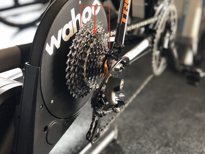

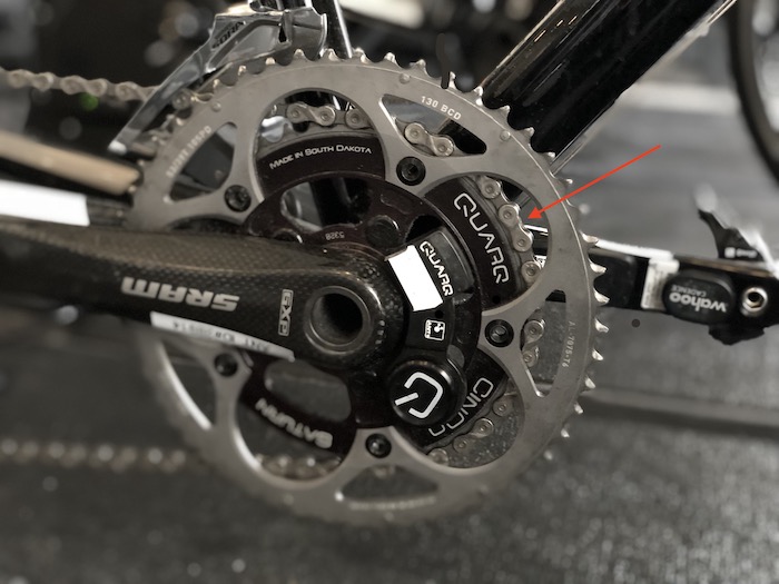

Set your gearing - In order to maintain smooth, even power across all of your power zones, you should maintain a mid-ring gearing in the rear cassette, and either a mid (if you have three) or inner (if you have two) front chainring. Your chain should follow a straight path from rear to front. This will also help you avoid hitting a wattage floor. When in doubt, check your Trainer's manual for their recommended gearing settings or reach out to us.
Mid-gear in the rear cassette
Inner chainring in the front
Maintain your gearing - In most cases, you should not change gears once you've set your gearing. Changing your gears may confuse your smart trainer and can result in a temporarily uneven delivery of resistance.

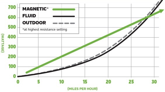

The major advantage of the Fluid Power Curve (Standard Mode) is that one setting can cover a wider range of wattages. Since the curve ramps up, the maximum power you can generate in a giving setting is greater than the Magnetic curve (Resistance Mode), which can be seen in the graph.
Shown above is a power curve of magnetic and fluid trainers. Resistance Mode mimics the linear power curve of a magnetic trainer while Standard Mode mimics the non-linear curve of a fluid trainer.

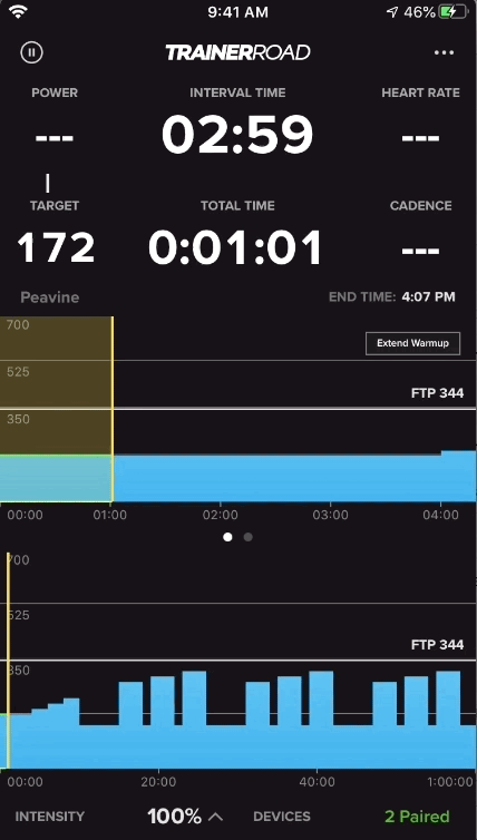

For most training sessions, we recommend using ERG mode. In this mode, smart trainers constantly adjust resistance to match TrainerRoad's target power - no shifting or cadence adjustments necessary. ERG mode allows you to focus purely on the workout at hand.

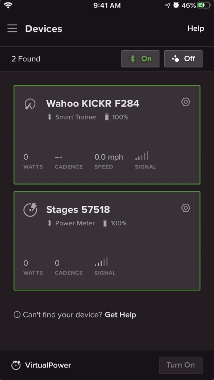

Changing Modes on Mobile (Android & iOS)
Before starting your workout

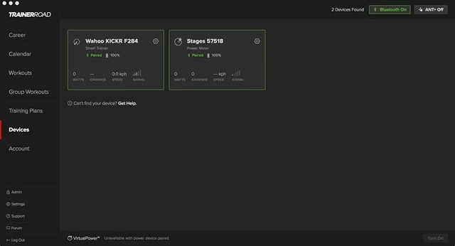

  • First pair your device under the Device tab.
  • Once paired, tap on your trainer to bring up the device settings.
  • From this page, you can now change between your trainer's available modes.

  • First, pair your device under the Device tab.

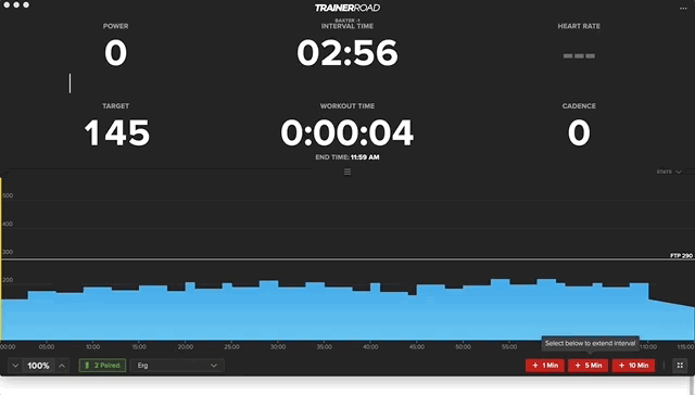

  • From the bottom toolbar, click on the menu showing your current mode.
  • From the menu, select your desired mode.
  • Use the slider to the right to adjust modes (if applicable).
