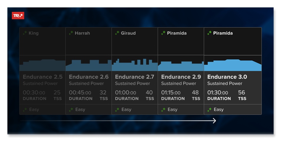

When TrainerRoad AI detects that you may benefit from more or less endurance volume, it can recommend slightly longer or shorter workouts. These adjustments help you get the most out of your training while staying fresh and avoiding burnout.
For example:
  • If you’re handling your training well, TrainerRoad AI may extend your next endurance ride or interval session to help you continue progressing.
  • If your recent workouts have been especially tough or fatigue is trending upward, TrainerRoad AI might shorten a session to support recovery.

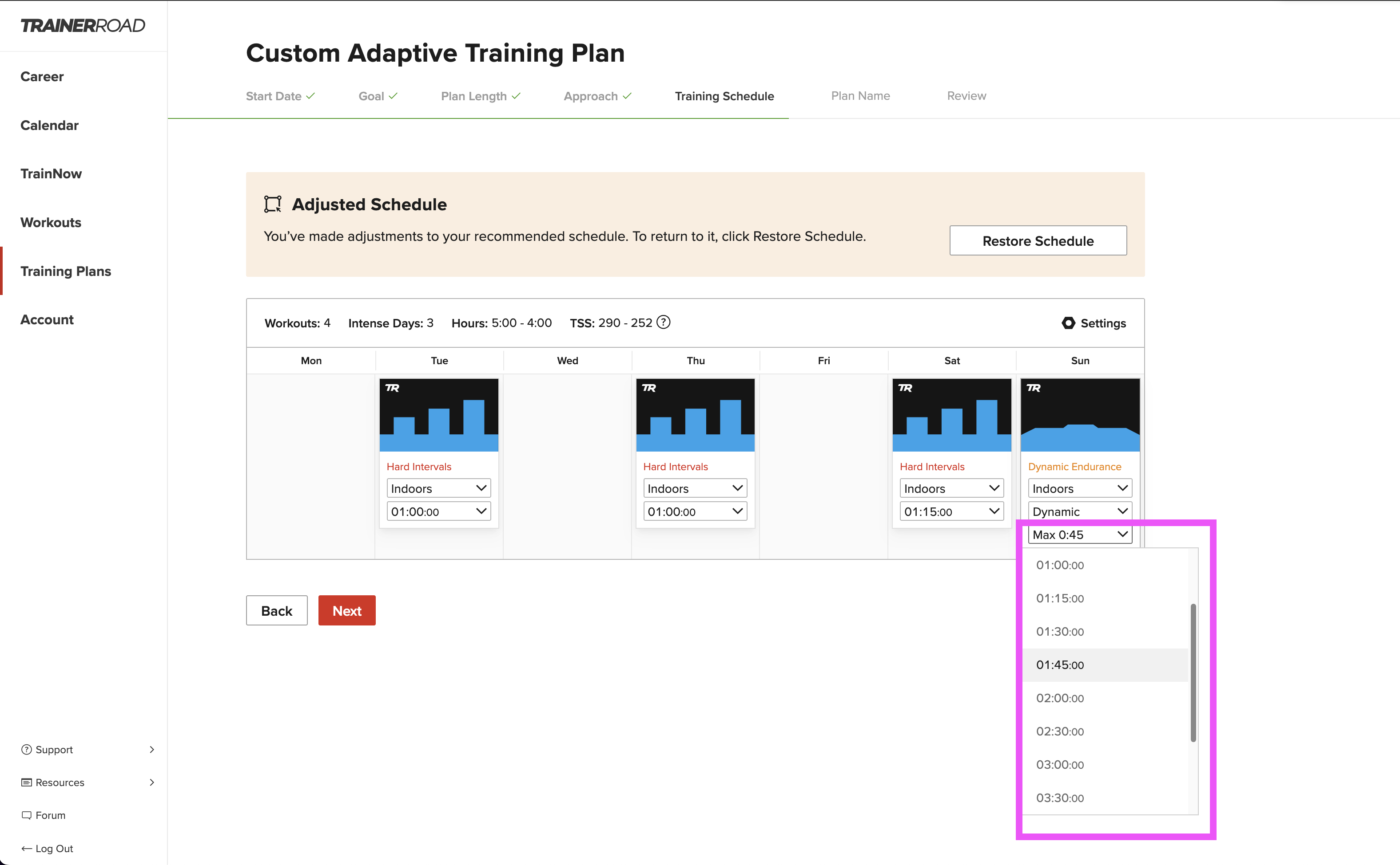

Step Four: In the schedule step your weekend endurance ride will have an additional drop down. Your workout will automatically be set to Dynamic.
  • Note: You will only see Dynamic Endurance appear on your schedule when you have an endurance workout scheduled. You can add an endurance ride to your plan by adding an additional day of training if you are on a three day plan with three intense workouts per week or by swapping three hard days for two hard days.
Step Five: In the drop down below you can set a maximum amount of time for the duration of your dynamic endurance workout.
  • Note: Workouts will not automatically be set at the maximum duration. Your training plan will gradually work up towards the maximum duration that you have set based on completed training sessions.

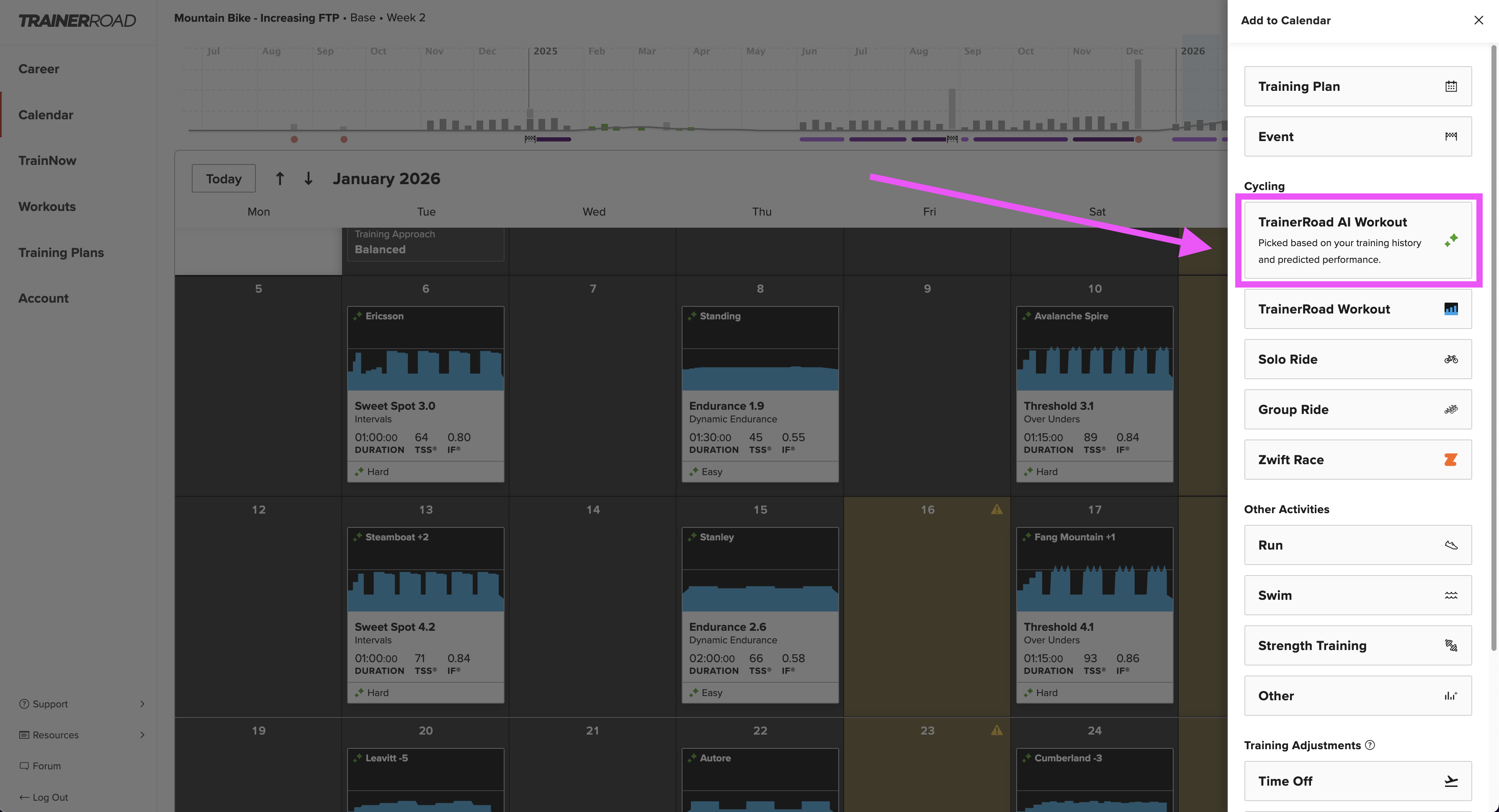

Step One: Go to your TrainerRoad Calendar on the TrainerRoad website.
Step Two: Select the +Add option in the upper right hand corner of the screen.
Step Three: Select TrainerRoad AI Workout from the navigation menu

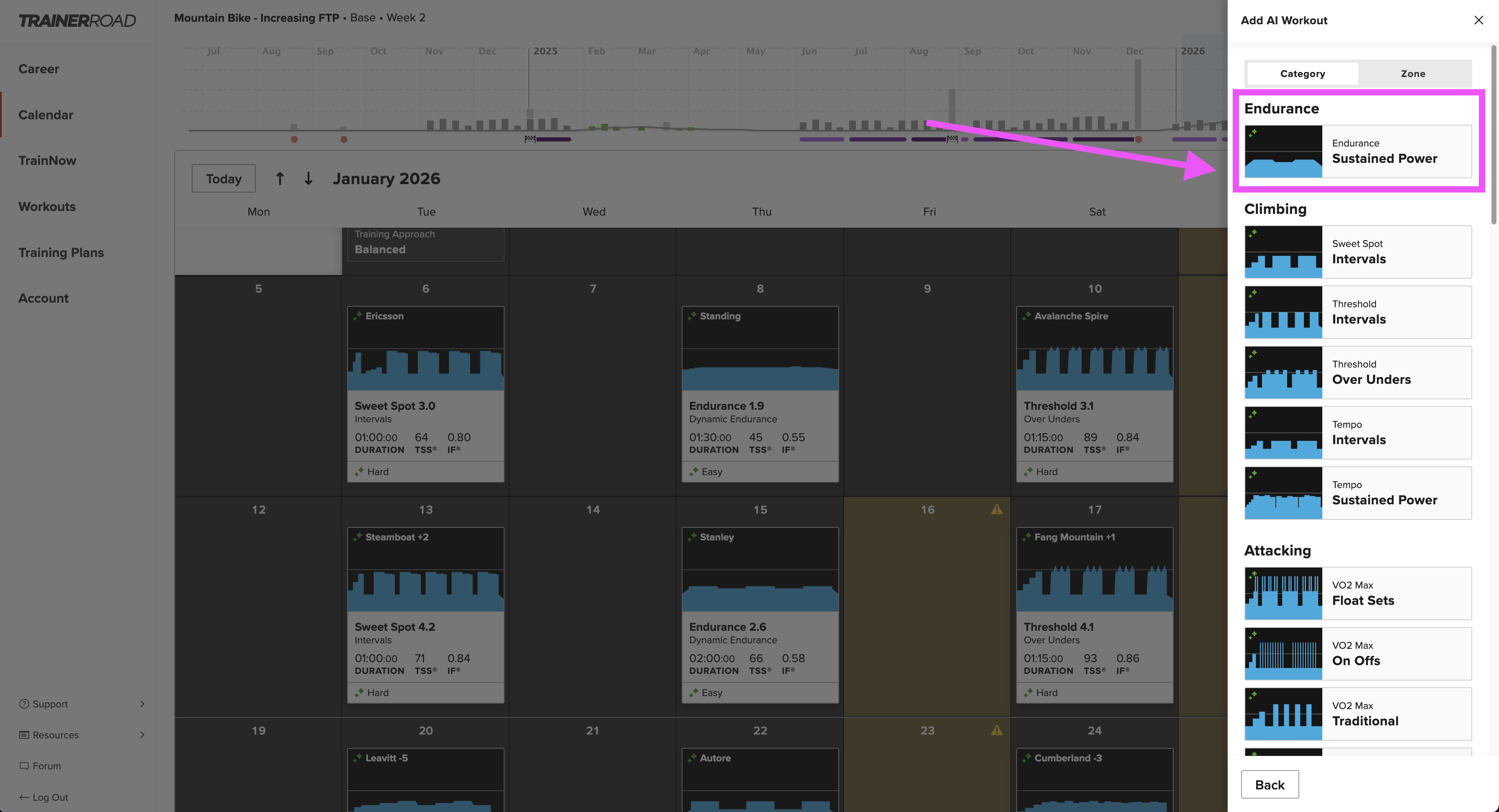

Step Four: Choose the Sustained Power option in the Endurance category.
Step Five: Hit Schedule in the bottom right hand corner of the workout description.

TrainerRoad AI focuses on training the right energy systems, progressing your fitness with smarter volume increases over time. Longer rides require significantly more recovery, which can interfere with your training consistency and lead to setbacks. That’s why TrainerRoad AI won’t trend your workouts up to match ultra-distance events like a 9-hour race. Instead, it builds toward the five-hour cap in manageable 15-minute increments only increasing duration when your fitness and fatigue levels allow.
