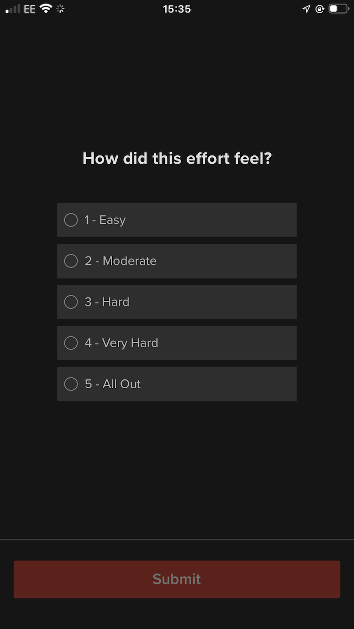

Intensity Survey
The most common survey you will see is the one pictured below, which asks you to rate how the ride felt on a scale from one to five. When answering the survey, consider the entire ride, and don’t worry about how you expected it to feel based on workout type.
A post-workout survey. This one asks you to gauge the intensity of the ride.

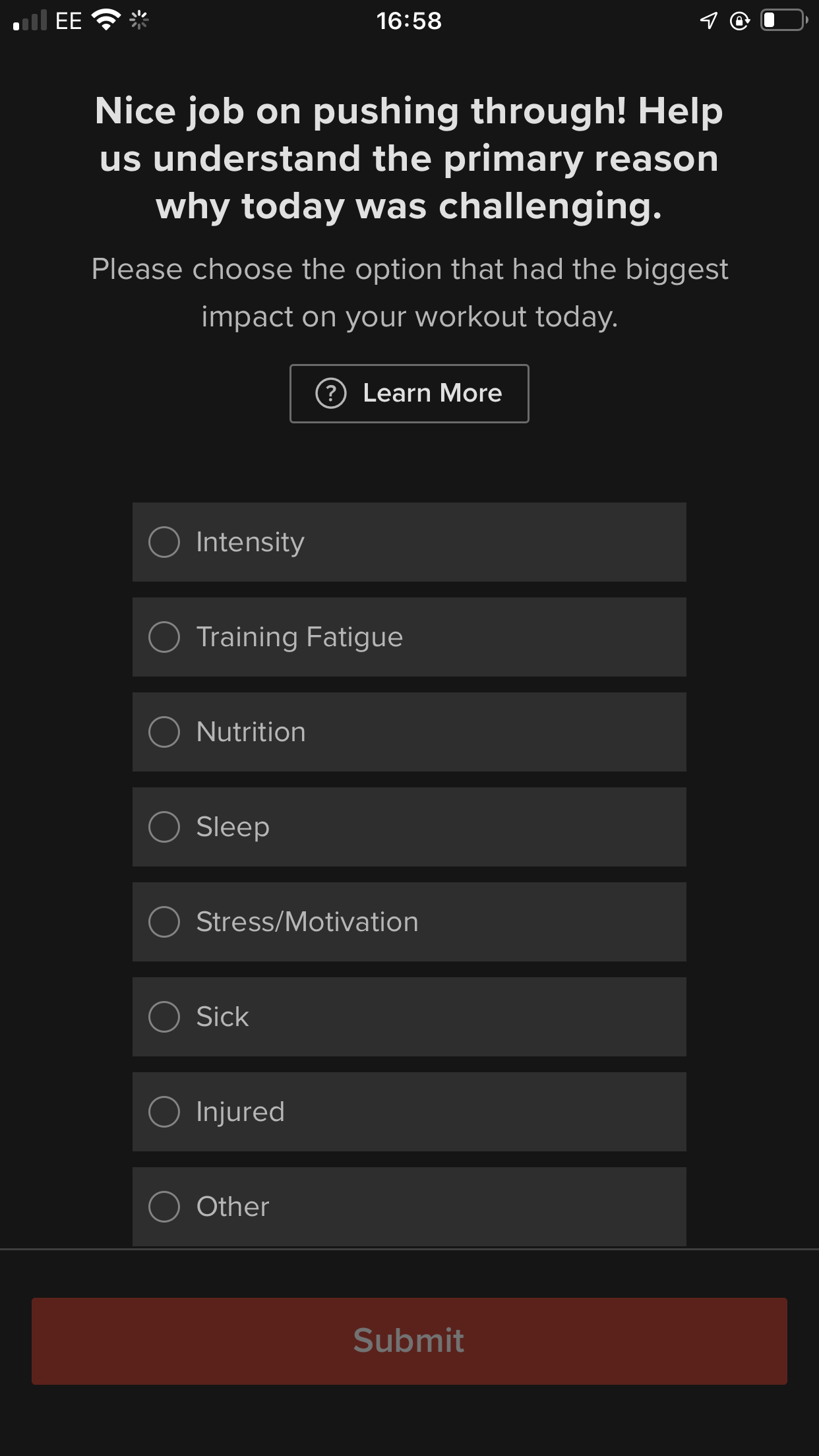

Struggle Survey
Some workouts are harder than others, and life happens. For example, a workout you’d normally breeze through ends up feeling like a massive challenge. You’ll get a survey based on how that particular workout went, and your response to the survey can help affirm or correct that information.
Another post-workout survey, as seen in the app. This one asks you to specify why you may have struggled.

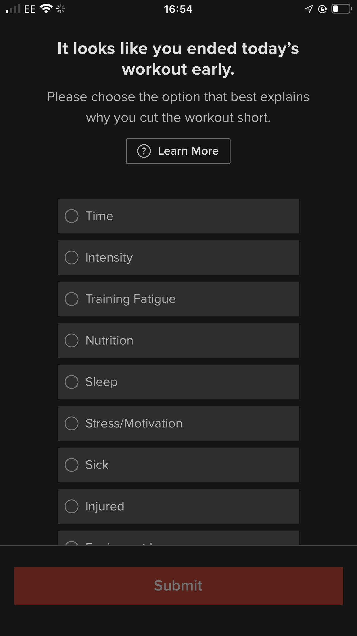

Cut Short Survey
Sometimes you don't have time to complete your workout. For example, an important phone call means you need to cut the workout short. In that case, you'll still get a survey based on how that particular workout went, and your response to the survey can help affirm or correct that information.
Another post-workout survey, as seen in the app. This one asks you to specify why you may have ended a workout early.

If you're doing an indoor workout with an internet connection, you'll be served a survey in the app once the ride is completed. Just click or tap the appropriate response, select "Submit," and your survey response will be saved.
How to Rate Your Effort
  1. Easy
    This ride felt easy and non-taxing, requiring little effort or focus. You could repeat the ride and pass it without issue.
  2. Moderate
    This ride was somewhat comfortable but required some focus to complete. You felt a little challenged but had confidence that you could finish. If the ride had an additional set of intervals, you could complete it.
  3. Hard
    This ride required effort and focus and was challenging to complete. It felt tough, and you looked forward to the ride ending. If there were an additional set of intervals, you could have done it with significant focus.
  4. Very Hard
    This ride was very difficult to complete, and it tested you. If there were one more set of intervals, you wouldn’t have been able to complete it.
  5. Maximum Effort
    This ride was extremely difficult. It pushed you well beyond your abilities and took a massive amount of energy and focus to complete. You’ll feel like you barely made it to the end of this ride, and that you had to pull out every mental trick in the book to finish. If you had to pause during a workout to catch your breath or adjust the power demand down, the workout was likely a max effort.

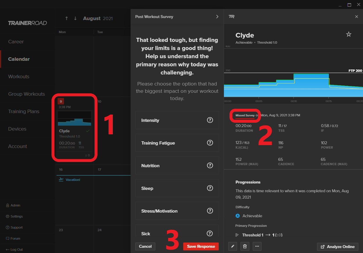

How to Change your Survey Response
In cases where the survey isn't immediately completed (whether it was skipped or the workout was simply completed offline/outside), a response can still be added up to a week after completion.
To do so, go to the Ride Analysis page on the website, or the Workout Details drawer in the app, then click or tap Missing Response.

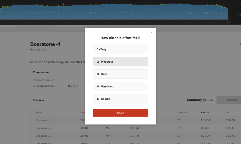

From the website
After selecting the ride from your Calendar page:
A missing survey response is being added via the Ride Analysis page.
From the app
In the app, this can be done entirely from the Calendar itself.
A missing survey response is being added via the Workout Details drawer.
