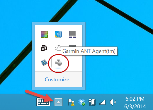

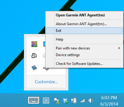

Turning off Garmin ANT Agent (PC)
From the Task-bar, right click on Garmin Express and click Exit.

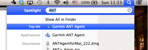

Turning off Garmin ANT Agent (Mac)
1. Search for ANT Agent or Express...
... or access the program from the tool bar.

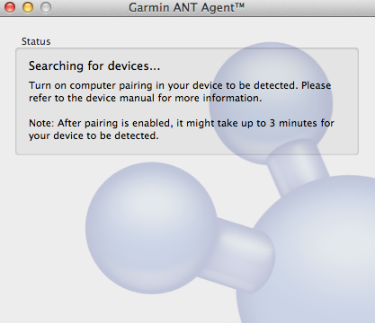

2. Open the program.
This will allow you to see if the program is running.
If what you see matches the above screenshot, ANT Agent is running.
3. Quit the program before using TrainerRoad.
