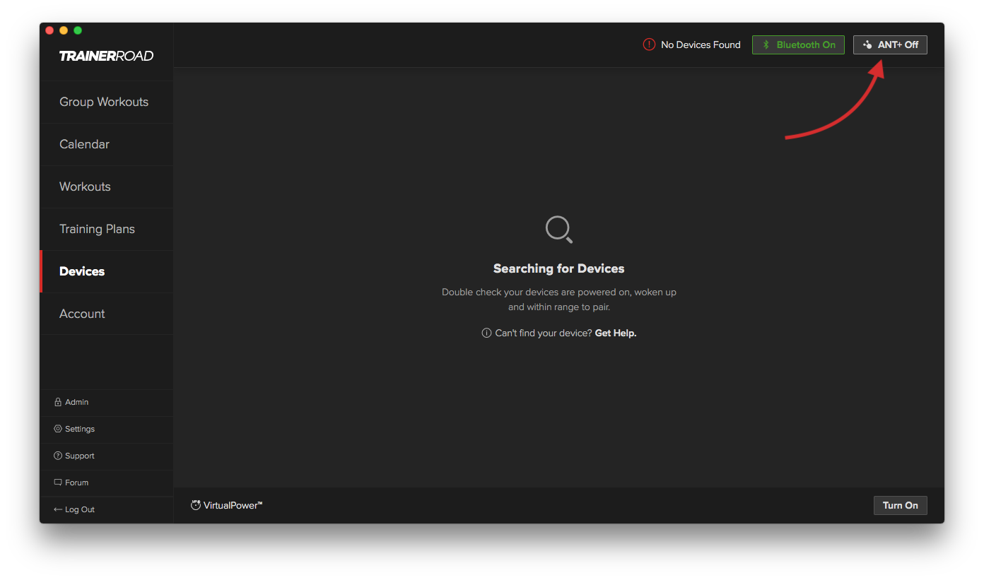

Step 1: Plug the ANT+ USB Stick into Your Computer or Device
This is what you will see if the ANT+ USB stick is not plugged into your computer's USB port or is not recognized. If the ANT+ stick is plugged in and still not recognized, there may be something wrong with the stick or your computer's USB port.

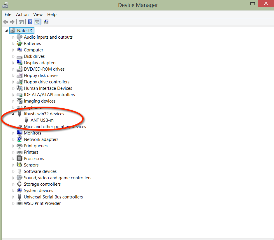

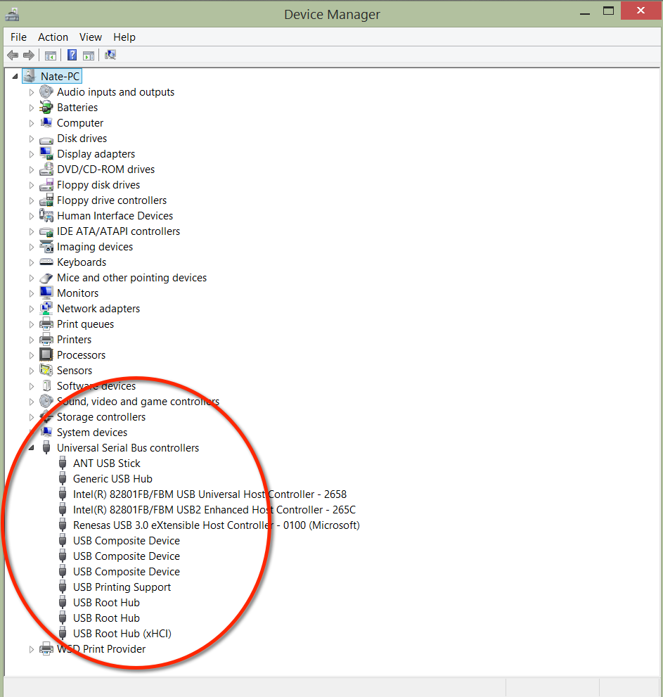

How to Check for Installed Drivers
To check if the drivers are installed, go to "start" and type "Device manager". Load the program called device manager. The device might be displayed in two different locations.
libusb-win32-devices
Universal Serial Bus controllers
Trouble installing drivers?
If it looks like the drivers won't install, the next step is to try another USB Port. If that doesn't work, try installing the drivers on another computer. If you still can't install the drivers on another computer, it is likely that you have a bad ANT stick and will need a new one. If you have access to another ANT+ USB stick, try that on both computers and see if the drivers will install.
It's also possible the driver was corrupted or changed by your OS or another software program. To fix this, you can uninstall your device drivers and perform a fresh install by following the instructions on this page.
Drivers install on another computer, but not the one you train with?
We've seen this a few times and there's not much we can do. There is likely a system-level problem keeping you from installing the drivers for the USB stick. A refresh of the operating system is often needed. This is depressing, I know. This occurs because there is a system-level problem between the operating system and Garmin's drivers for the ANT+ stick. Make sure that you test that ANT stick on more computers and USB ports on your computer before you reach this drastic level of refreshing your OS.

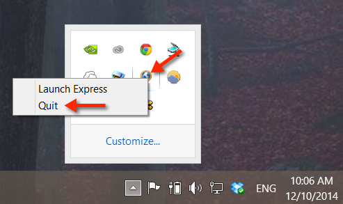

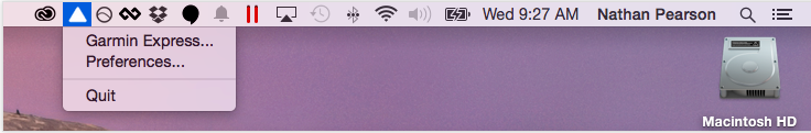

Check for Garmin ANT Agent, or Garmin Express in the system tray. If that program is on, make sure you exit it. See screenshot examples below, or watch this video on How to Disable Garmin ANT Agent.

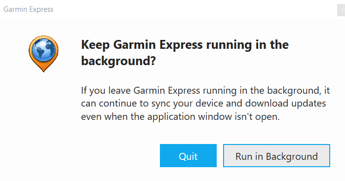

With Garmin Express, you'll need to make sure that it's closed fully, and not running in the background, which it can default to. Check your system taskbar to ensure that it isn't running. If it is still in your taskbar, follow the images below to exit it.
Garmin Express (PC)
Garmin Express (Mac)
Garmin ANT Agent (Mac)
Make sure to select "Quit" to exit out of Garmin Express entirely.

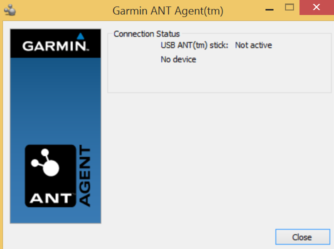

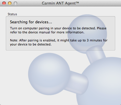

Step 4: Check if Garmin Express Can Detect the Stick
If TrainerRoad can not find the stick, and there are no conflicting problems then we want to test the stick in Garmin's software to make sure it works.

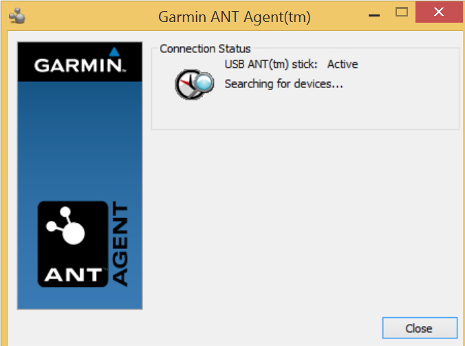

Open Garmin Express and locate it in the system tray (PC) or taskbar (mac), and click to open it.
Make sure to close out of the Garmin Express window once done testing, and to close it from the taskbar as shown in the photos above.
Working: Device is Connected and Active
PC Example
Mac Example

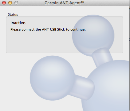

Not Working: Device is Not Connected and Inactive
PC Example
Mac Example
What do I do if Garmin ANT Agent/Express does not detect the ANT+ USB Stick?
If the drivers are properly installed and Garmin ANT Agent/Express can't detect the stick, you'll want to repeat the process on another USB port on your computer. If you get the same result try it again on another computer.
If you can't get TrainerRoad or Garmin ANT Agent/Express to detect the USB stick, you likely have a bad ANT stick and should return/exchange it from your place of purchase.
