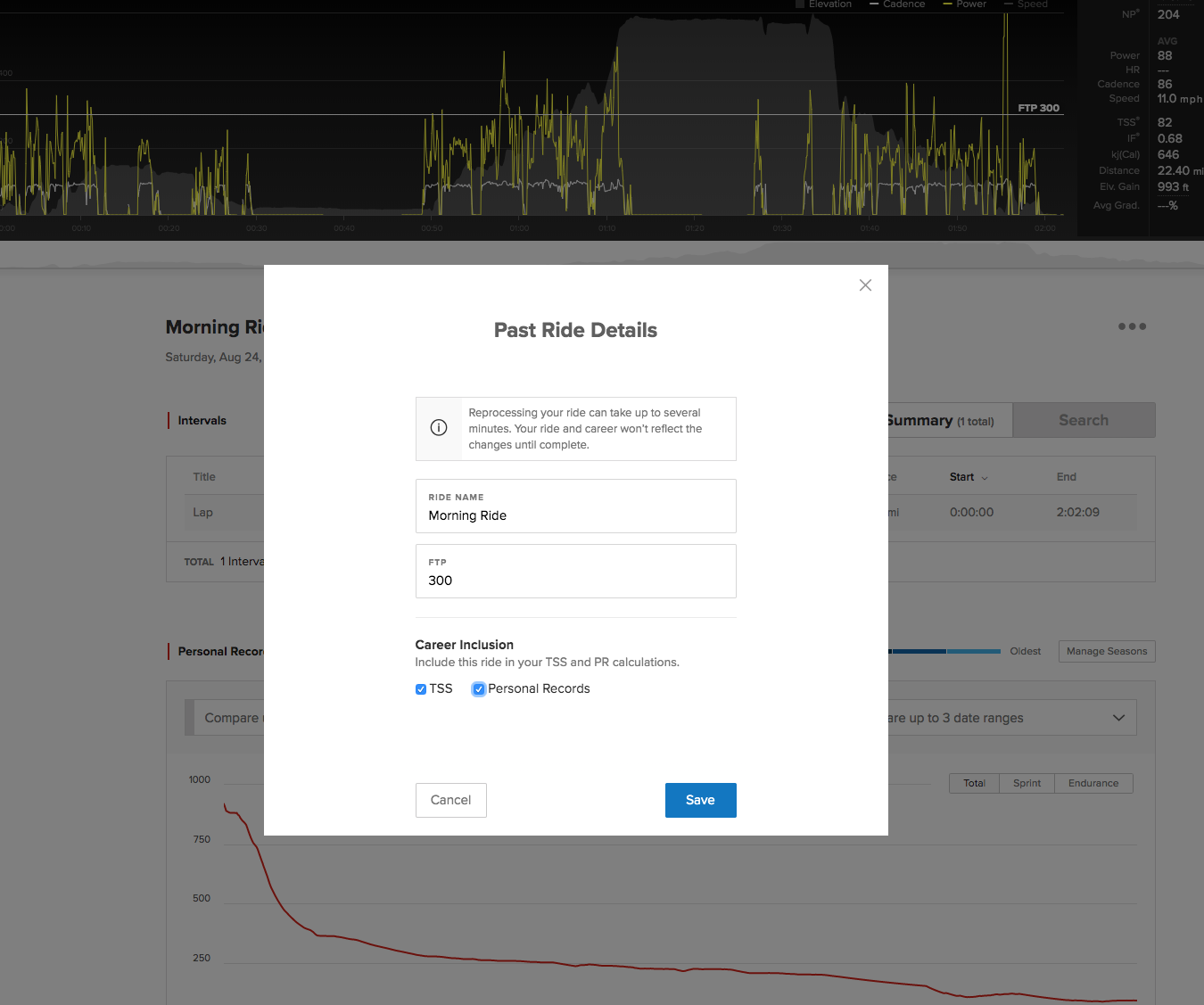

How to exclude a workout with a high TSS
If your ride has an inaccurately high TSS value, you can exclude the workout from your Personal Records so your data is not skewed. You can exclude a ride from your PRs when you view the ride online from the Past Rides page.
