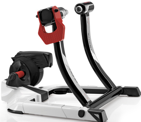

  • Elite Qubo Digital Smart B+
  • Elite Rampa
  • Elite Real E-Motion B+
  • Elite Real Turbo Muin B+
  • Elite RealAxiom B+
  • Elite Arion Digital Smart B+
  • Elite RealTour B+
  • Elite Drivo
  • Elite Drivo II
  • Elite Direto
Elite smart trainers we support as ANT+ or Bluetooth Smart power meters:
  • Elite Qubo Power Smart B+
  • Elite Turbo Muin Smart B+
  • Elite Kura
Elite trainers we support via VirtualPower:
  • Elite Arion
  • Elite Arion Mag
  • Elite E-Motion
  • Elite Novo Force
  • Elite Qubo Fluid
  • Elite Qubo Power Mag Pack
  • Elite Turbo Muin

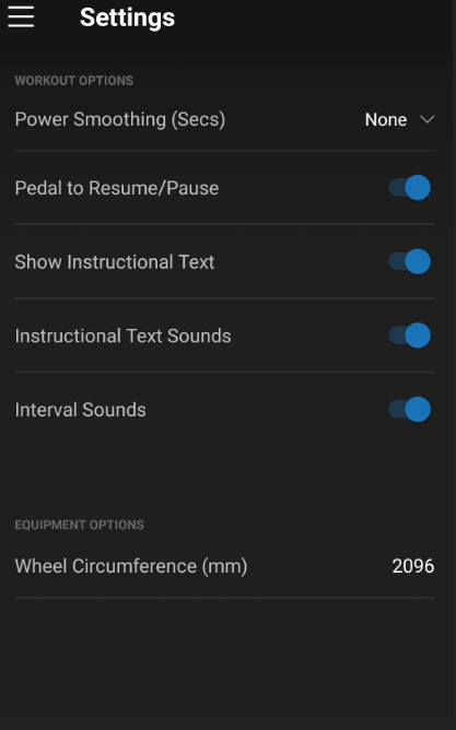

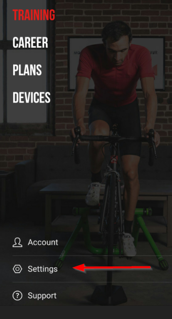

The Muin's Wheel Circumference should be set to 2070mm when using VirtualPower and a speed sensor. You can adjust the Wheel Circumference settings under the Settings tab of your app.
For users with the Elite Misuro B+ Speed/Cadence/Power sensor, follow the Elite instructions regarding wheel circumference. This is (actual wheel circumference in mm/ 13.2). Enter this figure into the above setting.
