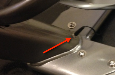

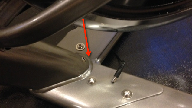

1. Unplug the Cycleops 400 Pro resistance unit.

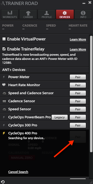

2. Select the Pair Button under the Cycleops 300/400 Pro section of the TrainerRoad devices tab.
3. Plug in the Cycleops 400 Pro resistance unit.

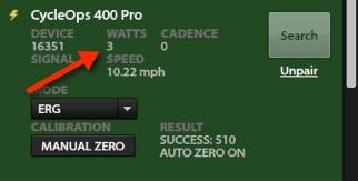

4. Pedal the Cycleops 300/400 Pro.

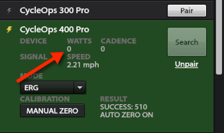

5. The Cycleops 300/400 Pro section of the TrainerRoad devices tab turns green indicating the power tap is paired.
6. Within 5 seconds, the Cycleops 300/400 Pro section of the TrainerRoad devices tab is populated with the device id of the resistance unit and power data begins to appear on the devices tab of TrainerRoad.

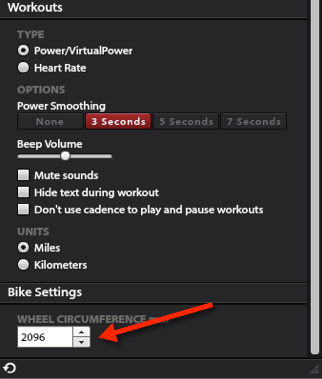

To Set/Verify the flywheel circumference in TrainerRoad follow these steps:
Select the Profile button on the TrainerRoad application
Update the Wheel Circumference to be 2096 mm
