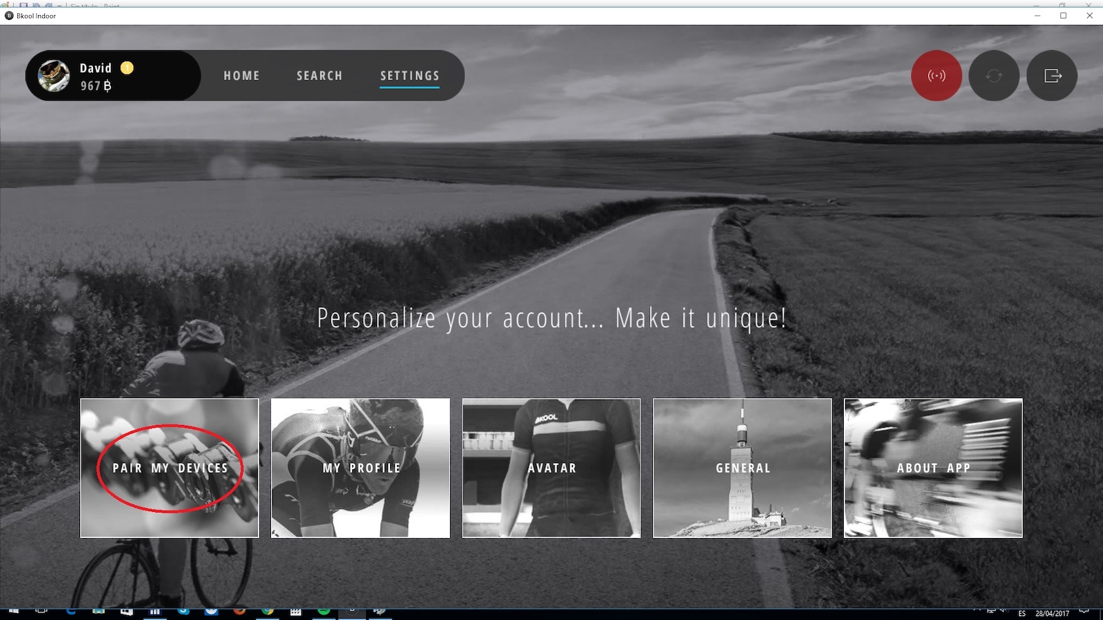

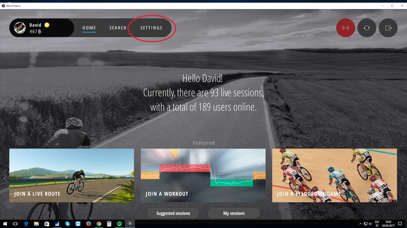

2. Open Bkool simulator and click on Settings.

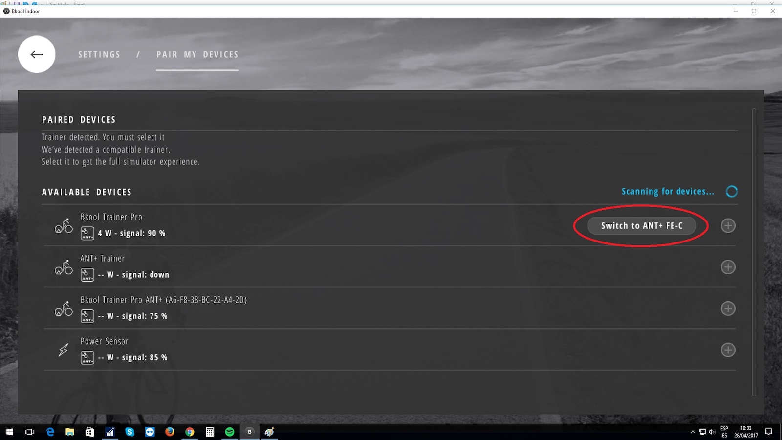

3. Then click on Pair my devices. The Bkool trainer will be detected then.
4. If the ANT+ FE-C protocol is not enabled yet, a button to change it will appear. Push that button.

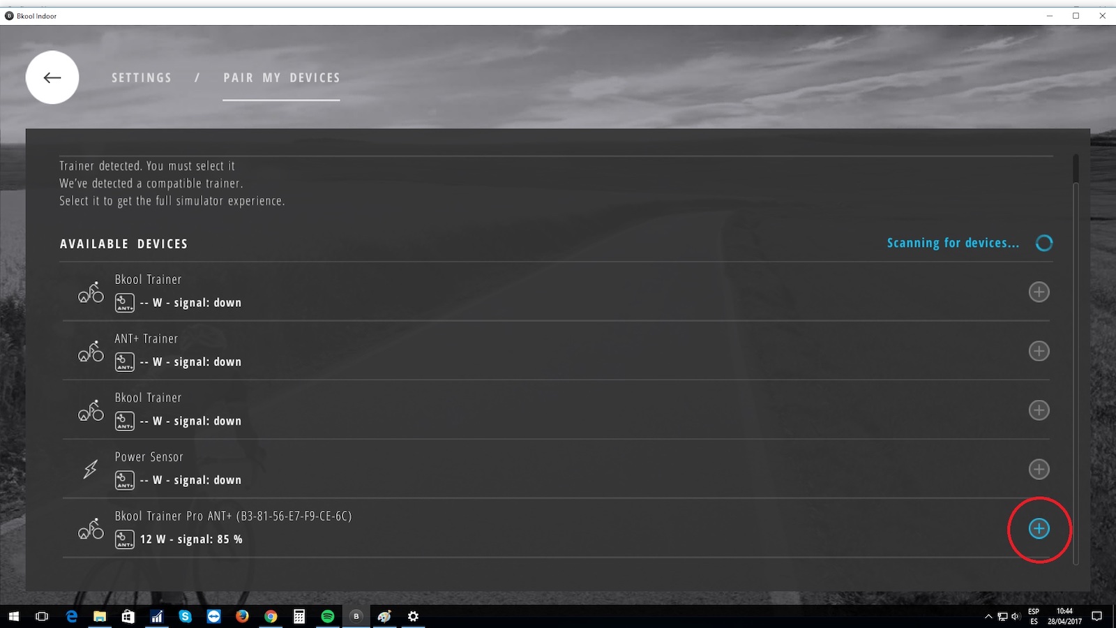

5. Finally pair the trainer again to the simulator, clicking on the + icon on the right side of the screen.
