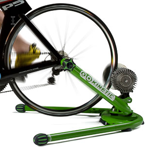

VirtualPower allows riders to derive power readings without a power meter. Each trainer make, and model has a unique speed-to-power ratio (also referred to as the trainer's "power curve").
TrainerRoad takes speed readings from a rider's speed sensor and uses those speed readings to calculate VirtualPower based on the trainer's power curve. We'll use a fictional trainer ("Trainer X") as a hypothetical example to explain this further. It takes 20 miles per hour to output 250 watts, 21 miles per hour to output 255 and so on on "Trainer X".
TrainerRoad will be able to calculate your VirtualPower as long as you have a speed sensor connected and the make/model of your trainer input in our software. TrainerRoad has power curves for most trainers currently in production. Additionally, we do our best to add the power curves of new trainers that arrive on the market.
