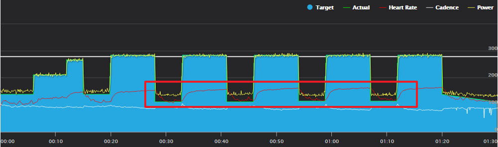

Wattage Floor
Sometimes when riding low-wattage intervals, riders may come into contact with what we call the "wattage floor" - essentially the trainer's lower mechanical limit. When this happens, riders may not hit their target watts for recovery intervals since the target power is beneath the "wattage floor" of the trainer. In other words, the number of watts it takes to turn the pedals is higher than the target power.
When you come into contact with the wattage floor, it will often appear as though your trainer is "floating" above the target power. Each trainer is slightly different, but most commonly riders will encounter the wattage floor when riding recover intervals below 100 watts.
The good news is that the wattage floor is usually pretty easy to avoid. If you find that you're running into the wattage floor, try shifting into an easier gear. The trainer's wattage floor is lower when using easy gearing combinations, so down-shifting should allow you to reach those low power targets.

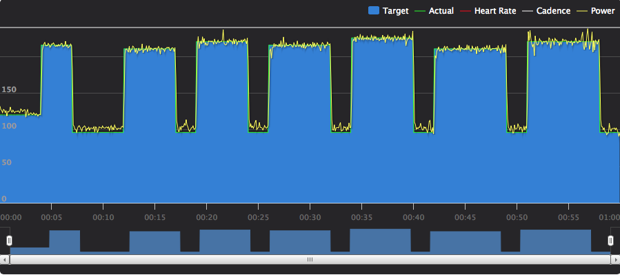

Smooth Power Output
One advantage of smart trainers is how they keep your power exceptionally smooth. Check out the distinct difference in how closely Target Power matches Actual Power between the same workout done on a regular trainer (top) and on a smart trainer in Erg mode (bottom).
