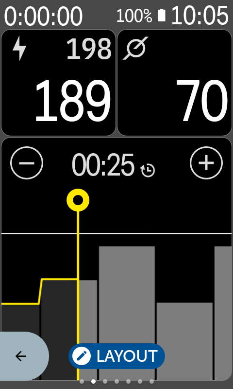

When you push an Outside Workout to your Hammerhead, your Hammerhead automatically presents you with this display for your workout. This display includes target power and power, cadence, and an overview of the current interval as well as a preview of the upcoming intervals.

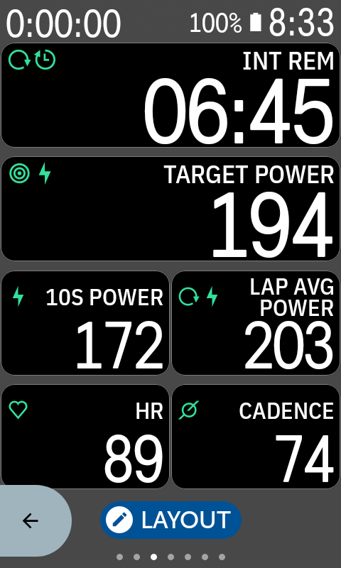

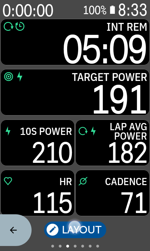

In addition to this display we recommend building a custom display to follow along during your Outside Workouts. This custom display includes:
1. Remaining Interval Time
2. Target Power
3. 10s Average Power
4. Lap Average Power
5. Heart Rate
6. Cadence.
This custom display includes everything you need to successfully execute your TrainerRoad Outside Workout. Here’s how you can create this custom display:

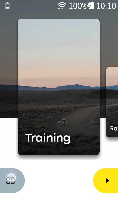

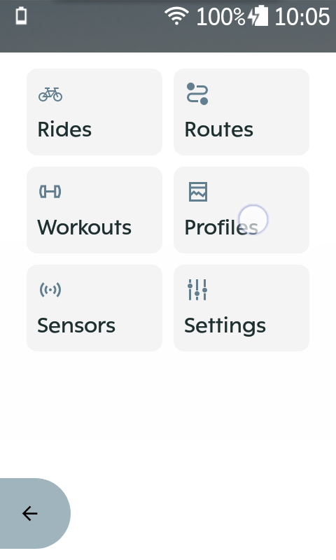

Step 1: From the home page of your Hammerhead device select the app settings icon in the bottom left-hand corner of the screen:

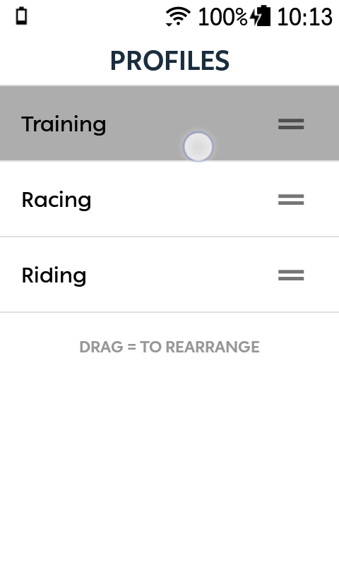

Step 2: In the Apps view Select Profiles:
Step 3: Under Profiles select Training

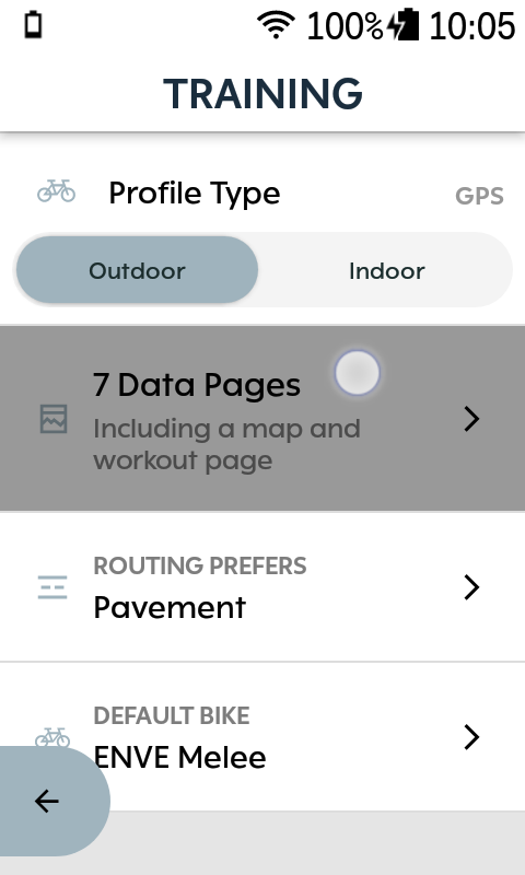

Step 4: Toggle the Profile Type to Outdoor
Step 5: Select your Data Pages

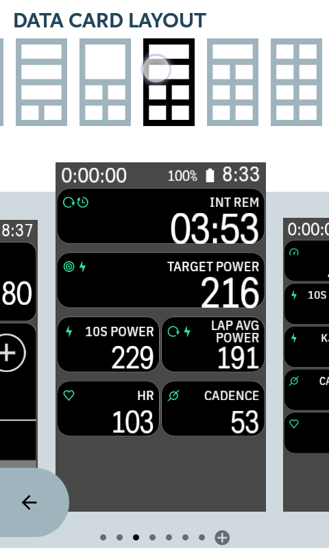

Step 7: Choose your desired Data Card layout with six data displays. We recommend this one:

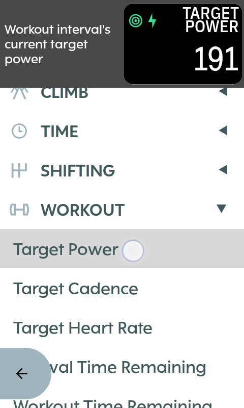

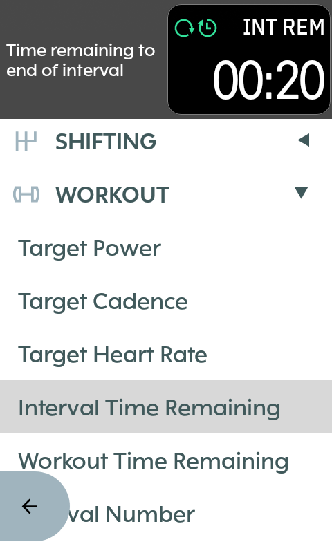

Step 8: Tap the top display box. Under workout select ‘Interval Time Remaining’
Step 9: Tap the second display box and select Workout intervals current target power

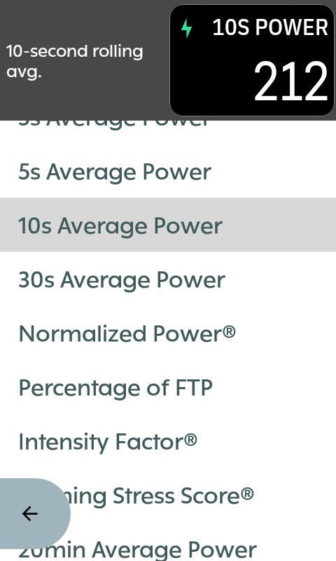

Step 10: Tap the third display box and add 10 second rolling Average Power

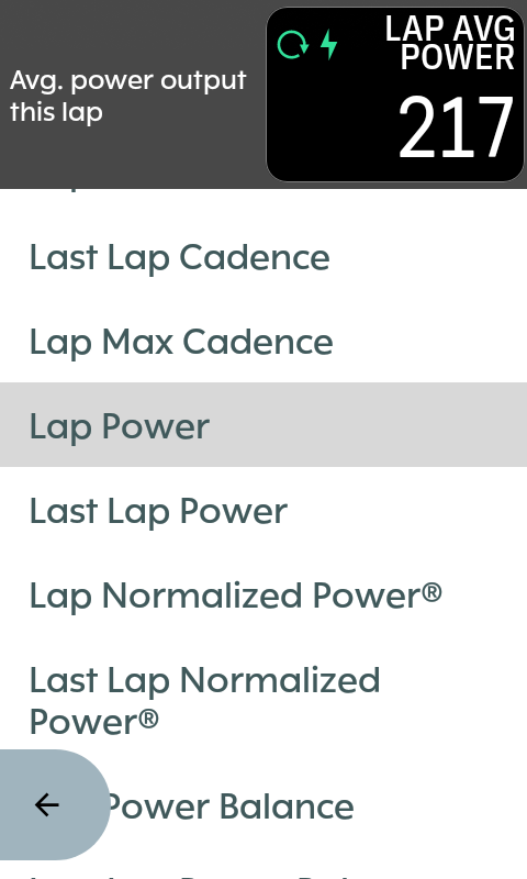

Step 11: Tap the fourth display box and add the average lap power

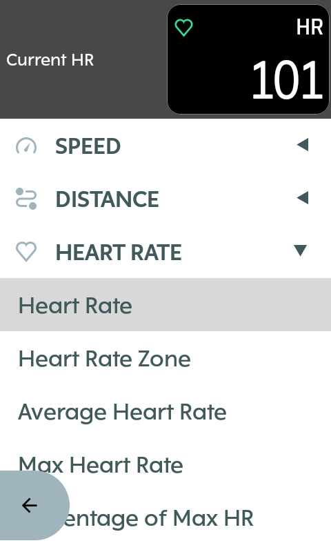

Step 12: Tap the fifth display box and add heart rate

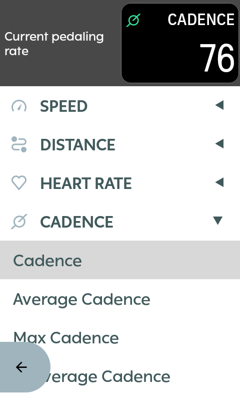

Step 13: Tap the sixth display box and add cadence
Step 14: Your custom display is built! Navigate back to the main menu to save your custom display.
