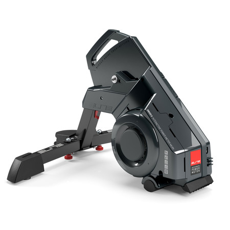

The Elite Drivo II is a smart trainer that connects to TrainerRoad through ANT+ FEC or Bluetooth FTMS. TrainerRoad can automatically control the Drivo II’s resistance in accordance with the workout's profile.

The Elite Drivo II has a selection of two modes that can be used with TrainerRoad. Riders can toggle between ERG and Resistance mode in the desktop app by using the dropdown tool located on the bottom bar of the workout screen. While using the mobile app, the mode can be changed by going to the Devices tab and tapping on the connected trainer’s name.
