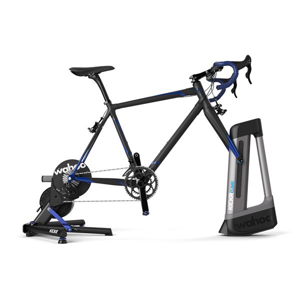

The KICKR CLIMB is an indoor training device that physically adjusts the front of your bike to mimic climbing while riding indoors. TrainerRoad automatically adjusts the CLIMB based on the percent FTP of the interval your workout prescribes. The CLIMB can currently only be used with TrainerRoad while connected via Bluetooth Smart.

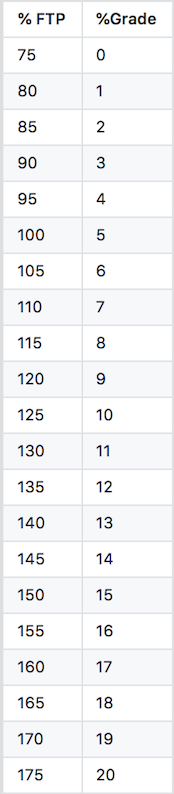

The CLIMB automatically raises on a range from 75% to 175% of FTP. The CLIMB will automatically raise 1% with every 5% increase in FTP within the 75-175% FTP range. That means efforts at 75% of FTP, and anything below, will keep the CLIMB at 0% grade.
For example, if your interval is prescribed at 80% of FTP, TrainerRoad automatically increases the grade of the CLIMB to mimic a 1% grade. Similarly, if your interval is at 100%, the grade will adjust to a 5% grade.
The CLIMB maxes out at a 20% grade. This means the CLIMB won’t raise any higher than 20% once you reach 175% of your FTP. You can reference the scale below for clarity on how the grade relates to changes in % of FTP.
