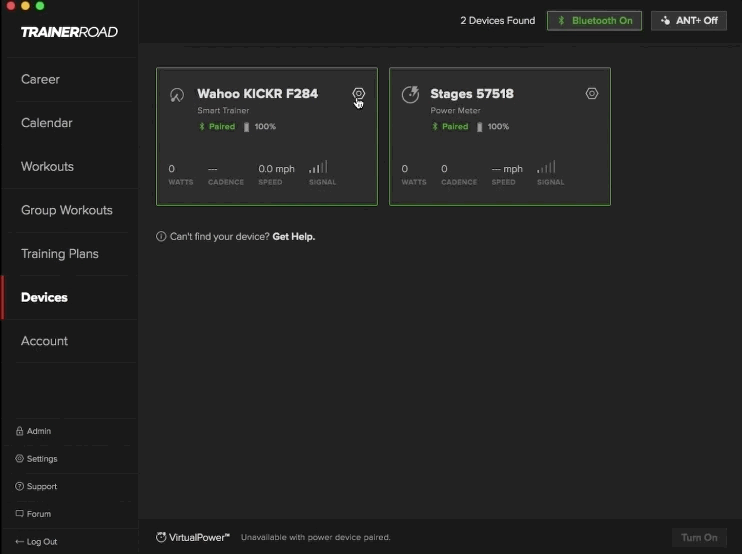

  1. Navigate to the Devices Tab in your TrainerRoad application.
  2. Pair your trainer by clicking its name in the device list.
  3. Click on the device again to open its settings.
  4. Scroll down until you see the 'Calibrate' button.
  5. Click "Calibrate"
  6. You'll then be prompted to speed up until you've reached a target speed.
  7. Once you reach your target speed, stop pedaling, and let your bike coast to a stop.
  8. As the bike slows, and the calibration is successful, you'll be prompted to accept the calibration results.
  9. Accept these results
  10. You're good to go!

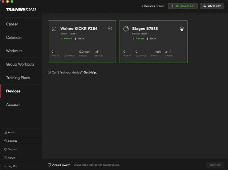

Spindown Calibration on Desktop (Mac and Windows)

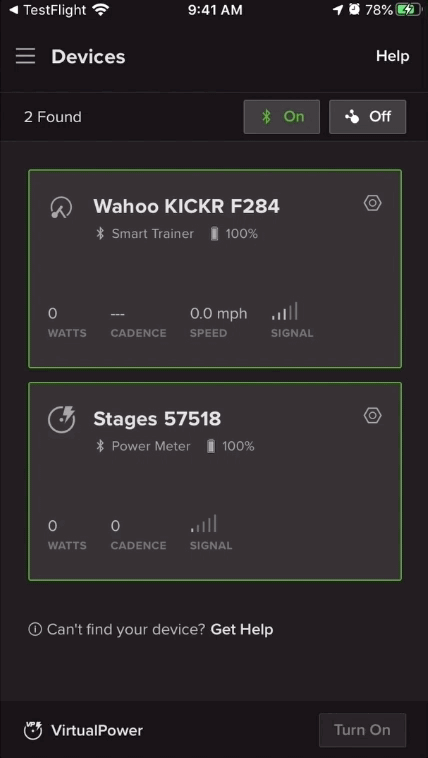

Spindown Calibration on Mobile (iOS and Android)
  2. Pair your power meter by clicking its name in the device list.
  3. Remove your feet from your pedals, and place each pedal at a 6 and 12 o'clock orientation (straight up and down).
  4. Click on the device again to open its settings.
  5. Scroll down until you see the 'Calibrate' button.
  6. Click 'Calibrate'

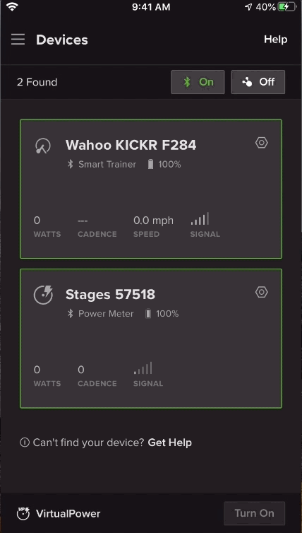

Power Meter Calibration on Mobile (iOS and Android)
