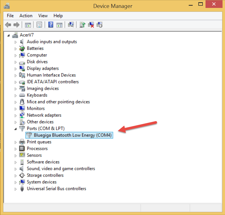

    • If you're running into problems with the BLED 112, even after installing the drivers, try the following steps:
      1. Make sure the BLED is plugged into your computer's USB port. Open the Device Manager.
      2. Next click on "Ports (COM & LPT)" You should now see your BLED under the name of 'Bluegiga Bluetooth Low Energy' with a COM number.
      3. Right click on the BLED and click 'Update Driver Software'.
      4. Click 'Browse my computer for driver software', and locate the TrainerRoad USB Drivers you downloaded from the link above. This is typically located in "C:\Program Files\TrainerRoad USBdrivers" or \Program Files (x86)\ if you're on a 64bit operating system.
      5. Start TrainerRoad and click 'Search for Bluetooth 4.0' in the Devices tab.
      If that doesn't work, and you still don't see pairing options for Bluetooth, try plugging the BLED-112 into a different USB port and trying again.
