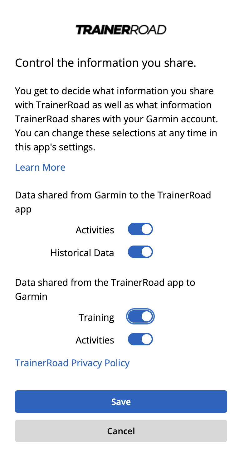

Authorize Garmin Sync
To allow outside workouts to push to Garmin Connect, set up Activity Sync to include pushing workouts from TrainerRoad to Garmin. If you have previously set up Activity Sync, you will need to re-authenticate to enable this.
Allow TrainerRoad to share data with Garmin Connect by enabling all the toggles.
  • Note; the "Historical Data" toggle is disabled by default. Manually enable it for your training history to sync to TrainerRoad.
You can Learn more here:

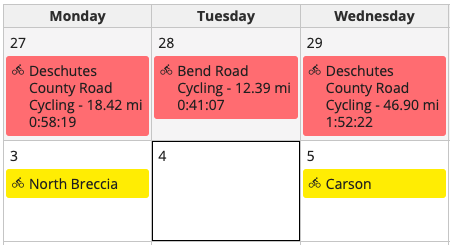

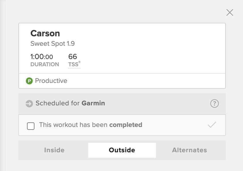

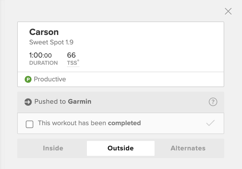

  • Workouts will be pushed to Garmin the day that they are scheduled.
    • Workouts scheduled outside of today will be "Scheduled for Garmin", and won't appear on Garmin Connect yet.
Once a workout is "Pushed to Garmin", it will appear on your Garmin Connect calendar.

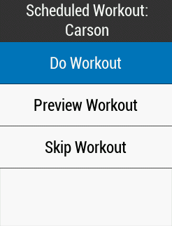

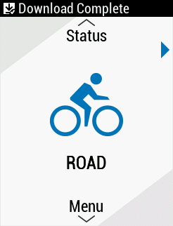

To start a workout, turn on your Garmin head unit and make sure it connects to your mobile device via Bluetooth. When this happens, your Garmin Connect account will send the workout to your head unit. You should see a "Download Complete" message on your Garmin when it has finished syncing.
Once this is complete, navigate to your workout screen where you should be prompted to complete your scheduled workout.
Note: If you aren't prompted to start your scheduled workout, it may be visible from your Training Plan/Calendar.

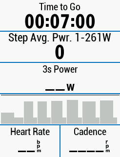

For the closest thing to a TrainerRoad workout, we recommend creating a custom screen with the following Data Fields. To learn how to get the most out of your outside workouts visit our Outside Workout Best Practices article.
Time to Go
  • Nested under the "Workouts" category.
  • Shows how much longer the current step of a workout is.
Target
  • Shows your target power and average power for the current interval.
3 Second Power
  • Nested under the "Power" category.
  • Shows smoothed instantaneous power.
Workout Comparison
  • Displays a graphical representation of your workout.
Heart Rate
  • Nested under the "Heart Rate" category.
  • Displays current heart rate.
Cadence
  • Nested under the "Cadence" category.
  • Displays current cadence.
Note: Make sure you're on the latest firmware version to access the updated data fields.
*For older generation Edge devices and all Garmin watches without the Time to Go field, we suggest Lap Time as an alternative.
