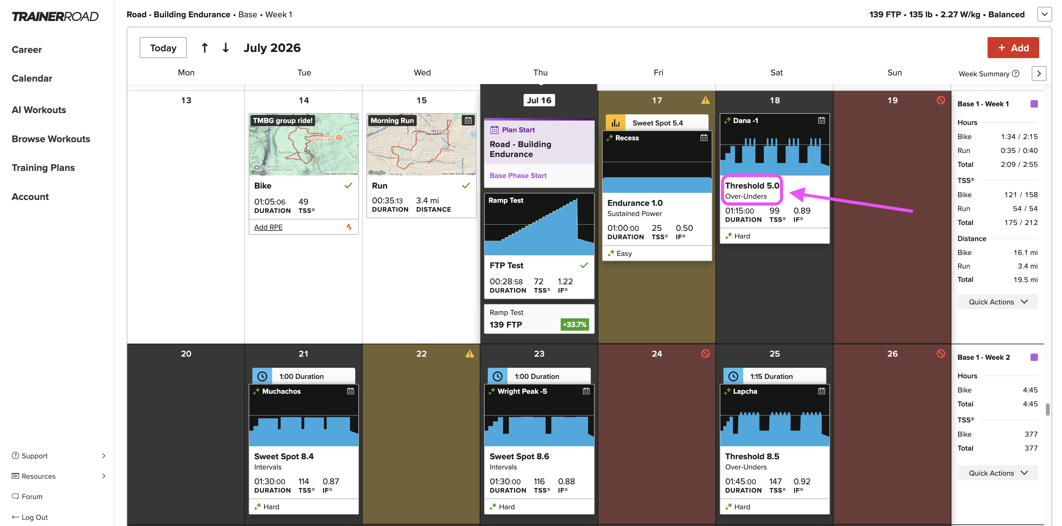

The primary Workout Level for a workout is displayed on the workout profile alongside other workout information such as duration, TSS, and IF. You will see the workout level on all TrainerRoad workouts:
Screenshot 2026-07-16 at 3.09.40 PM.png Workout Levels on the Calendar

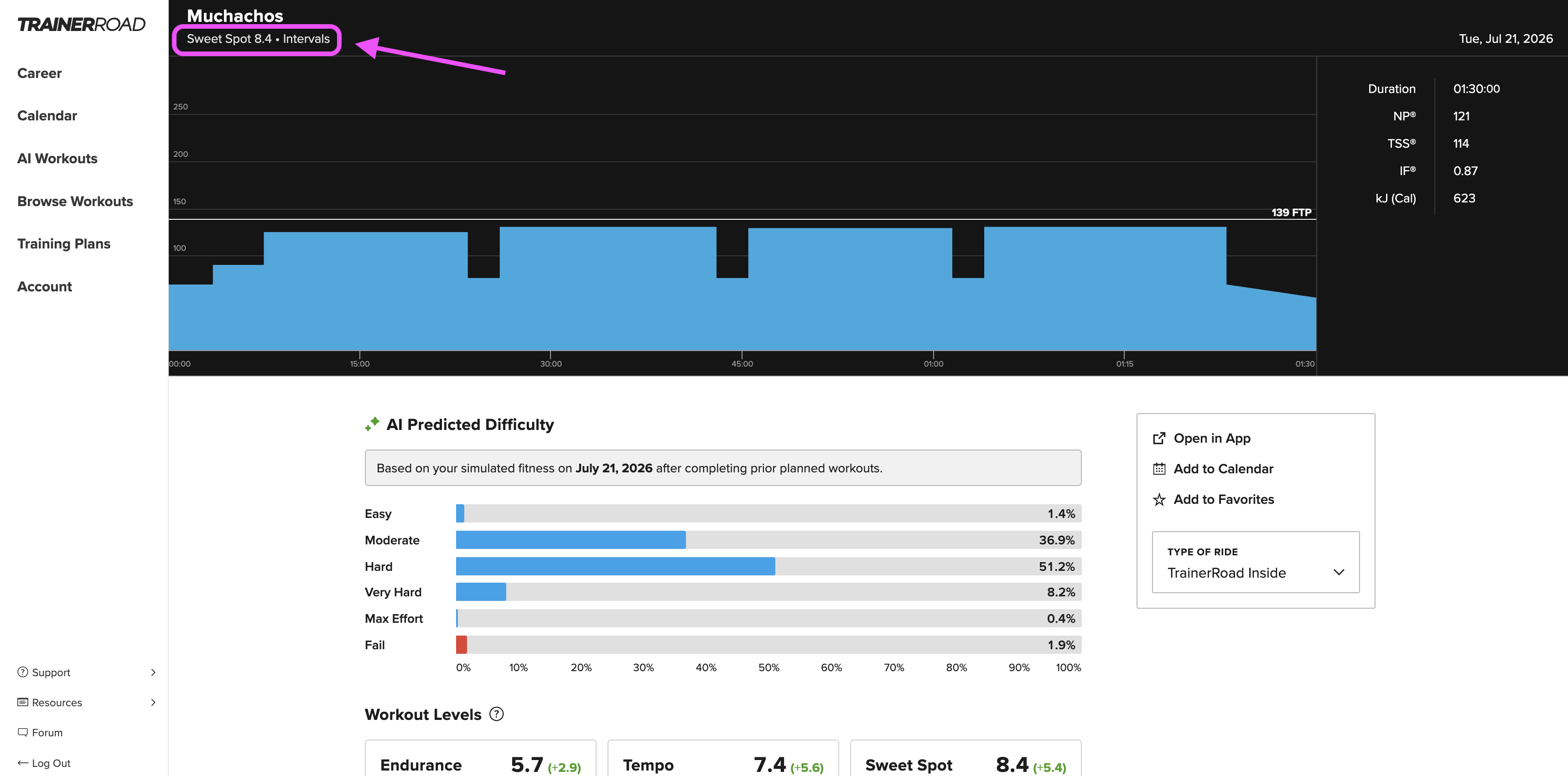

You will also see a workouts primary Workout Level in the upper left hand corner below the title of the workout when viewing an individual workout:

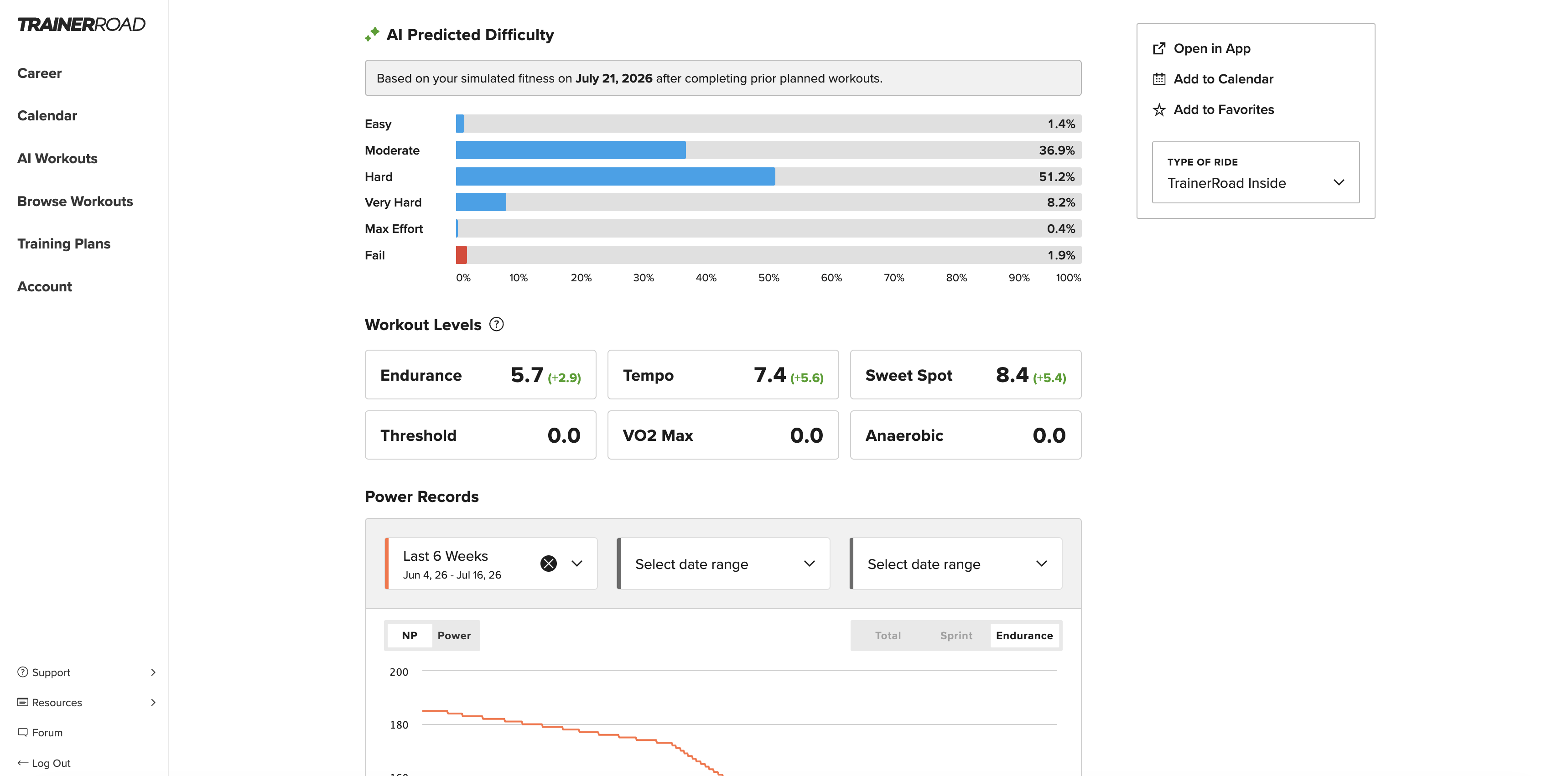

When viewing a TrainerRoad workout you will also see the other Workout Levels targeted in any given workout in the Workout Levels chart below AI Predicted Difficulty. These levels show the performance targets for that particular workout relative to your current FTP:
