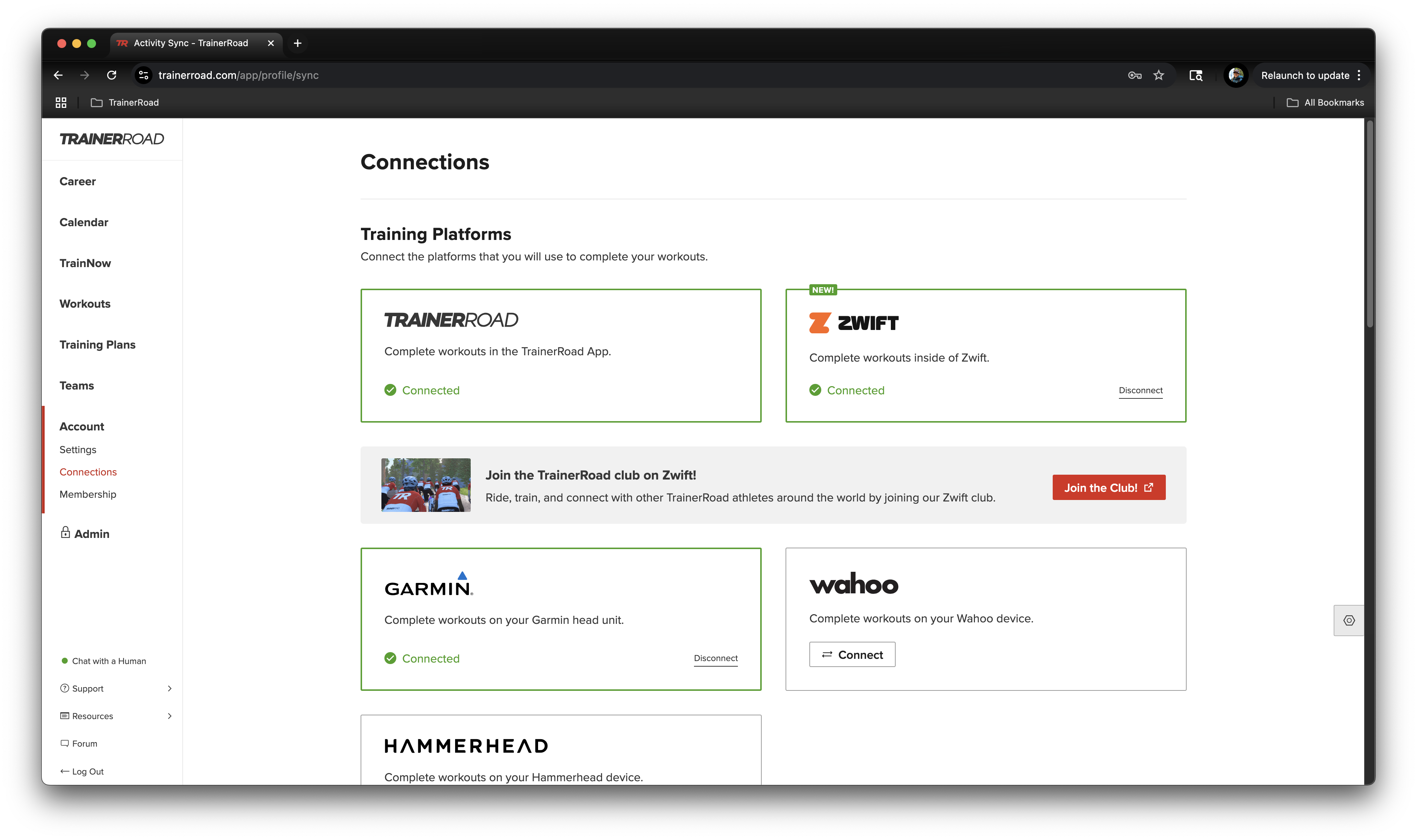

Before You Start
Check that your accounts are currently connected on the TrainerRoad website in Account > Connections. You can check that your accounts are synced to TrainerRoad here: Connections

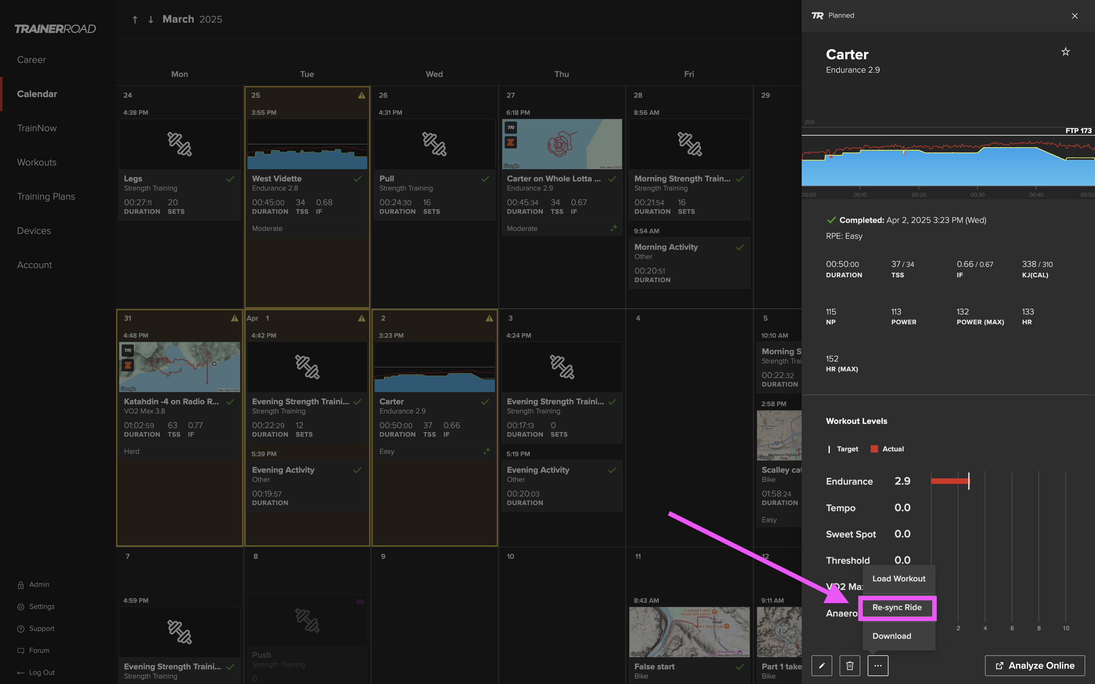

If your ride hasn't synced from the app to the website go ahead and follow these steps:
  1. Open the app that you completed the ride in (While your device has a secure internet connection!)
  2. Click on the completed ride
  3. Select the three dots ... in the bottom corner of the ride profile
  4. From the menu select Re-sync Ride to manually push the ride to the website

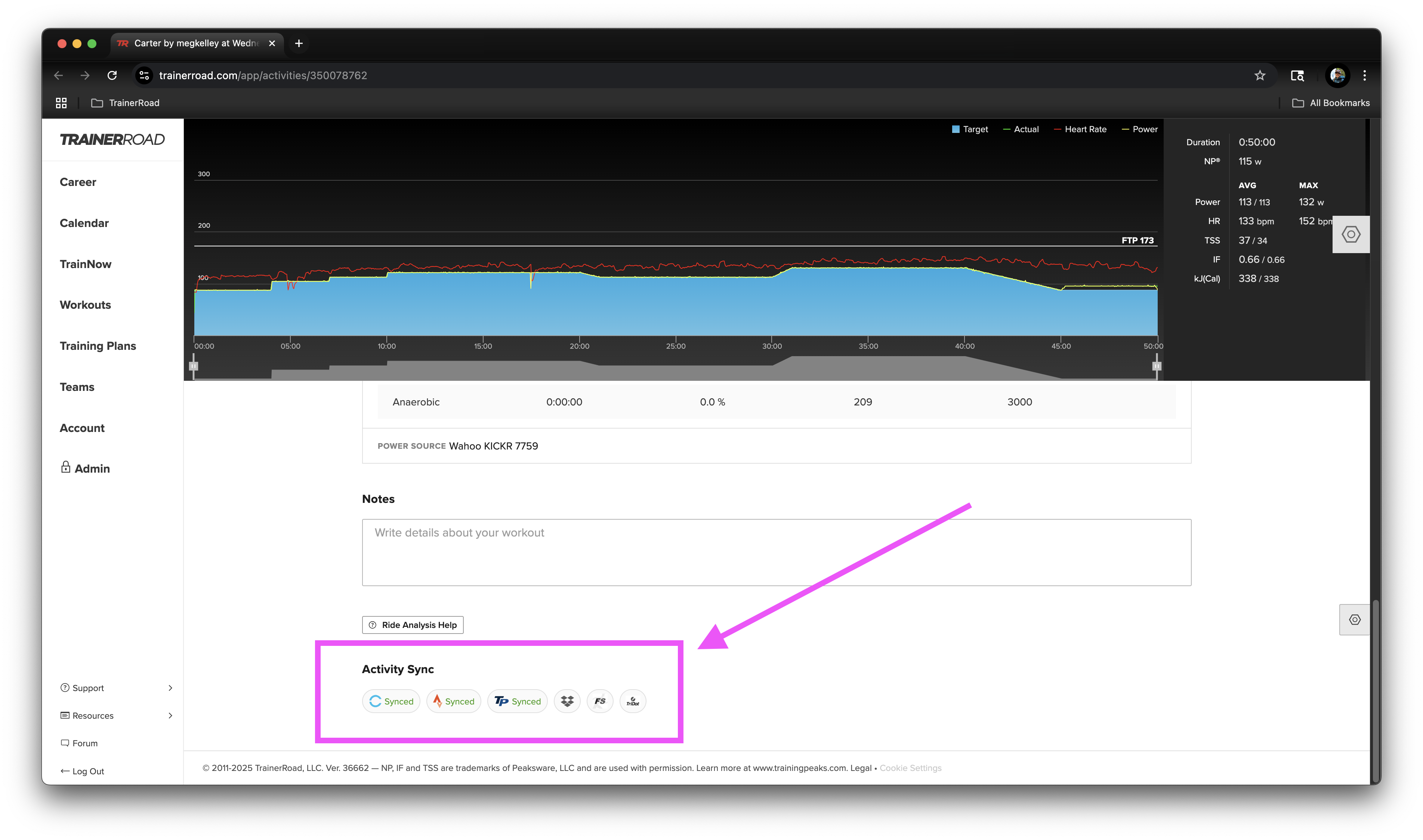

2. Manually trigger sync
If your workout has synced to the website but you aren't seeing it in your connected platform it might just need a manual push! You can manually trigger a sync from the TrainerRoad website. To do this follow these steps:
  1. Open the ride on the TrainerRoad website
  2. Scroll to the bottom of the page to the Activity Sync section.
  3. Click the icon of the platform you are manually triggering a sync with (You can do this even if the ride says it has synced to that platform) Screen Shot 2025-06-23 at 11.12.14 AM.png
  4. Rides usually sync within a few minutes, but occasional delays can occur. Wait at least 10 minutes before trying another manual sync, if your ride doesn't show!

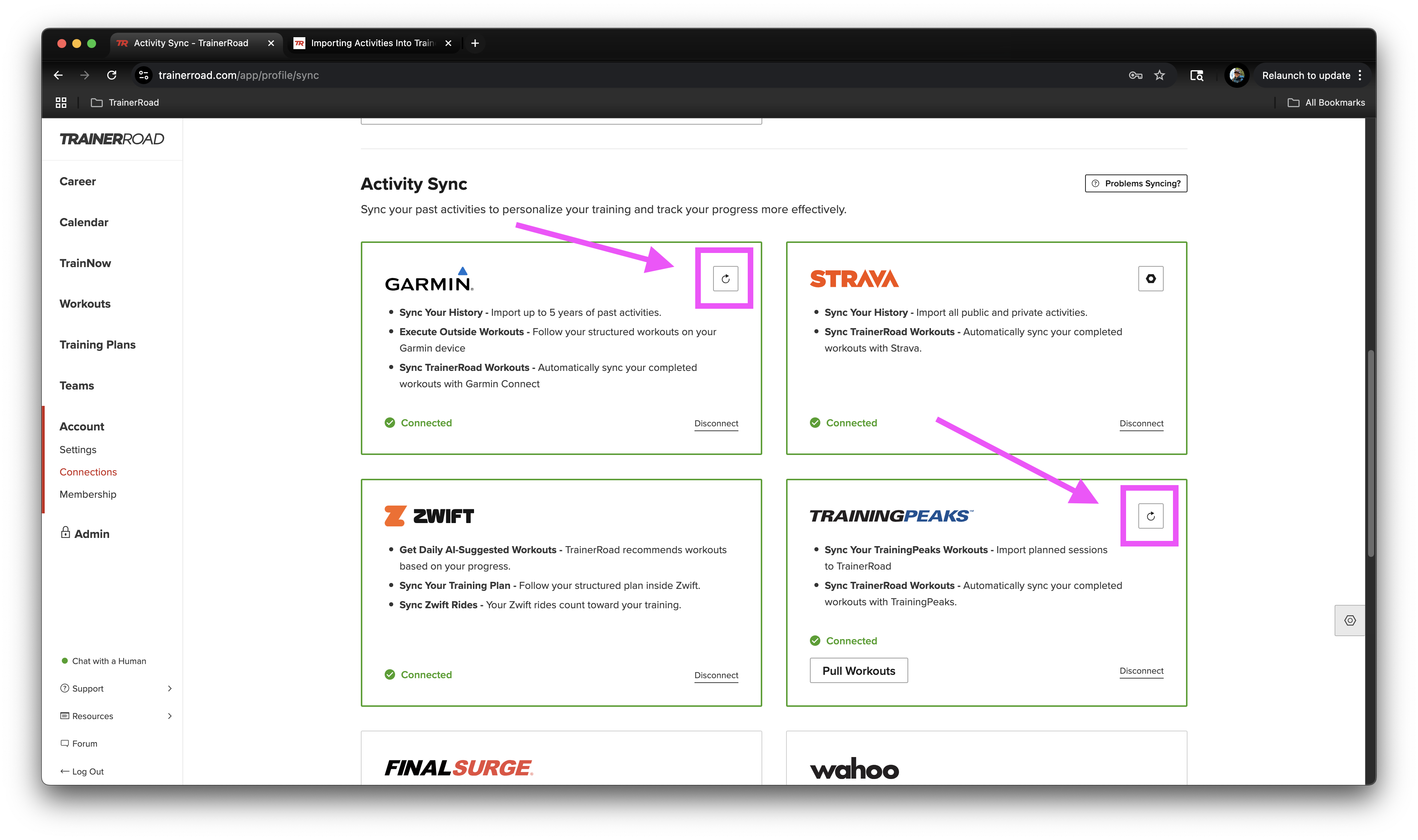

4. Refresh connection with the platform
If you are expecting a ride or file from Garmin Connect or TrainingPeaks you can manually refresh the connection from the TrainerRoad connection page. To do this follow these steps:
  1. Go to Account > Connections
  2. Scroll to the connection of the platform you are refreshing
  3. Select the arrow button in the right hand corner of the connection to refresh the connection

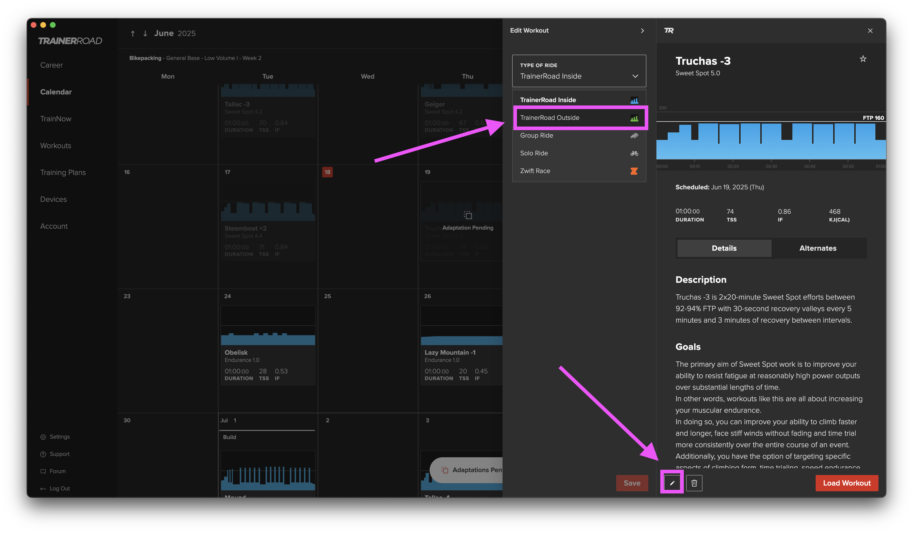

Looking to complete a scheduled TrainerRoad ride outside? If your TrainerRoad Outside Workout isn’t showing up on your Wahoo, Hammerhead, or Garmin device as a ride you can complete outside, make sure it’s marked as an Outside Workout in TrainerRoad.
1. Mark the workout as "Outside"
Only outside workouts will sync to Wahoo, Garmin Connect, and Hammerhead as files that can be completed outside. To ensure your ride is marked as an outside workout follow these steps:
  1. Navigate to the workout in your Calendar on the TrainerRoad website or app.
  2. Select the workout you would like to complete outside. Workouts that are marked as outside rides will appear green while indoor workouts will be blue.
  3. Select the pencil icon.
  4. Use the toggle to switch the workout to "Outside."
2. Move the Workout
To be eligible for sync today, the workout must be scheduled within the next two days. If your outside ride is not scheduled in the next two days and you would like to complete it today, drag and drop the workout to today or tomorrow.

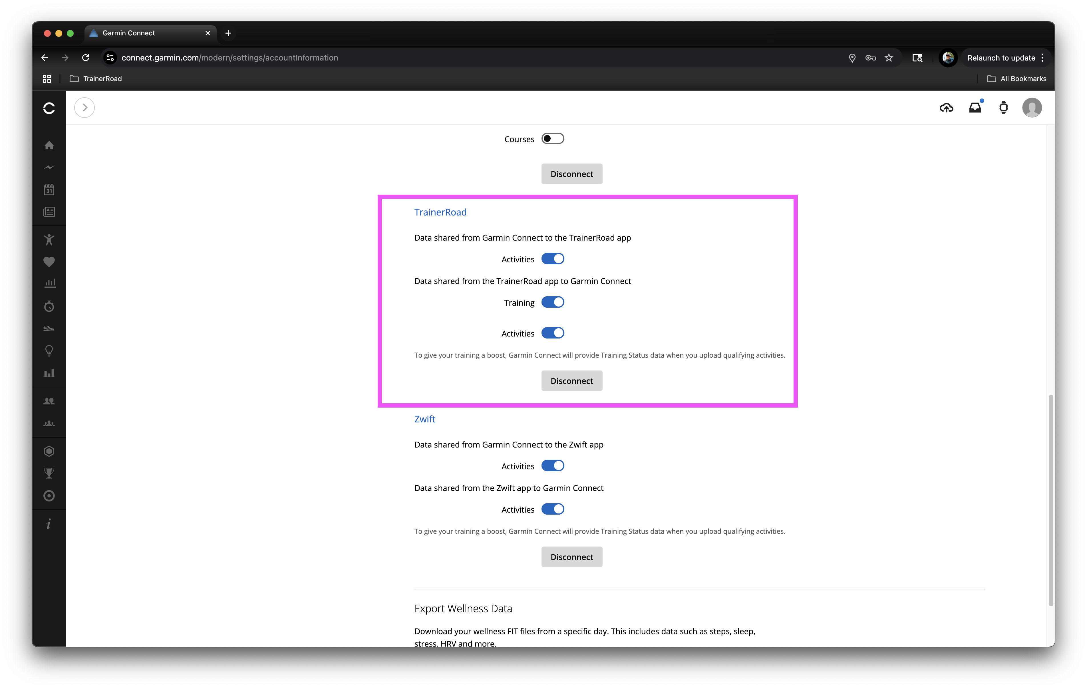

3. Check platform permissions
If you are using Garmin Connect or Hammerhead you can login to your account to verify that you have all the necessary permissions enabled for the platform you are syncing to. When you open up your account settings make sure all available options are enabled for TrainerRoad.
