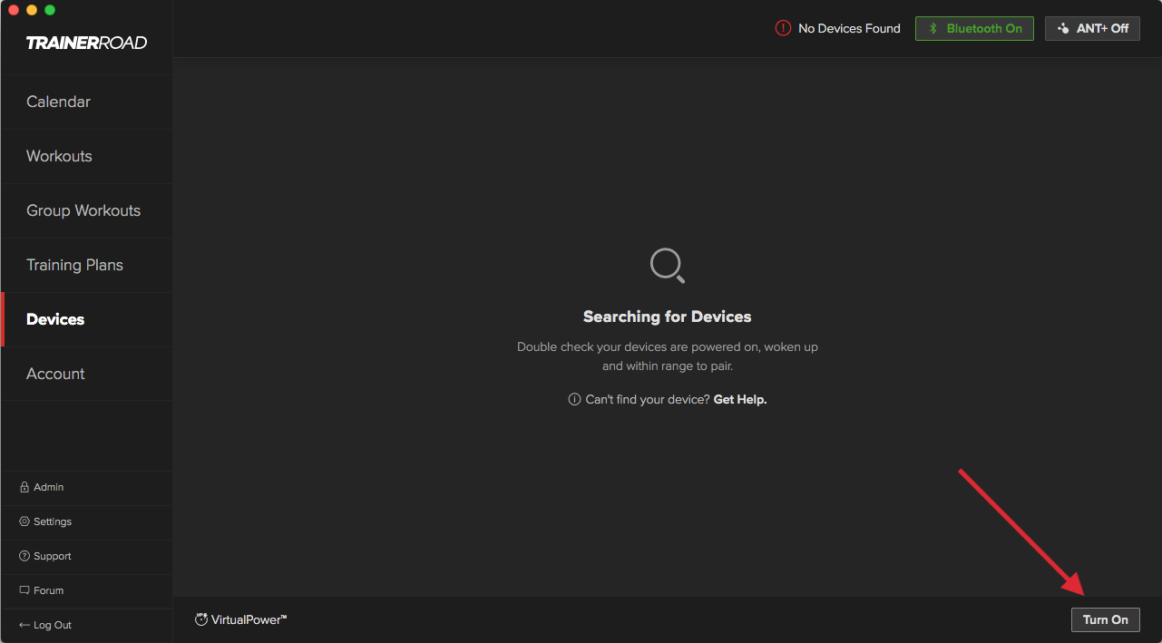

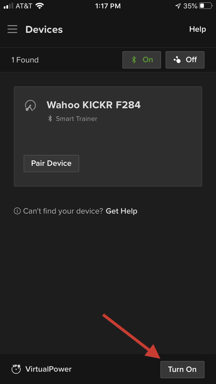

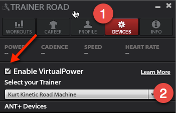

VirtualPower converts speed on the trainer into power.  For that to happen, we need to make sure we're getting speed readings from your device.
  1. Make sure you have an ANT+ or Bluetooth Smart speed or speed/cadence sensor paired under the devices tab in the desktop software. You can get our software here: www.trainerroad.com/install
  2. Make sure your speed sensor is "awake" when pairing. So make sure the back wheel is spinning when you're trying to pair.
  3. Make sure you have a magnet on your rear wheel to register speed. Make sure that the magnet is close enough to the speed sensor to register.  This is the number one problem.
    Speed sensor magnets should pass close enough to the sensor to trigger a revolution, but not so close as to touch the sensor when it passes.  In other words make sure there is a small gap.

  5. Under the devices tab make sure "Power Source" is set to your trainer.

  1. Make sure VirtualPower is not enabled.
