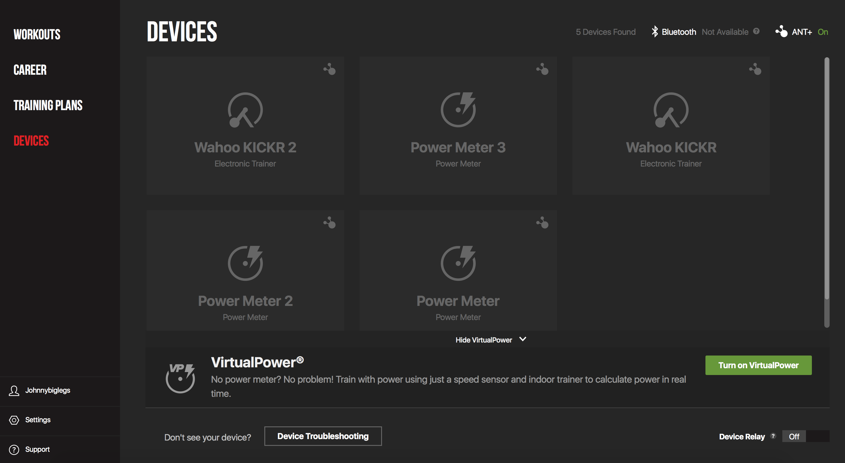

Follow these instructions if you're on Windows or Mac:

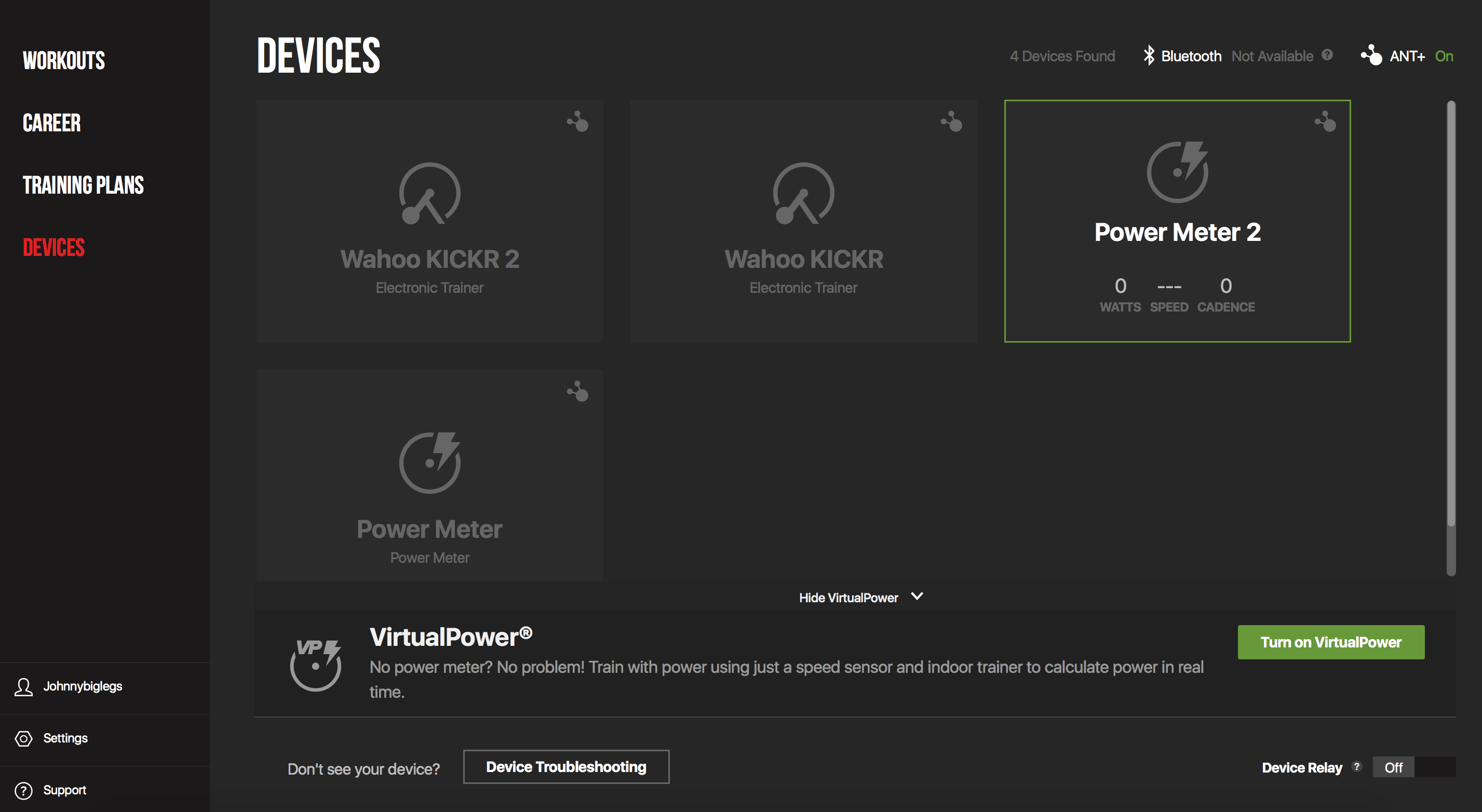

Step 1: Open the TrainerRoad app, go to the Devices section, and confirm ANT+ displays as "On" (top, right-hand corner of the window).
Step 2: Wake up the power meter by pedaling, hover over the Power Meter tile, and click to begin pairing.
Pairing is complete when your power meter is bordered in green.

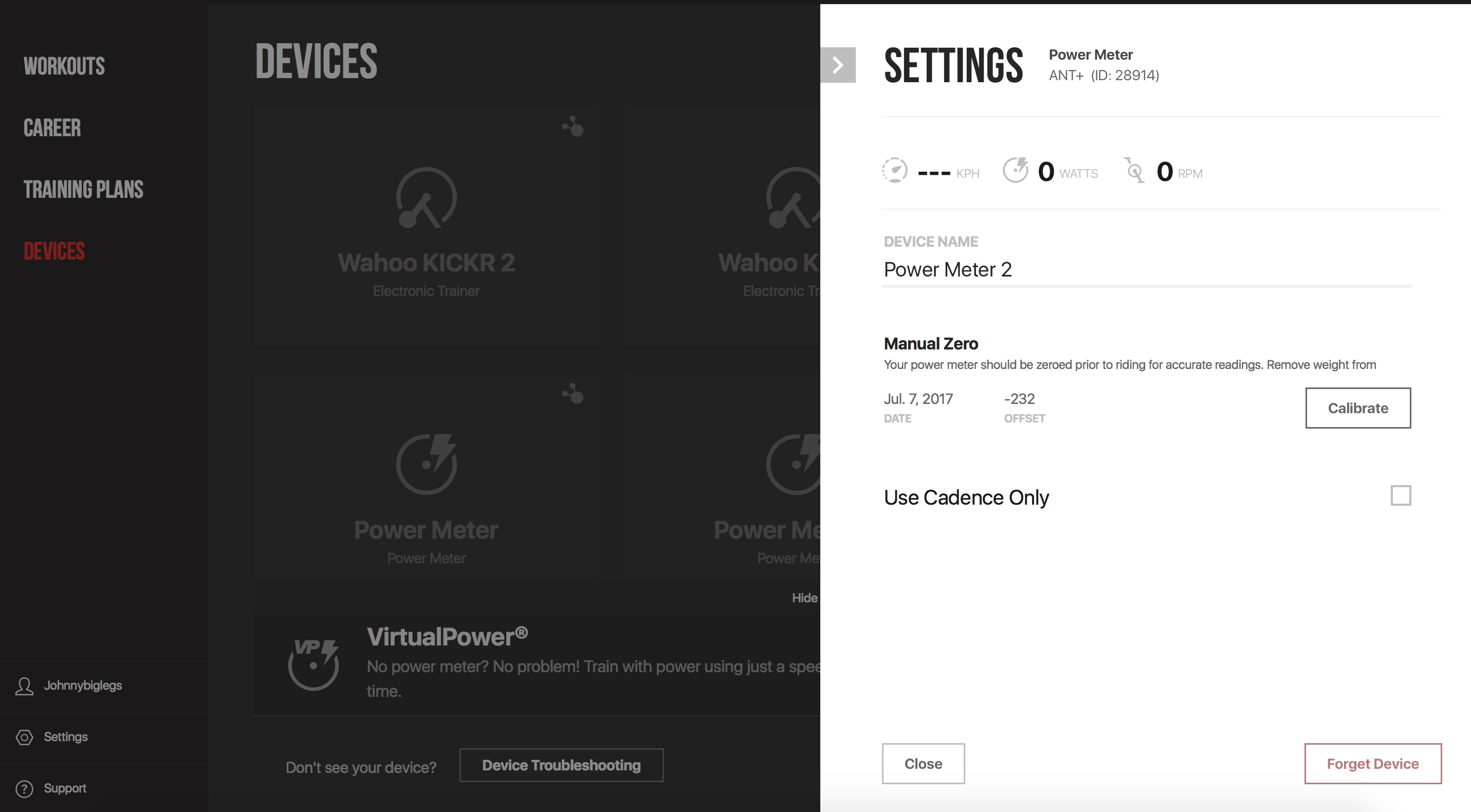

Step 3: After it's paired, click on the power meter tile again to open the Device Settings menu. From here, select "Calibrate".
You're ready to ride after you calibrate.

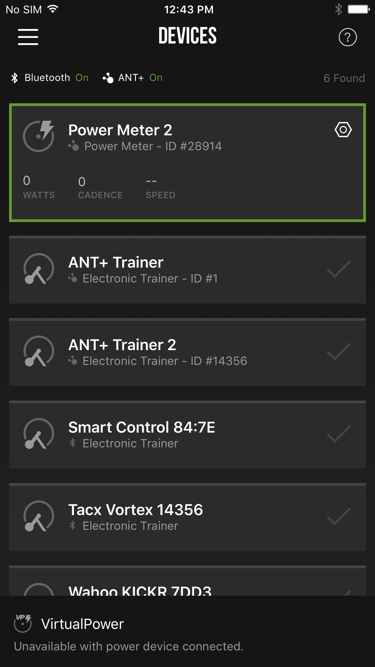

Pairing your PowerTap (Mobile)
Follow these instructions if you're on iOS or Android:
Step 1: Open the TrainerRoad app, navigate to the Devices section, and make sure ANT+ displays as "On".
Step 2: Wake up the power meter by pedaling, and tap on the Power Meter.
The power meter is paired when it's bordered in green.

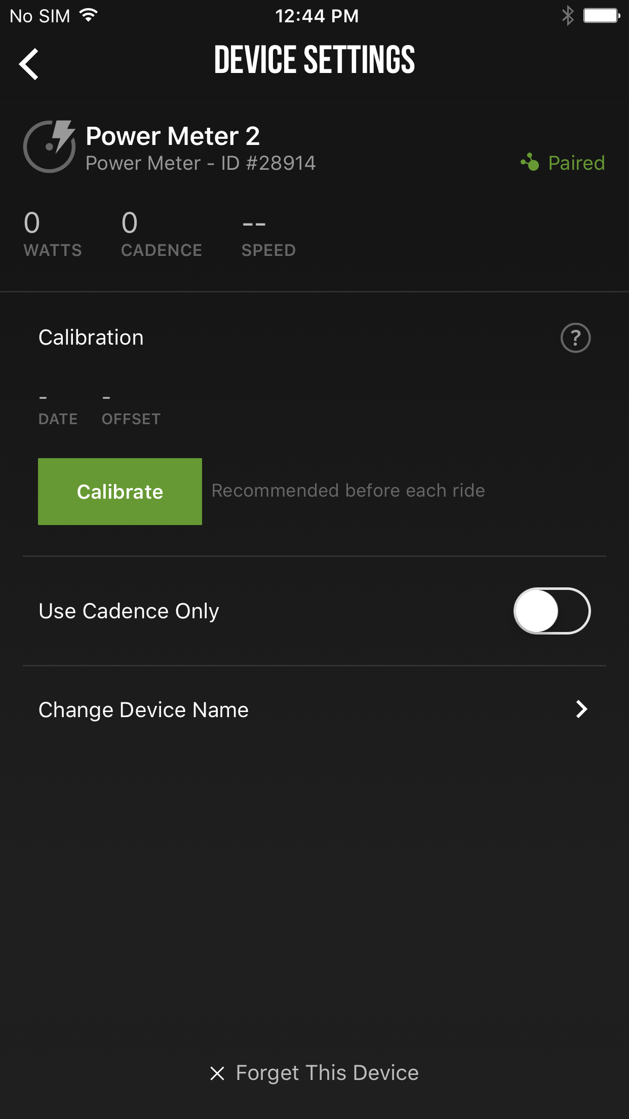

Step 3: Tap on the power meter again to drill into the device settings.
Step 4: Tap "Calibrate".
