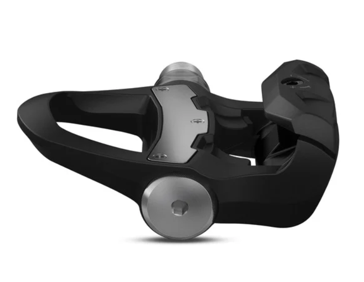

The Garmin Vector Power-Meter Pedals measure a rider's power directly from the pedals. TrainerRoad will collect and display power data from the Garmin Vector using ANT+ or Bluetooth.
Only Garmin Vector 3 and 3S can broadcast data via ANT+ and Bluetooth. Earlier models use ANT+ only.
How Vectors Measure Power on TrainerRoad
If using a single-sided version of the Vector power meter pedals (the "S" in Vector S stands for "single-sided"), power is only derived from the left side. That power is doubled and displayed as a complete reading.
Keep in mind the single-leg measurement style of this power meter when considering single-leg (ILT) drills. Since power is only derived from the left pedal, riders will not get any readings during right-leg-only intervals. If you're using your Vectors to measure cadence, the workout will automatically pause during right-leg-only drills if you have the autoplay/pause feature turned on.
If you own dual-sided Vectors (Vectors without the S nomenclature) and connect them via ANT+ or Bluetooth Smart, your power is measured on each side, added together, and sent to TrainerRoad in a single power package.

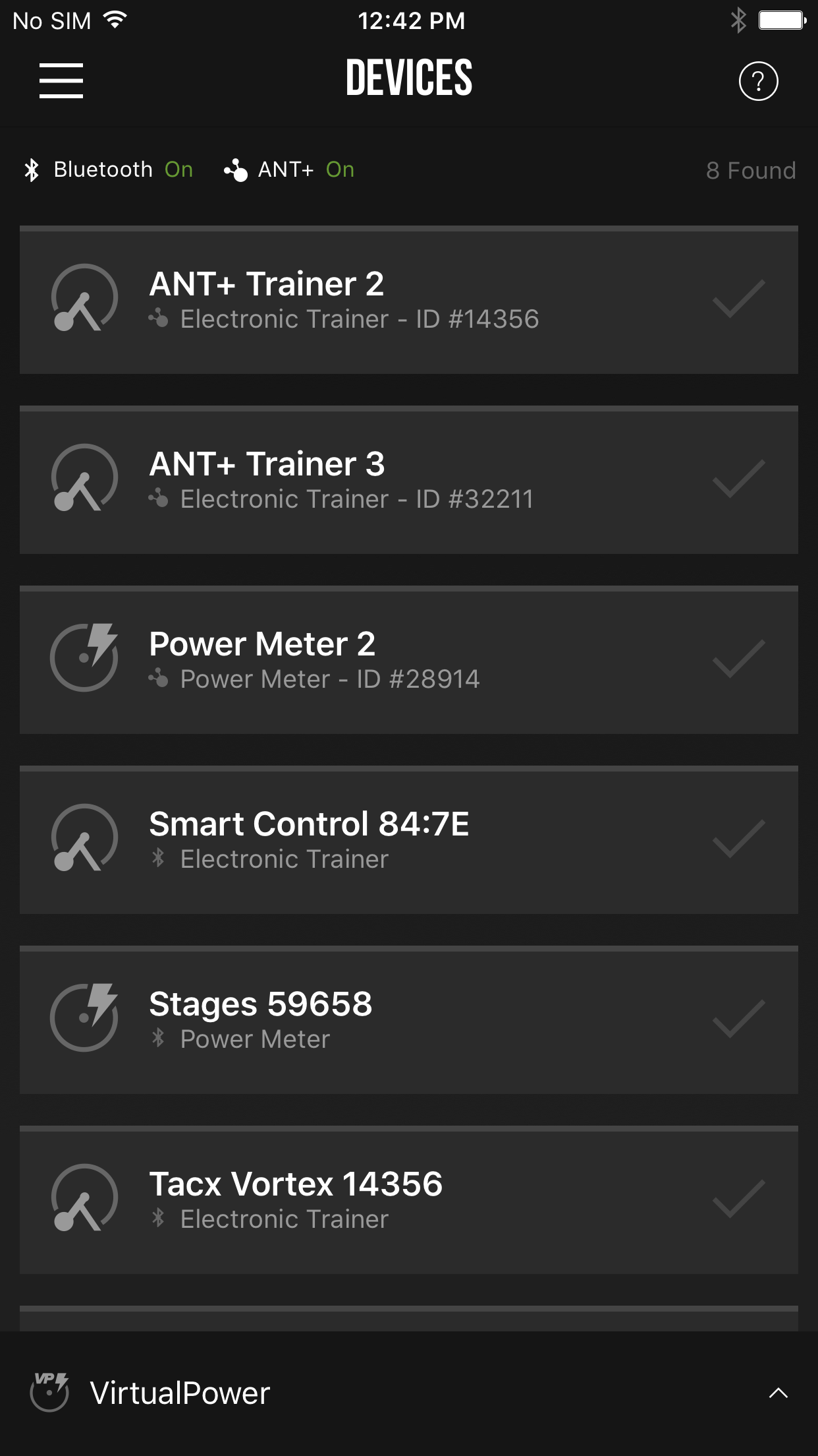

How to Pair Your Garmin Vector with TrainerRoad (Mobile)

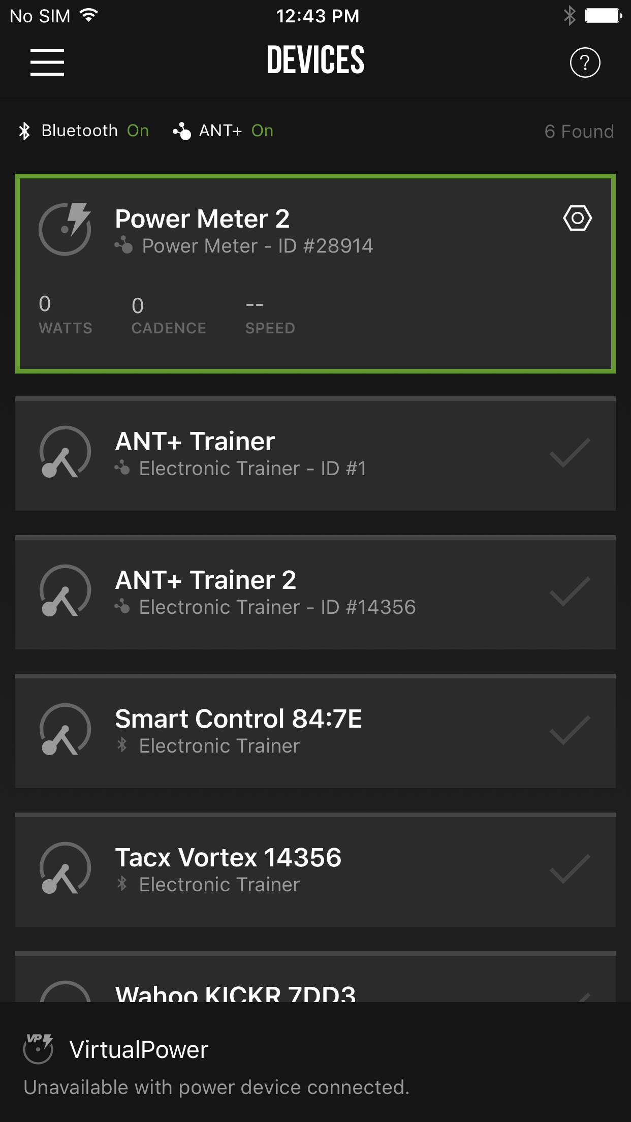

Step 1: Navigate to the Devices tab and make sure ANT+ or Bluetooth is turned on.
Step 2: Wake up the power meter by pedaling, and tap on the Power Meter.
The power meter is paired when it's bordered in green.

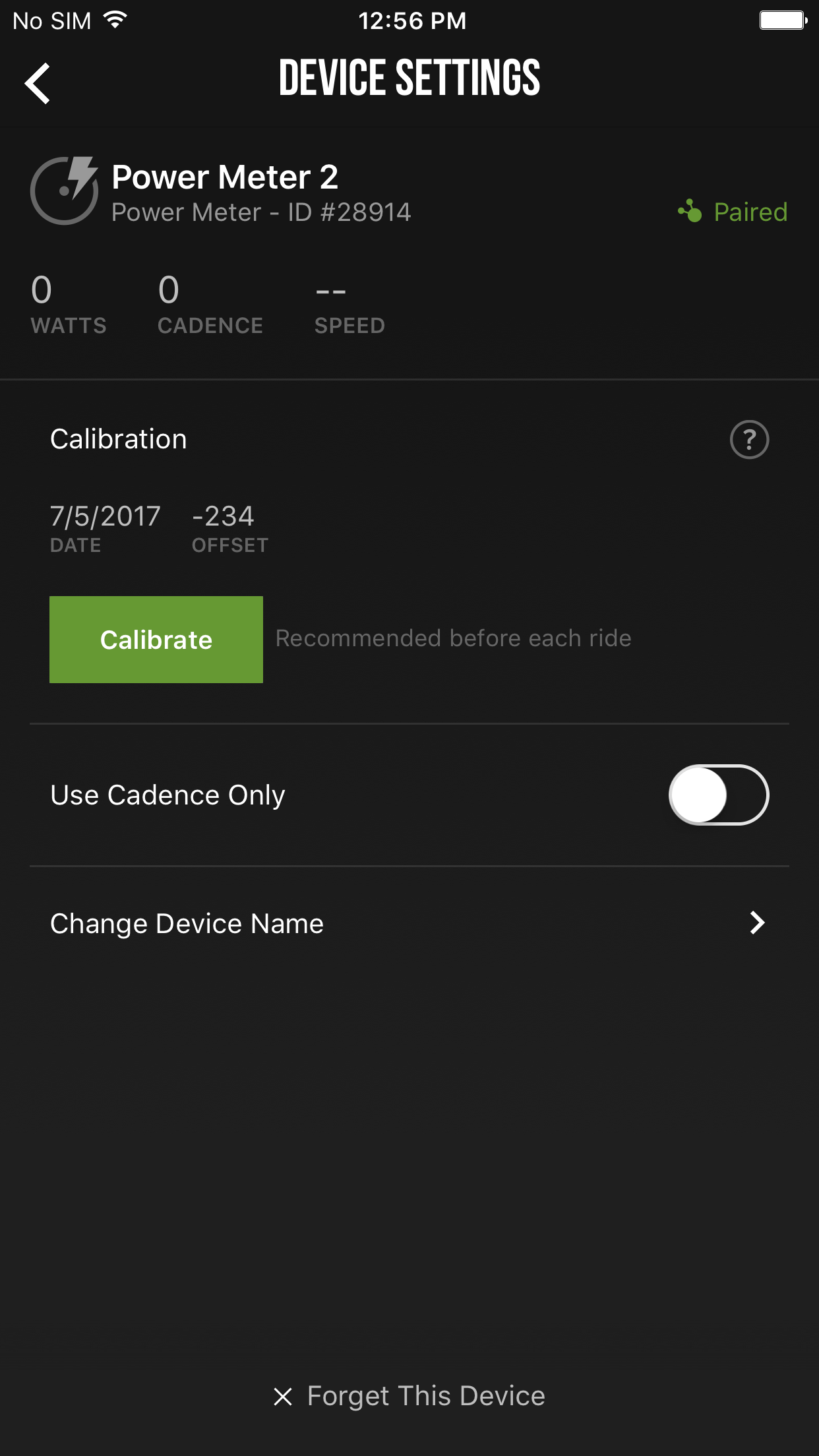

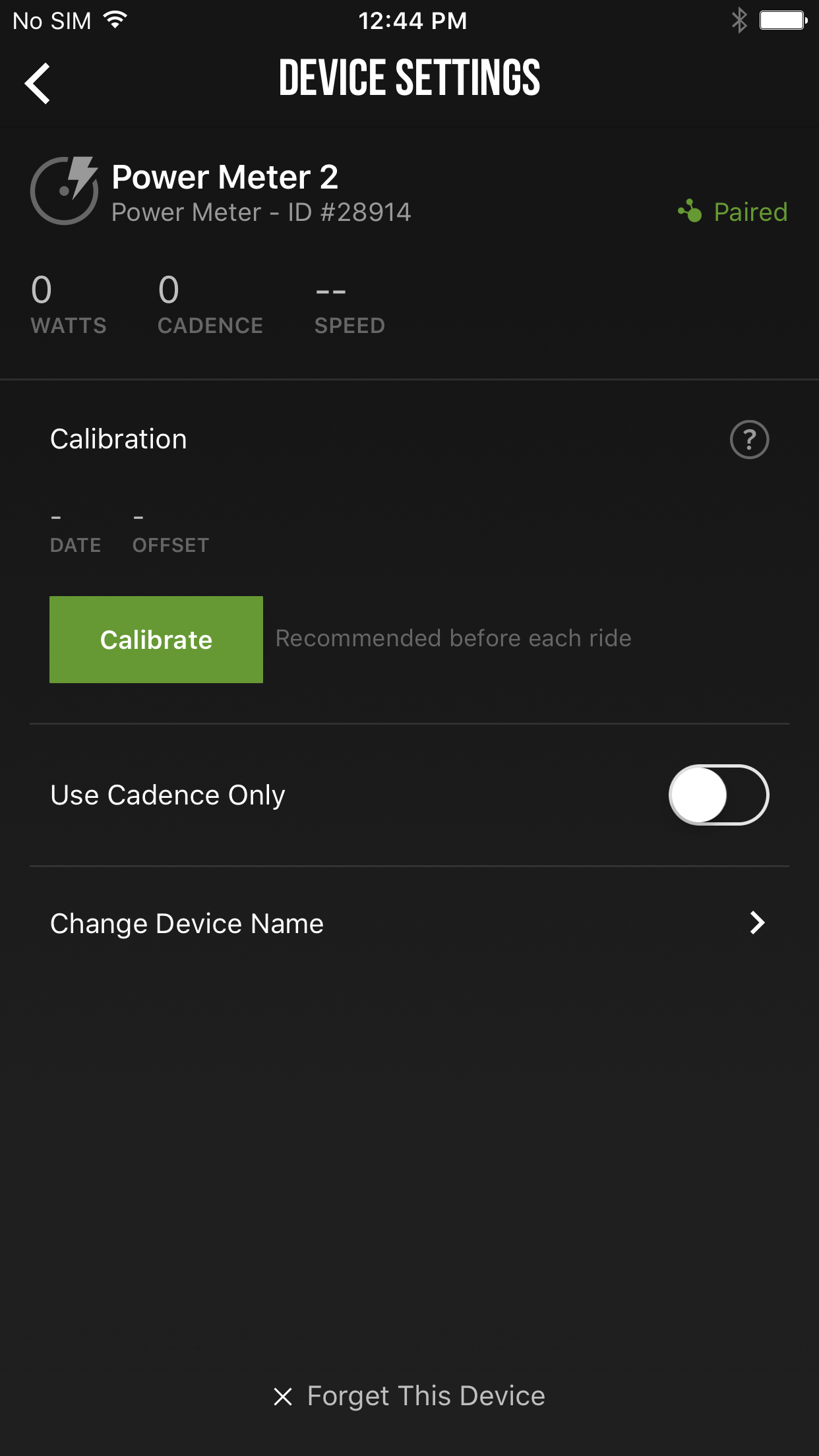

Step 3: Tap on the power meter again to drill into the device settings.
Step 4: Tap "Calibrate".
You're ready to ride after you calibrate.

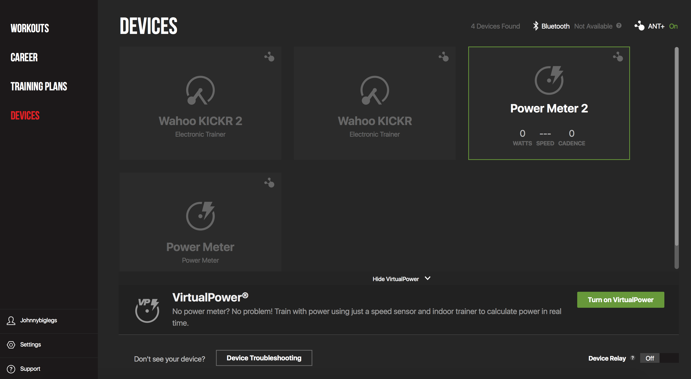

How to Pair Your Garmin Vector with TrainerRoad (Desktop)

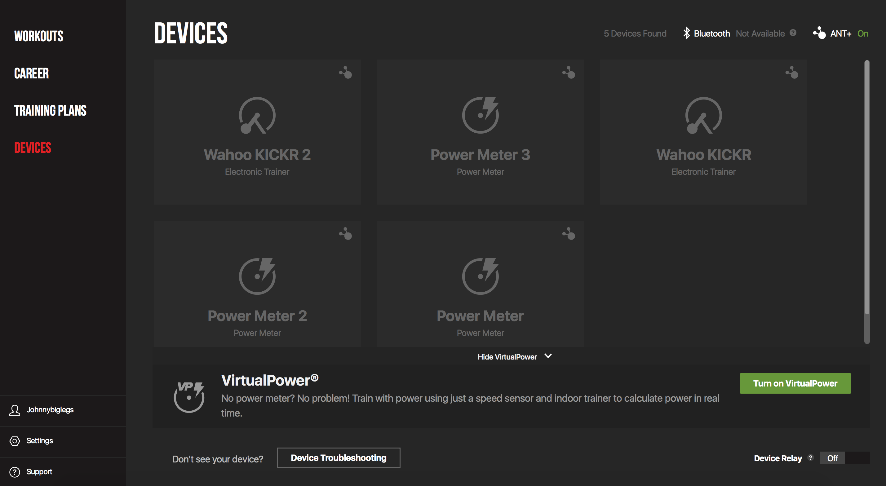

Step 1: Open the TrainerRoad app, go to the Devices section, and confirm ANT+ or Bluetooth displays as "On" (top, right-hand corner of the window).
Step 2: Wake up the power meter by pedaling, hover over the Power Meter tile, and click to begin pairing.
Pairing is complete when your power meter is bordered in green.

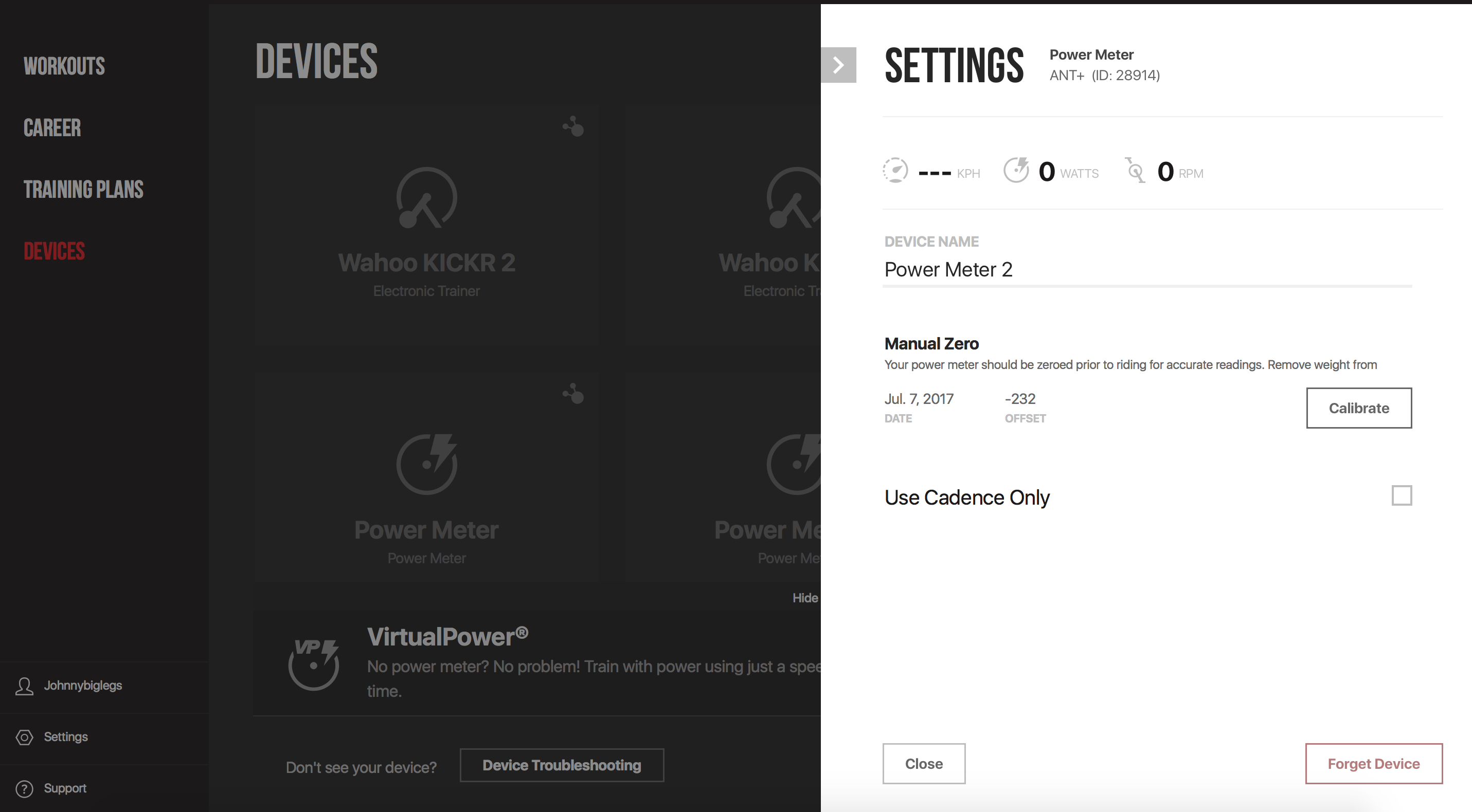

Step 3: After it's paired, click on the power meter tile again to open the Device Settings menu. From here, select "Calibrate".

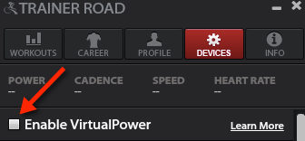

Step 5: Make sure that Enable VirtualPower is UN-checked.
If VirtualPower is enabled, TrainerRoad will ignore readings from power meters and derive power from speed readings. Make sure to un-check the box pictured below. You're now ready to ride!
