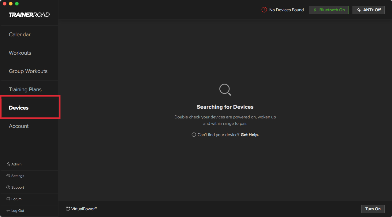

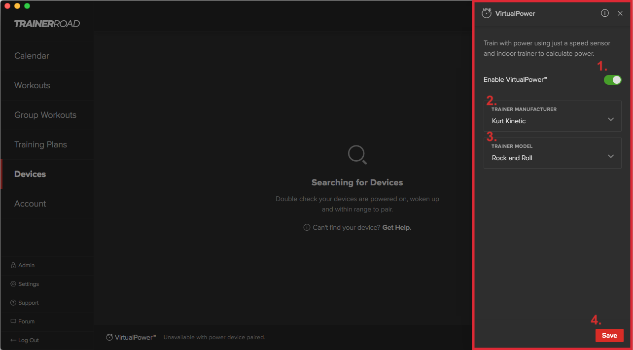

Step 1: Open the TrainerRoad app, and go to the Devices section.

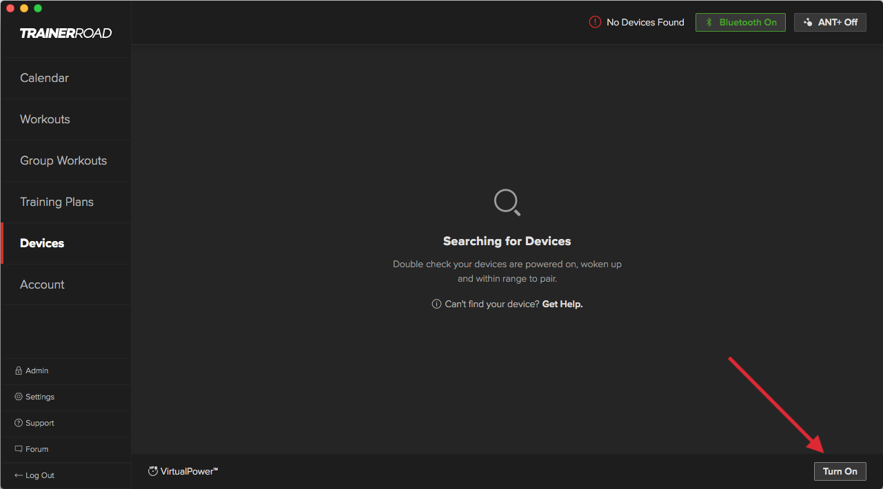

Step 2: Select Turn On in the VirtualPower section at the bottom of the window.
Step 3: Enable VirtualPower, select your trainer manufacturer/model, and select Save.
Note: Make sure your trainer's resistance setting is set to the same level as your VirtualPower selection. If you change the setting, you'll need to change the selection in TrainerRoad.
Note: If you don't see your trainer listed, check out this article: My Non-Smart Trainer Is Not Listed — Can I Still Use TrainerRoad?

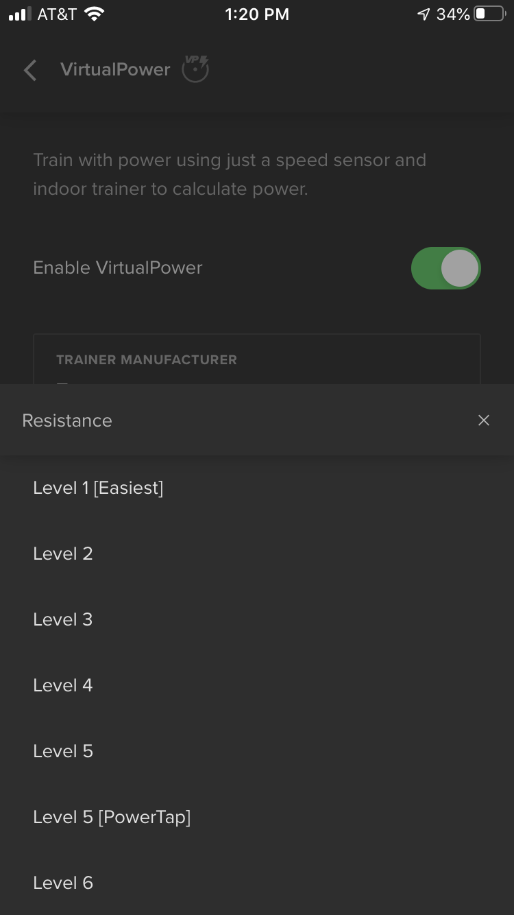

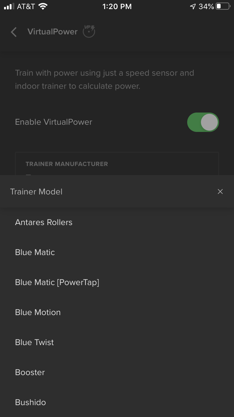

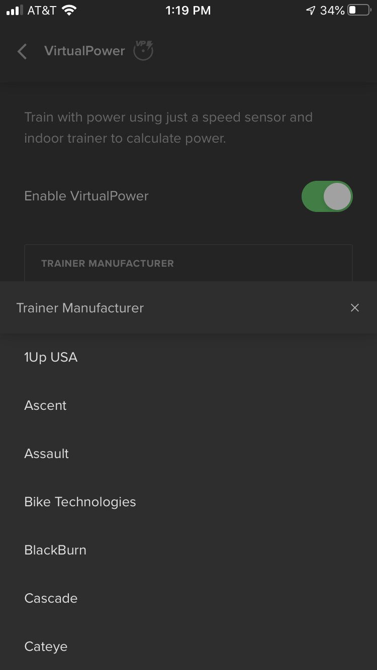

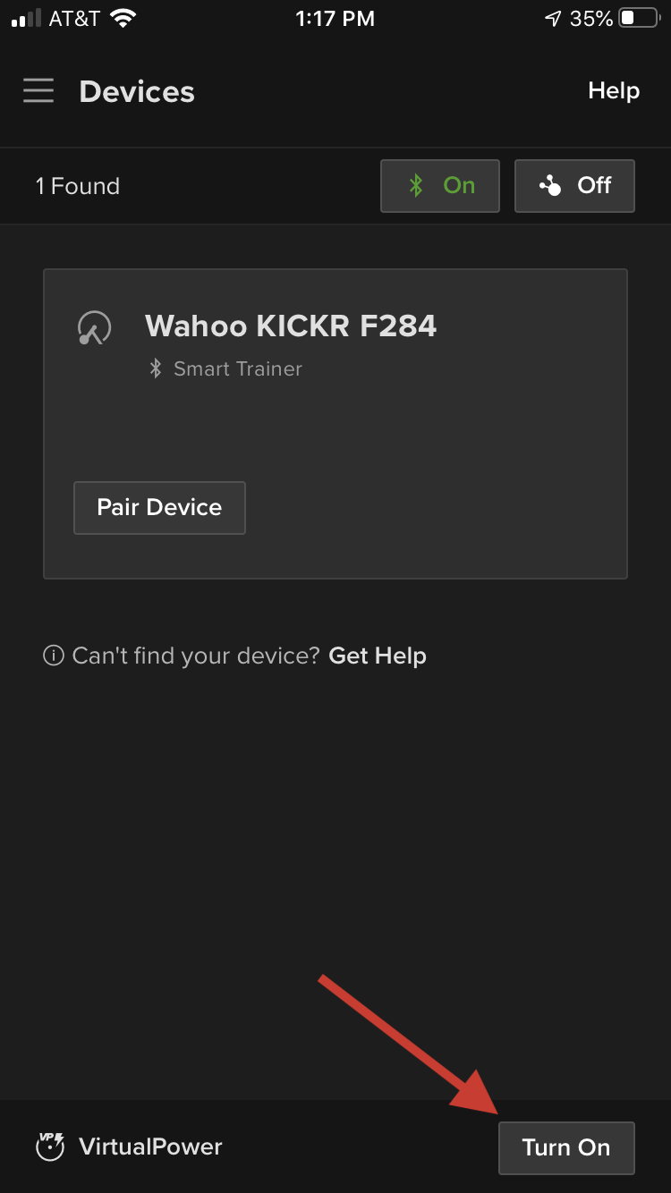

Step 1: Enter the Devices section of the app, and select Turn On next to VirtualPower.
Step 2: Select your trainer's manufacturer
Step 3: Tap on 'Model' and find your trainer from the list.
Step 4: Select the correct resistance level (if applicable)
