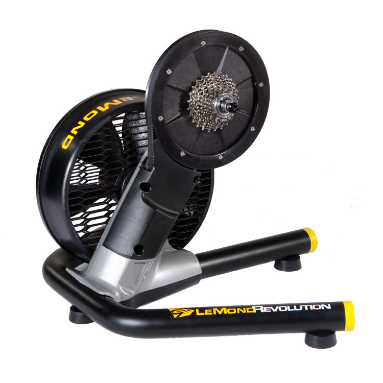

You can get consistent VirtualPower data with the Lemond Revolution without using a Power pilot. To do this, you have to attach a speed sensor to your non-drive side chainstay next to the flywheel. See the picture below.
The Lemond Revolution's flywheel has a built-in magnet that can be used to trigger the speed sensor.
