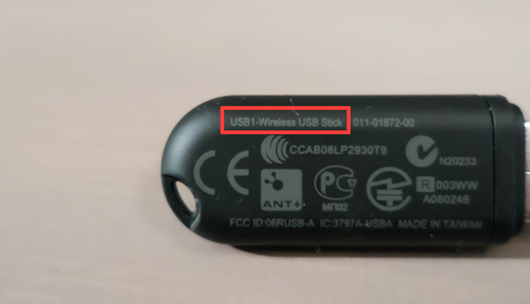

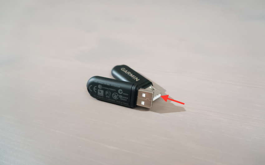

You can tell if your ANT+ stick is a USB1 model in two ways:
1. The stick will be labeled "USB1-Wireless USB Stick" on the reverse side of the stick.
2. If you have a Garmin-manufactured stick, the inner portion of the plug-in point will be white.
