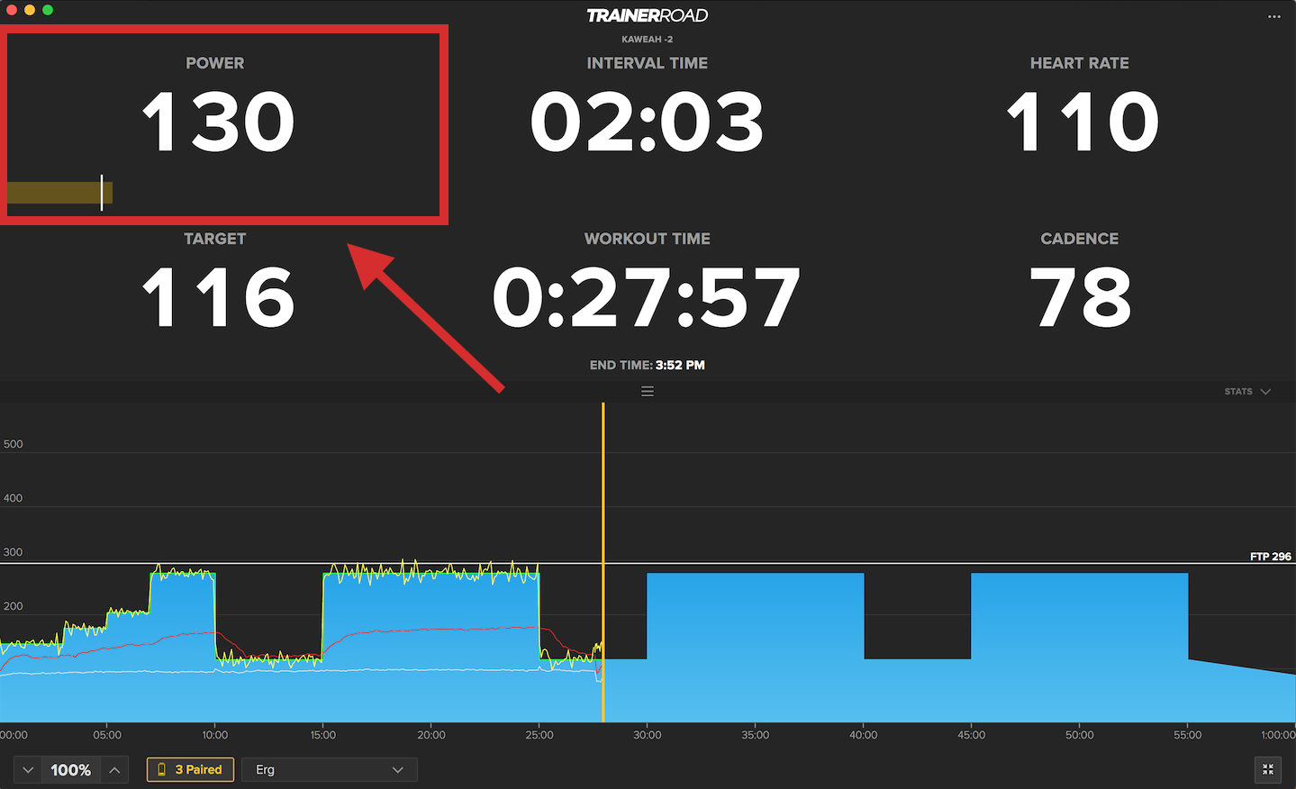

Because power is an inherently sensitive measurement, it can appear that you're not maintaining target power during your workout. In reality, it's likely your average power is right on the money. To make sure athletes don't get distracted by seemingly "jumpy" power readings, we've enabled Power Smoothing.
Power Smoothing applies a rolling average of 1-30 seconds to your power data in the data field of the workout player for the interval you are currently in. You can control your Power Smoothing settings from the Settings section of the apps.
Note: Power Smoothing settings do not apply to the actual graph of your power.

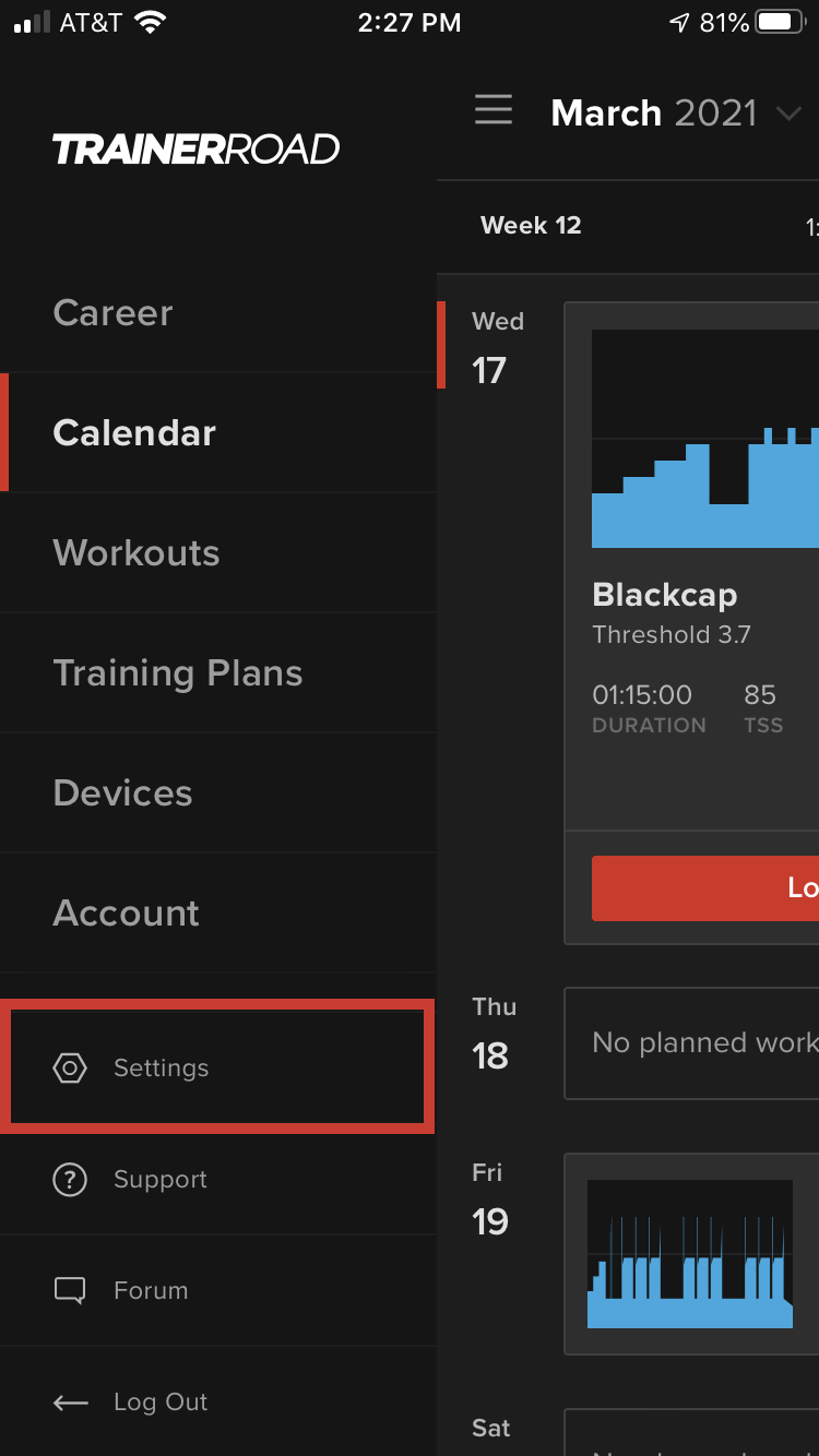

How to Enable Power Smoothing in Mobile
Step 1. Launch the TrainerRoad App
Step 2. From the navigation menu, select Settings

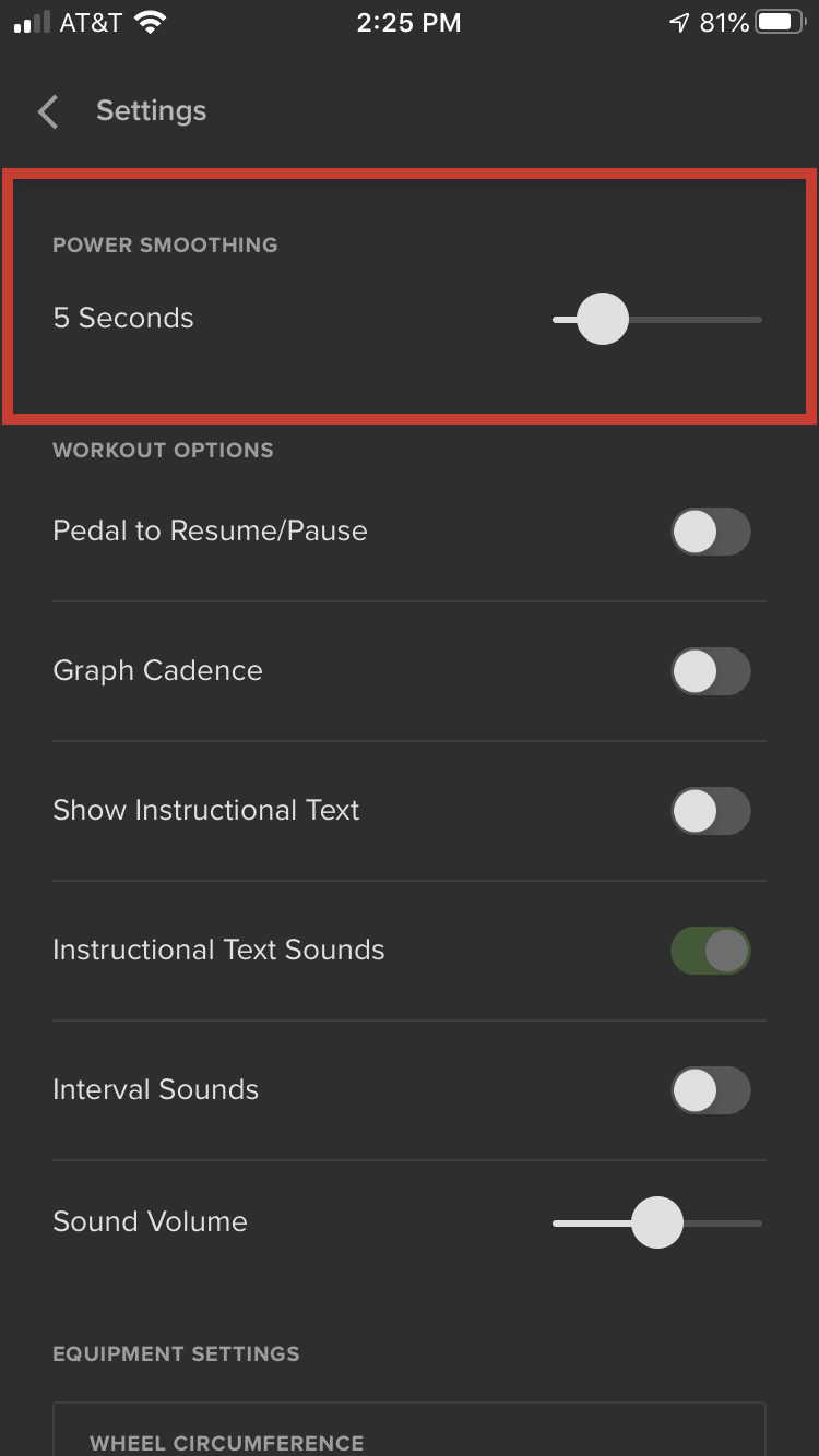

Step 3. Under the Power Smoothing section of the Settings menu, drag the slider to adjust from 0-30 seconds.

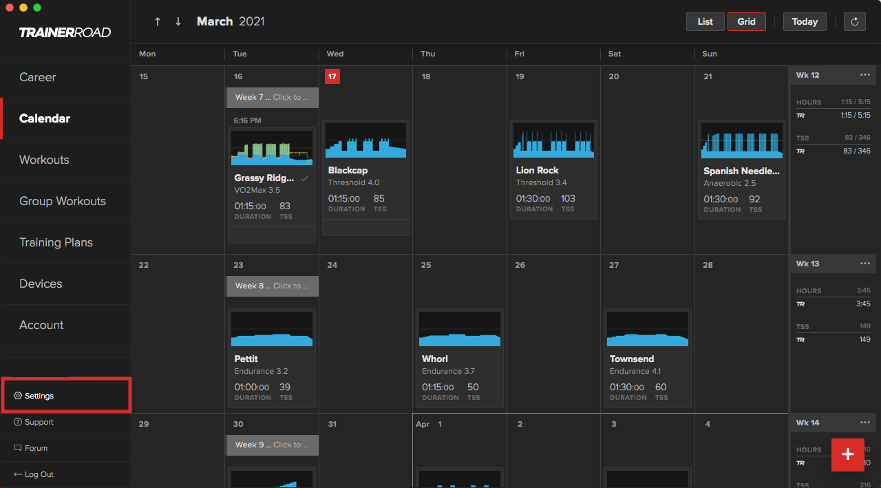

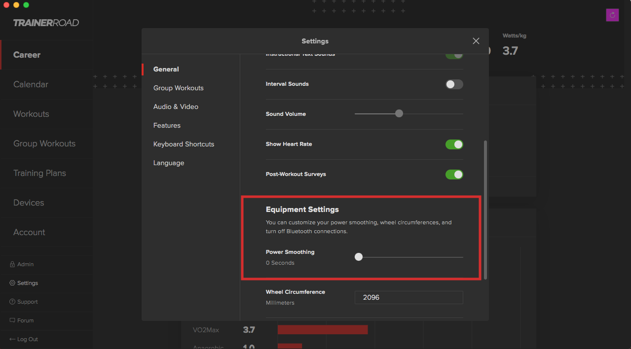

How to Enable Power Smoothing in Desktop
