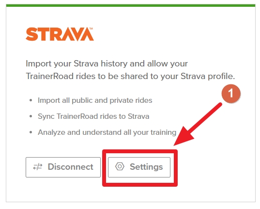

Step 3: Under Strava, select Settings. If you haven’t connected your Strava account to TrainerRoad yet follow the steps in this article to connect your Strava account to TrainerRoad first: Strava

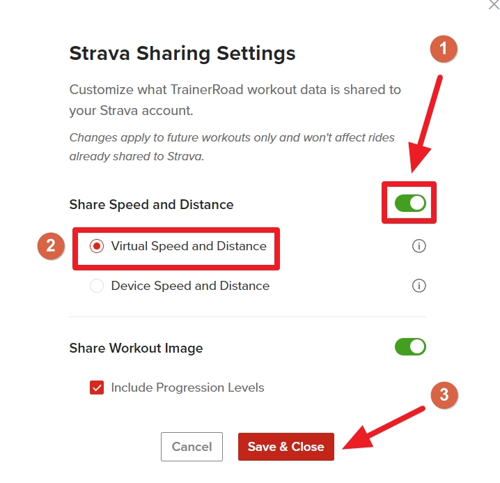

Step 4: In the Strava Sharing Settings make sure ‘Share Speed and Distance’ is enabled and that ‘Virtual Speed and Distance’ is selected:
Step 5: Select ‘Save and Close’ to finish enabling Virtual Speed and Distance.

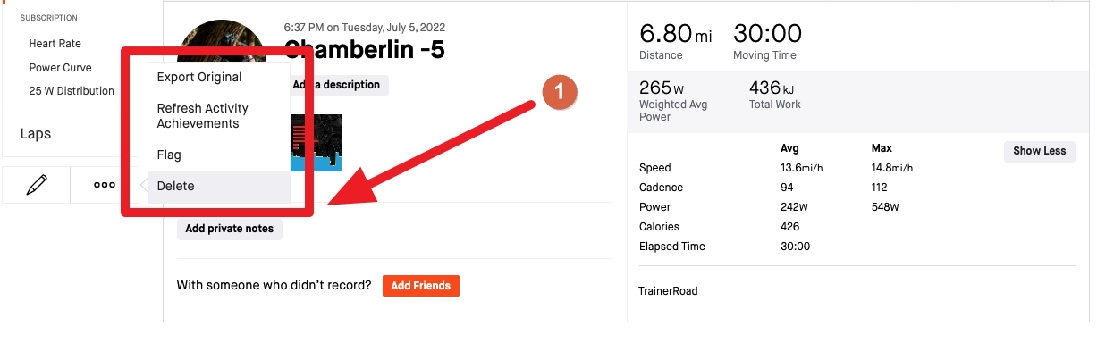

Step 4: Open the workout in Strava that you would like to re-sync with Virtual Speed and Distance data.
Step 5: Delete this workout in Strava by selecting 'Delete' from the drop-down menu to the left of the workout profile.

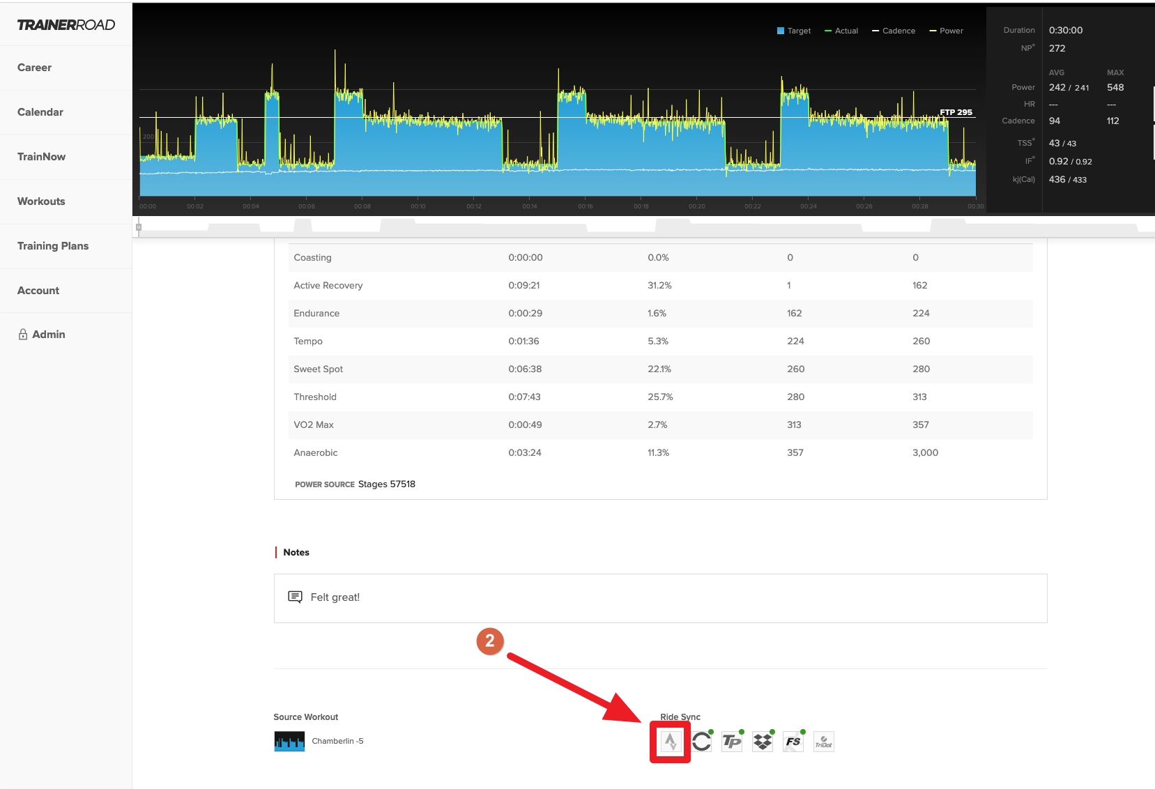

Step 6: Navigate back to the TrainerRoad web page and open up the workout you'd like to re-sync.
Step 7: Click the Strava icon in the Activity Sync section of the workout to manually re-sync this ride to Strava.

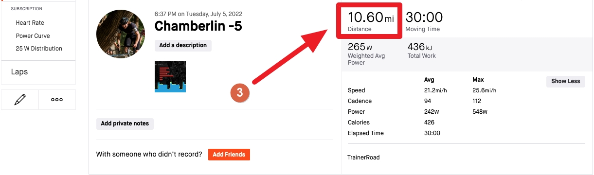

Step 8: Open the newly synced workout in Strava to view the updated Speed and Distance data.
