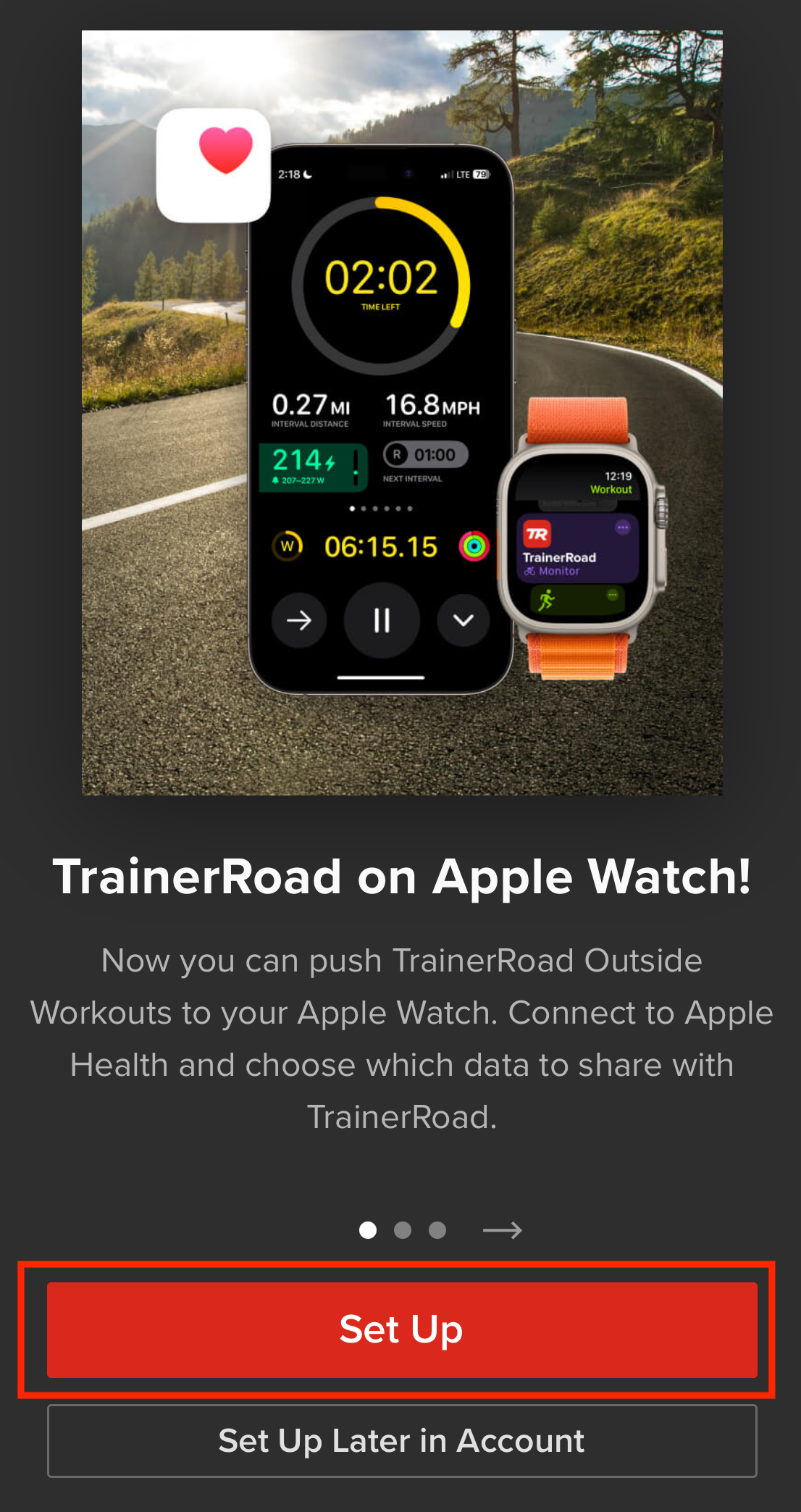

This can be done most easily from the start-up screen of your TrainerRoad app. After updating to iOS 17 and to the latest TrainerRoad app version, you'll receive a notification to get set up.
Just hit Set Up to get the process started.

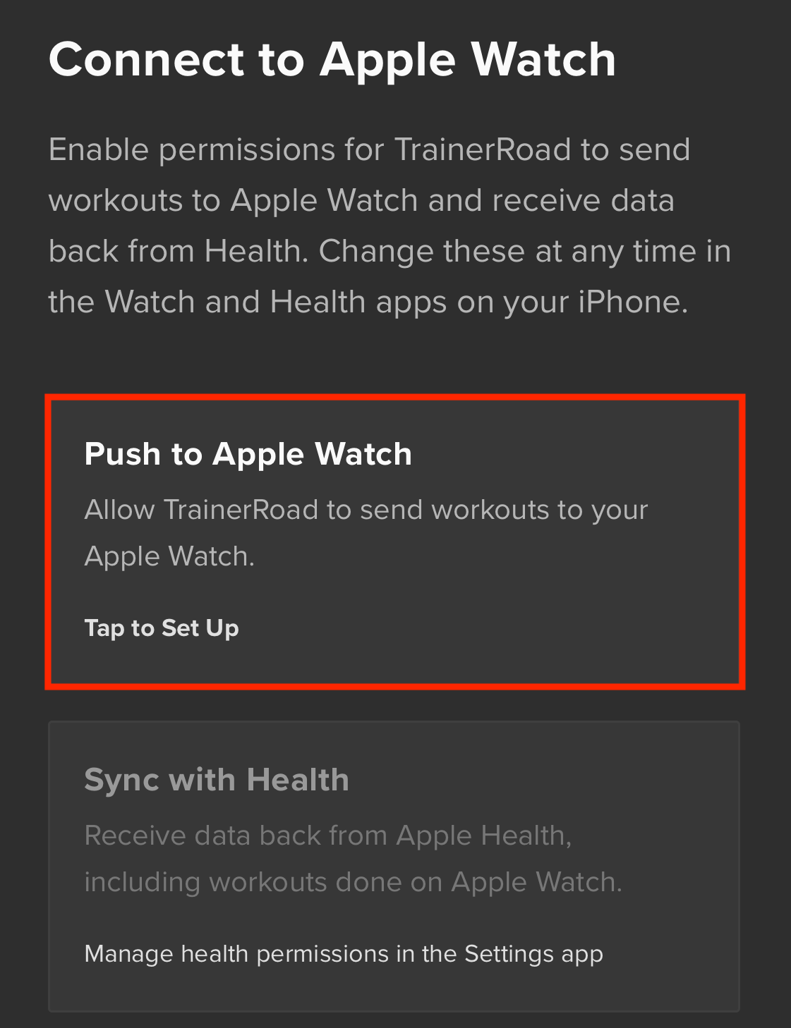

Note: If you did not receive this notification, head to your Account section on the iOS app, scroll down, and select "Connect to Apple Watch."
From here, you will want to select Tap to Set Up listed under both "Push to Apple Watch" and "Sync with Health".

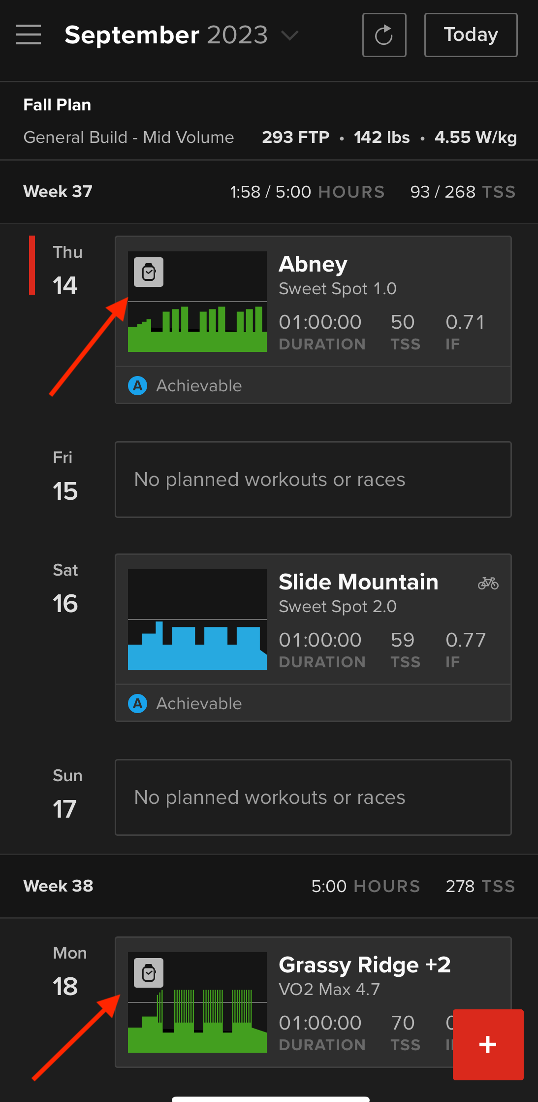

It should be noted though, that an Apple Watch icon will only display for pushed TR Outside Workouts in TrainerRoad's iOS apps.
TrainerRoad Outside Workouts that are part of your plan or scheduled within 7 days will automatically be pushed to your Apple Watch.

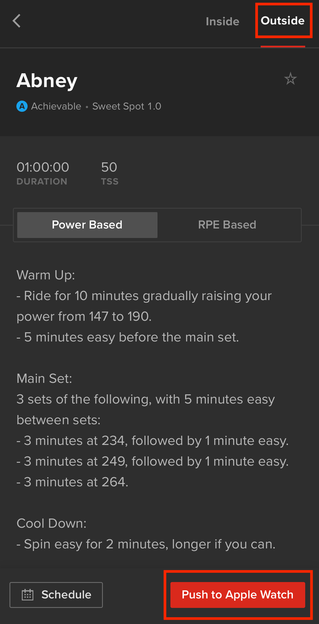

You can also push a TrainNow workout or a session from TrainerRoad's workout library manually using the process below:
  1. Select the workout that you would like to complete, either from TrainNow or a specific workout from our workout library.
  2. Next, make sure that the session is marked as an Outside Workout. Inside Workouts cannot be pushed to Apple Watch devices
  3. Once the workout has been added to your Calendar, it will automatically push to your Apple Watch, just like a planned workout.
  • TrainerRoad Outside Workouts that you don't have planned can also be pushed to the Apple Watch "moment of" via the Push to Apple Watch button.
Workouts that have been successfully pushed to your Apple Watch will display a small watch icon in iOS TR apps, indicating a successful sync.

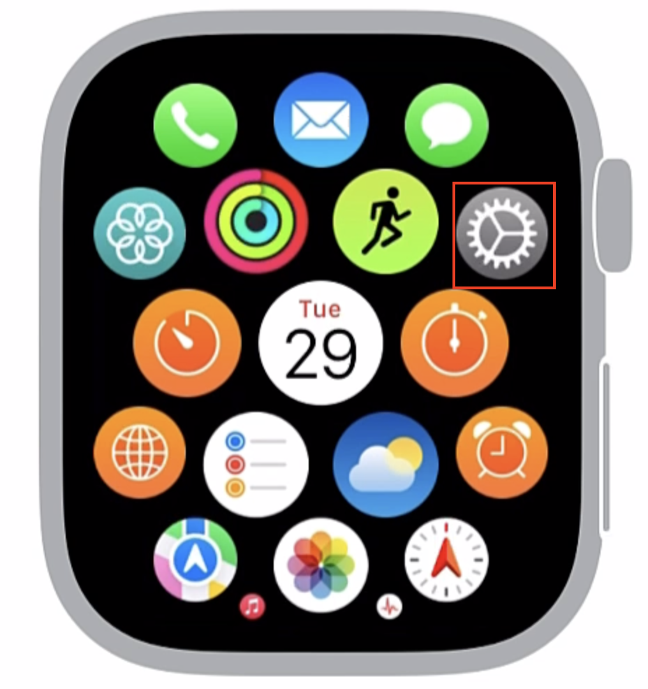

To start a TrainerRoad Outside Workout on your Apple Watch you will first want to connect your training devices (power meter, heart rate monitor, etc) via Bluetooth.
  • This needs to be done within the Settings App of your Apple Watch. Just click on Bluetooth and connect any of the devices that you wish to train with during your workout.

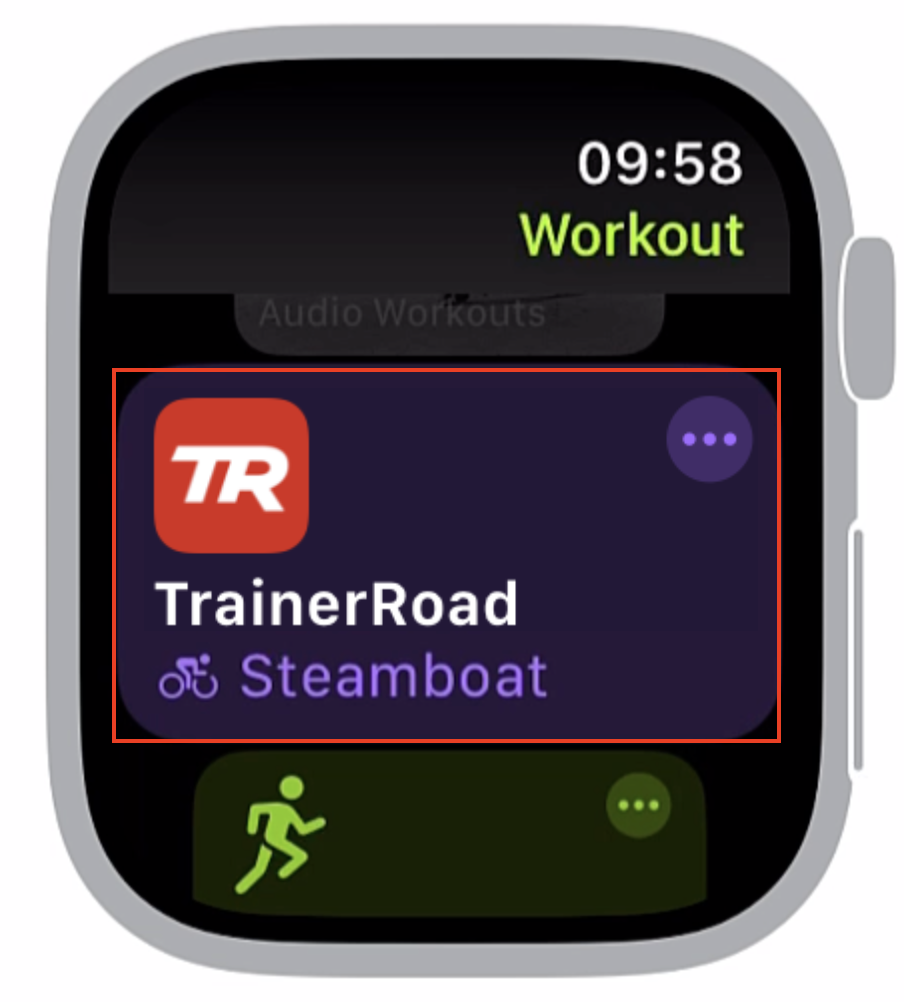

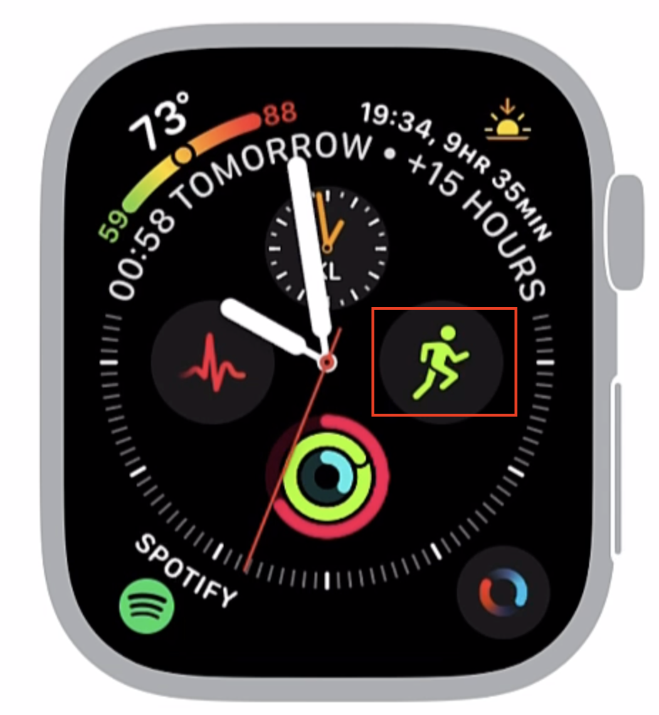

Once you have connected your training devices, go ahead and open the Fitness App on your Apple Watch
Then click on your scheduled TrainerRoad Outside Workout

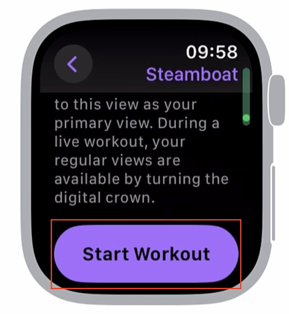

You will then be presented with the workout details for your upcoming session. Once you are ready to start pedaling, go ahead and click Start Workout

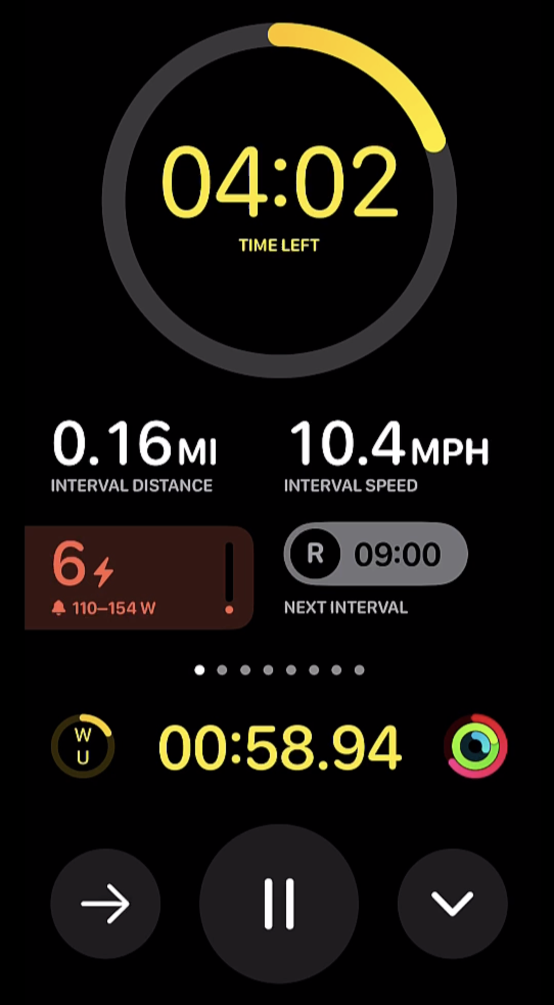

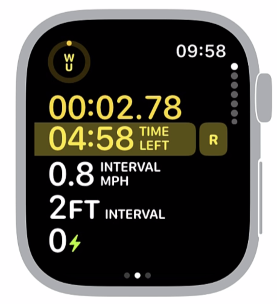

Your Apple Watch will then display the target metrics for each portion of your workout, guiding you through your session just like your Indoor TrainerRoad Workouts.

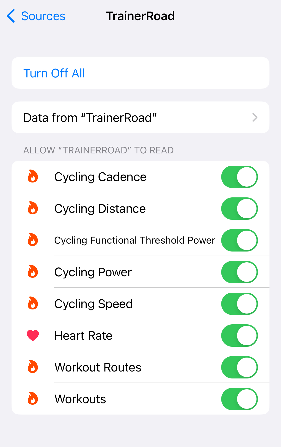

If your TrainerRoad Outside Workouts are not showing up on your Apple Watch device, the first thing to check is that you have your TrainerRoad account connected to Apple Health, and have granted all of the following Apple Health permissions.
