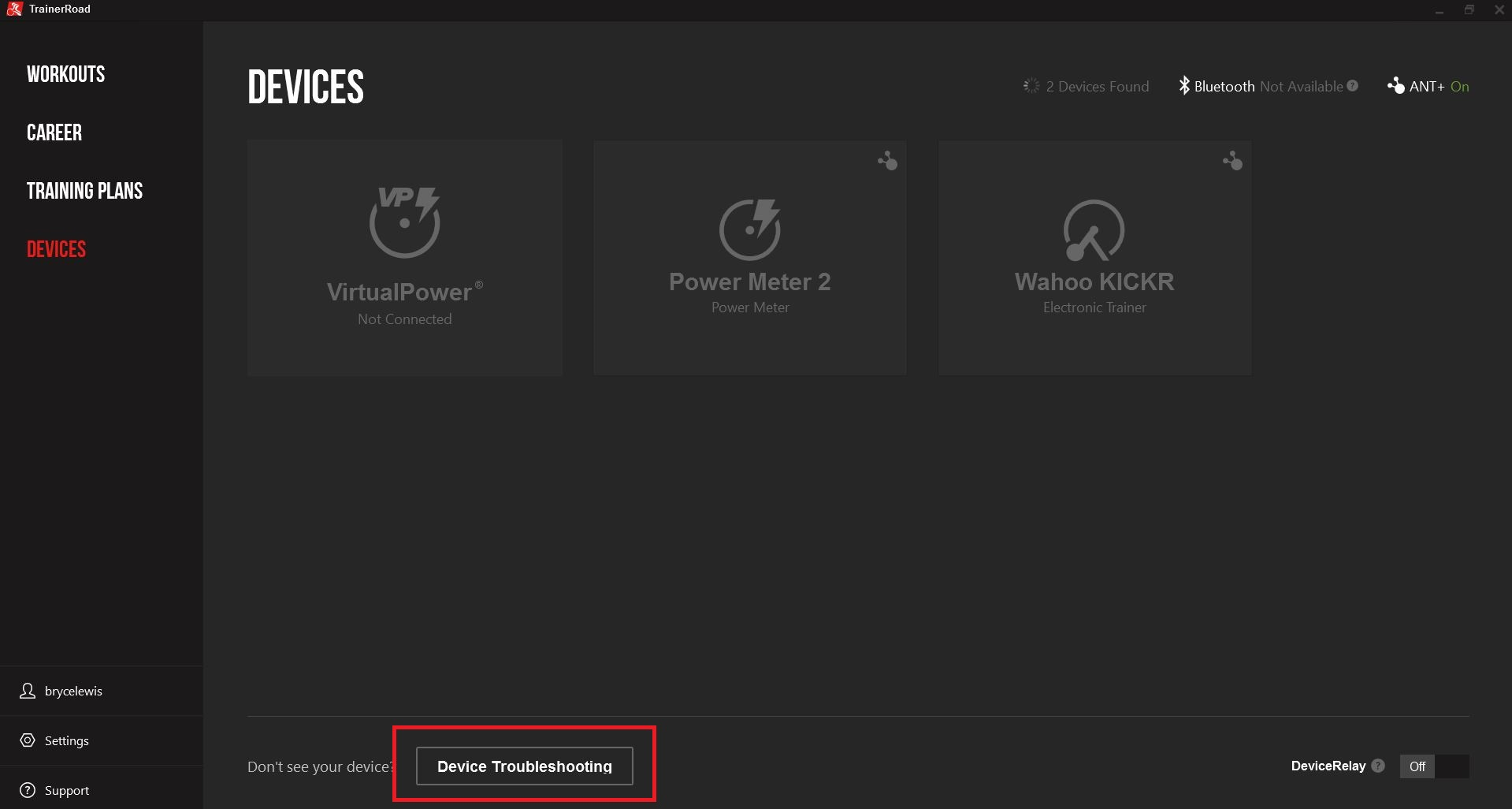

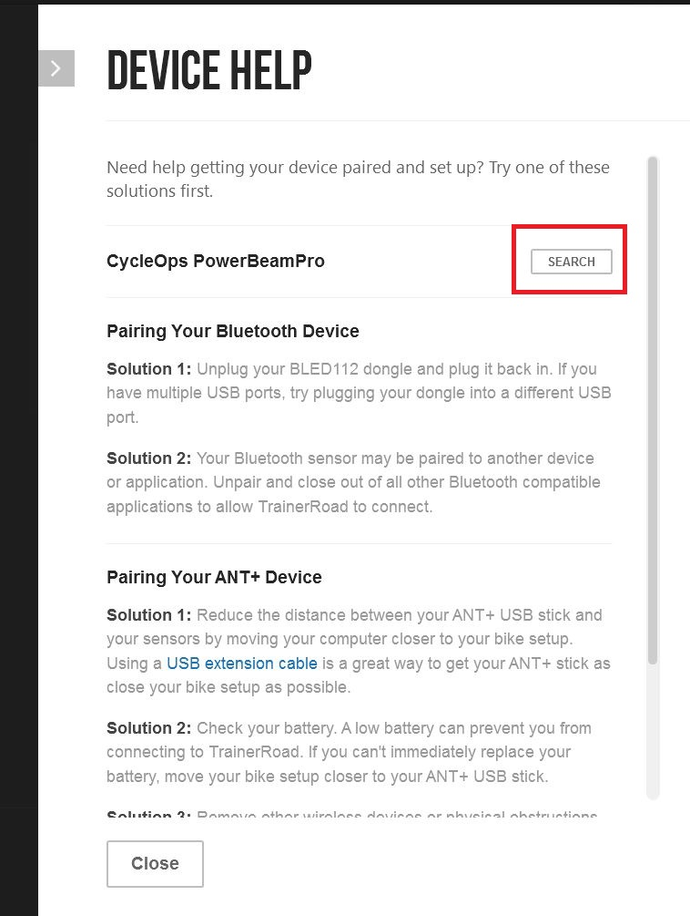

  4. Click Device Troubleshooting at the bottom

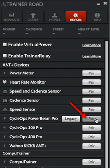

  5. Click Search next to the PowerBeamPro
  6. Click Pair when the PowerBeamPro is discovered
    • PowerBeam Pro should show up Green in your Devices Tab, signifying that it has successfully paired.

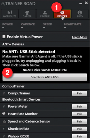

Step 2. Plug in your ANT+ USB stick.
Step 3. Go to the Devices tab. If your screen looks like the one below after clicking the "Devices" tab, click "Search for ANT+ USB". (If you don't see this button, then good news! TrainerRoad already found your ANT+ USB stick)

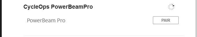

After your ANT+ USB stick is connected, you should see the screen below. Scroll down to where you see the PowerBeam Pro listed, and click "Pair."
If you have an older Power Beam Pro, clicking "Pair" may not be successful. If this is the case, you can connect with TrainerRoad by clicking "Legacy" instead of "Pair."

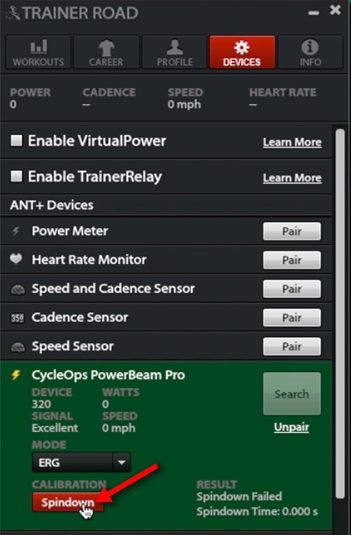

Once the device is paired, it's time to do a Spindown Calibration.
A Spindown Calibration aims to quantify the variable of rolling resistance (affected by tire pressure and trainer pressure) in order to get more accurate power readings. This should be done often, not just on the initial setup.
Doing it every other ride, or even every ride, isn't a bad idea. After pairing the device, look for the "Spindown" button below the mode selection button.

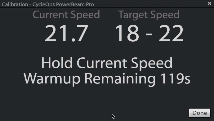

Step 1. As indicated in the window below, maintain a speed between 18-22mph for 120 seconds.

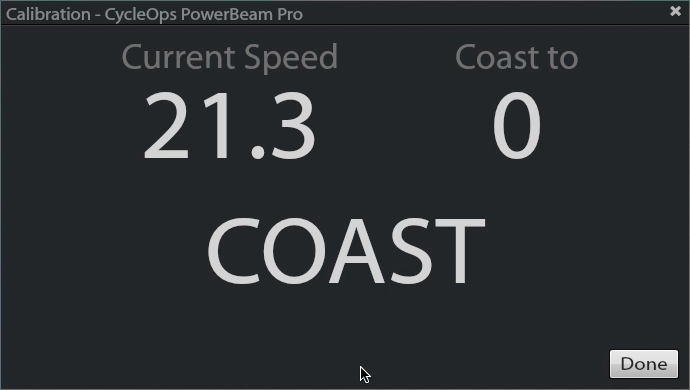

Step 2. After maintaining the speed for the indicated time, stop pedaling and let your bike coast to a stop.

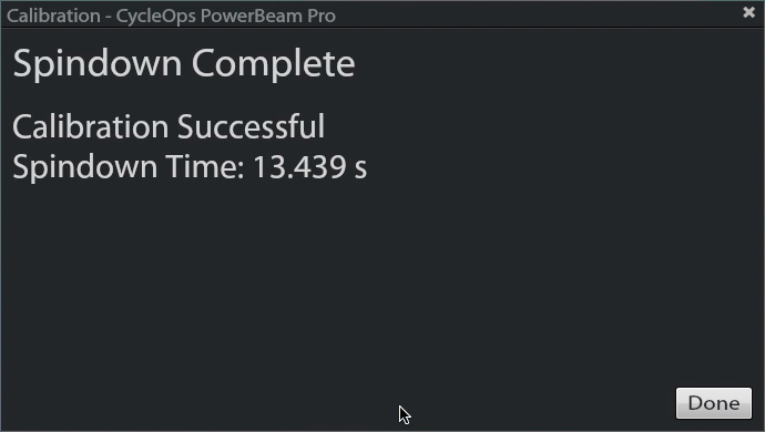

Step 3. Once your bike has coasted to a stop, you should see the following message. Click "Done" and you're ready to ride!

Visit our Device Pairing Troubleshooting page.

Spindown Calibration Problems?
Have you been spinning down your PBP and TrainerRoad says something like there's 65,000 seconds left? That's actually the PBP's way of indicating that something went wrong with the spindown. This is usually due following the spindown steps incorrectly. This error can also be caused if the signal was interrupted during spindown. In order to fix this, try the following:
    • Unplug your PBP for about 5 minutes and reconnect your power cord to your PBP (restart it)
    • Restart TrainerRoad
