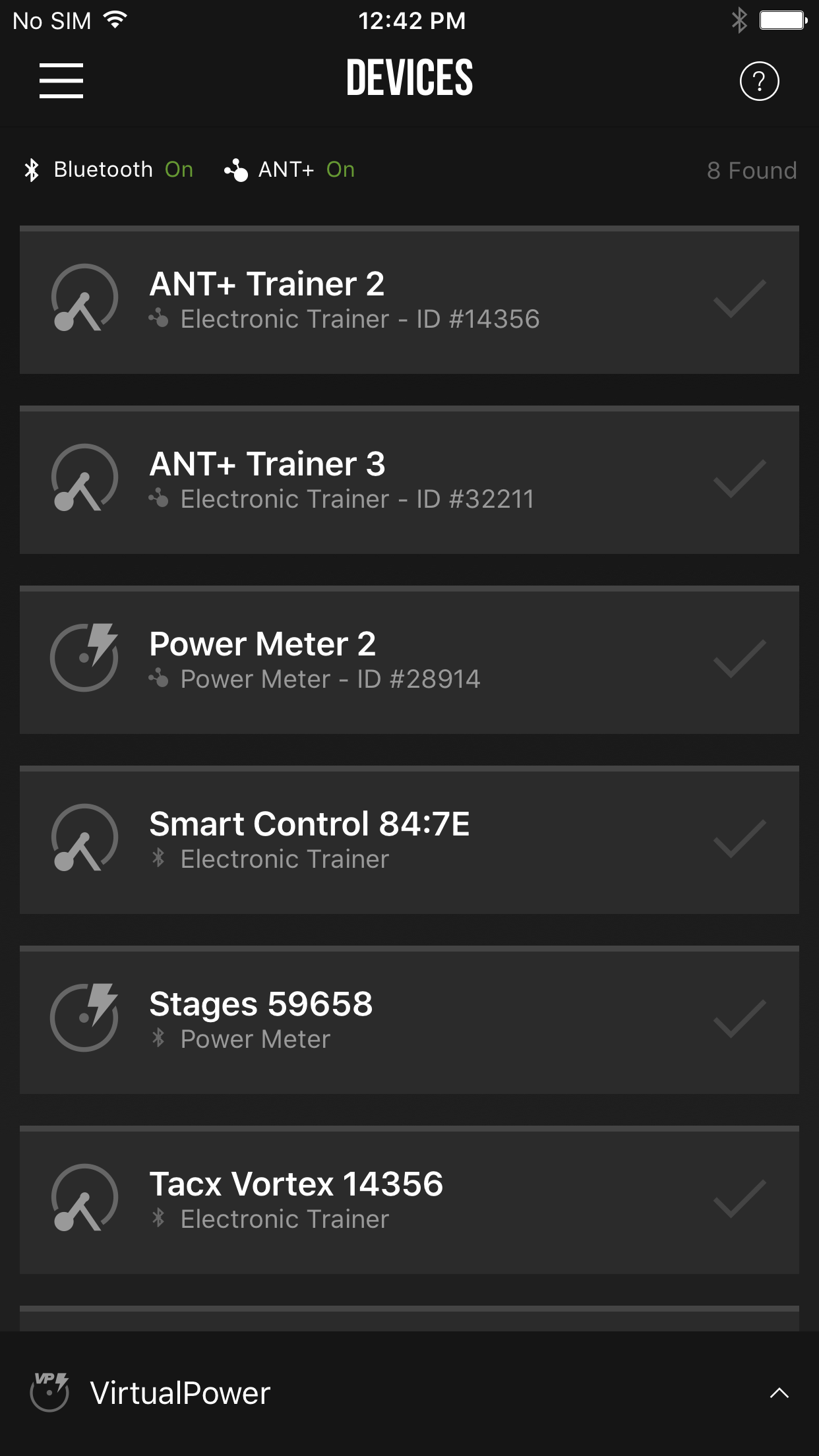

How to Pair Your Garmin Vector with TrainerRoad (Mobile)
Step 1: Navigate to the Devices tab and make sure ANT+ or Bluetooth is turned on.

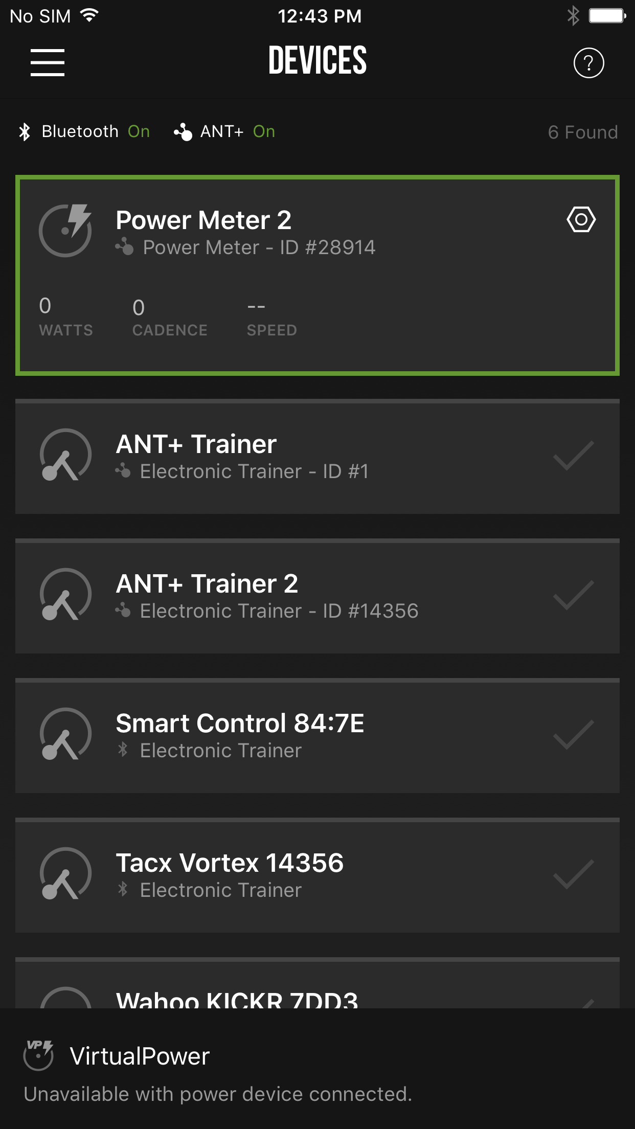

Step 2: Wake up the power meter by pedaling, and tap on the Power Meter.
The power meter is paired when it's bordered in green.

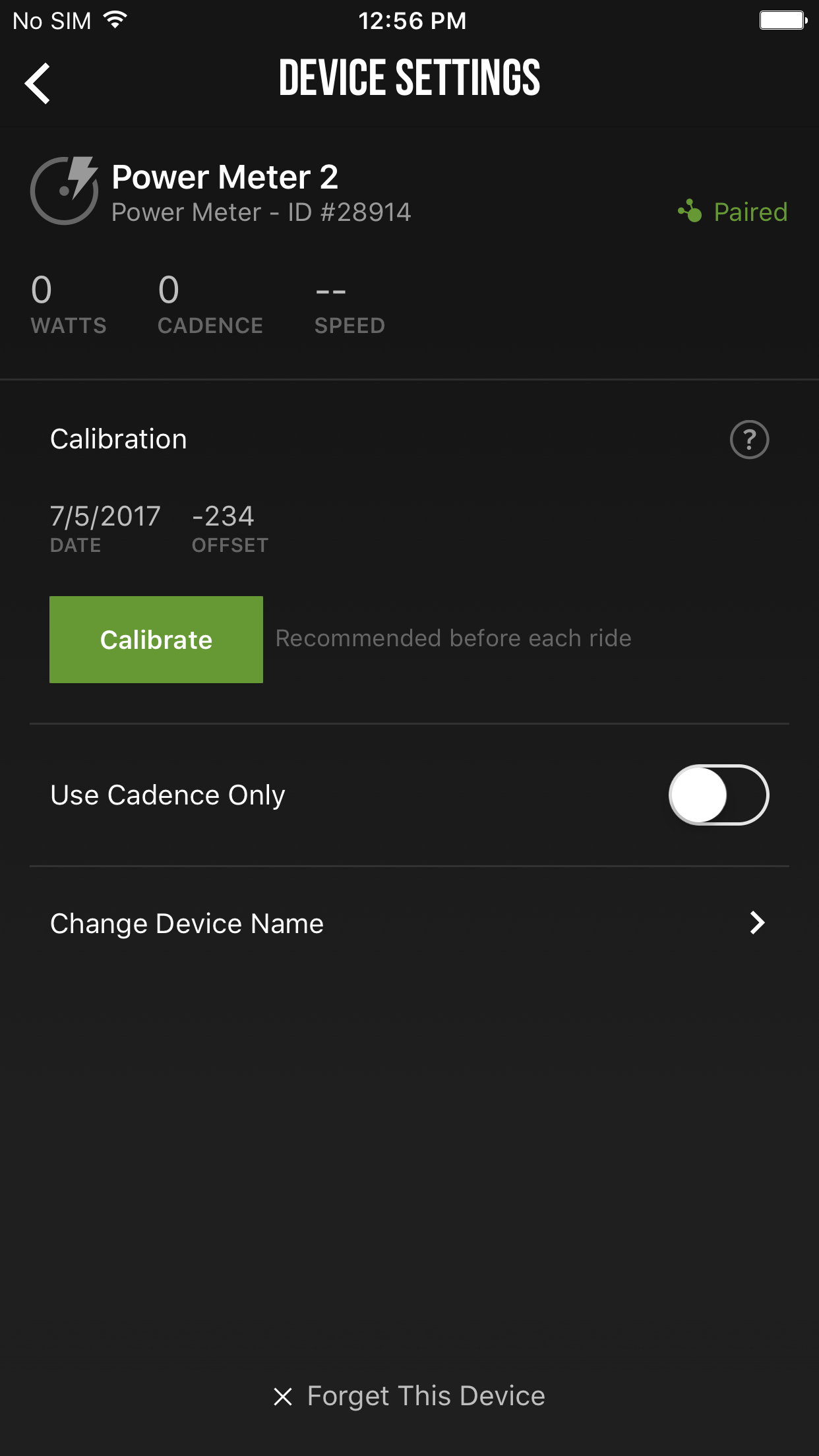

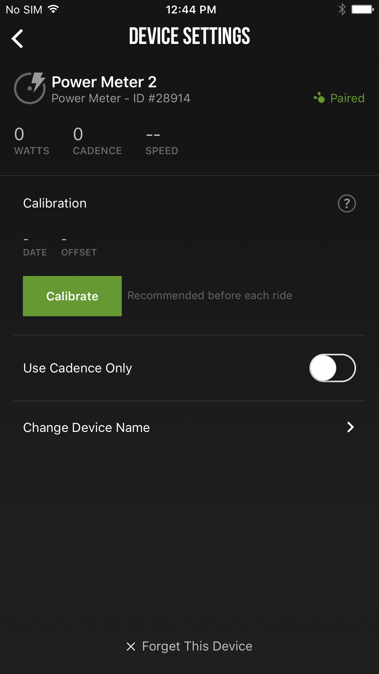

Step 3: Tap on the power meter again to drill into the device settings.
Step 4: Tap "Calibrate".
You're ready to ride after you calibrate.

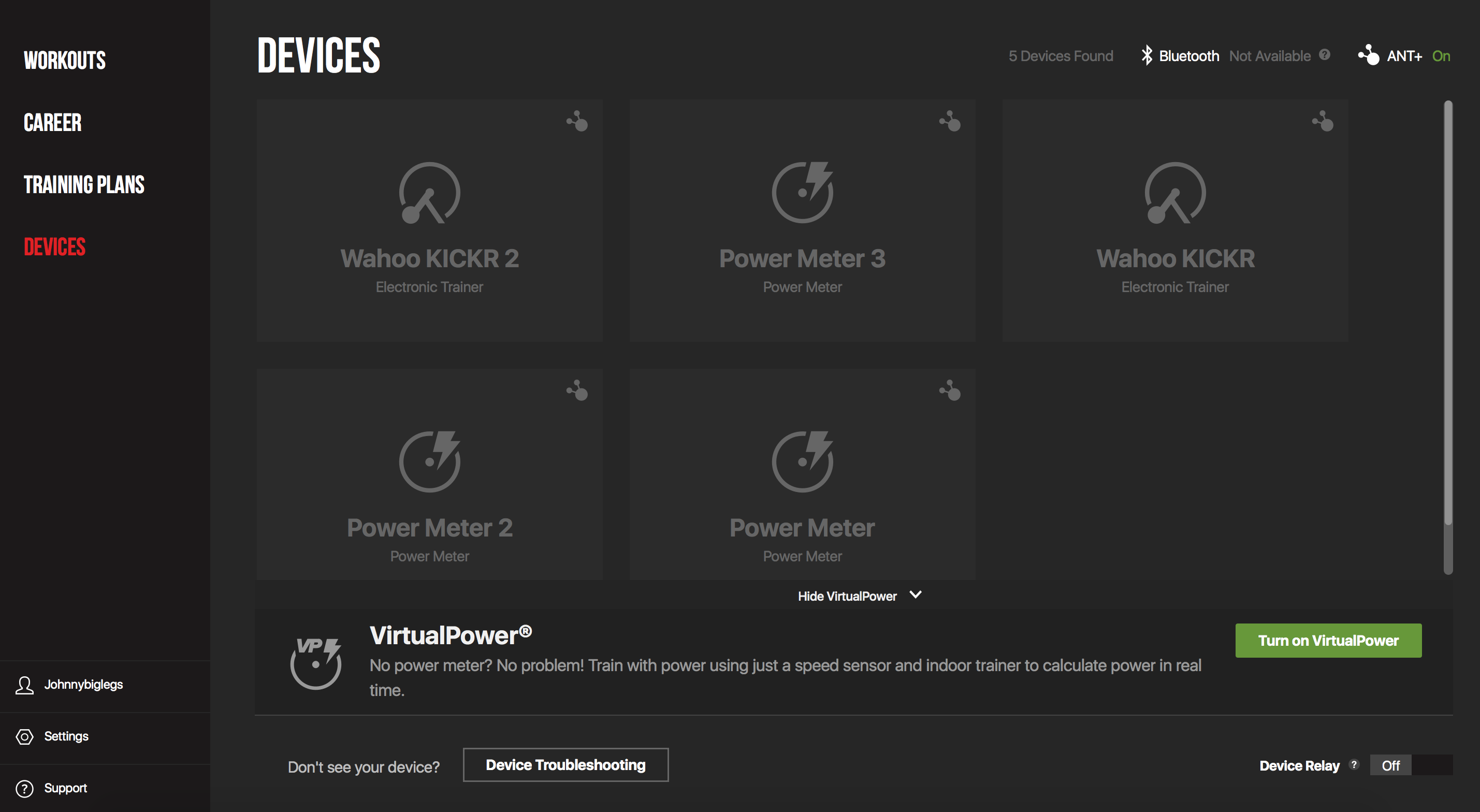

How to Pair Your Garmin Vector with TrainerRoad (Desktop)

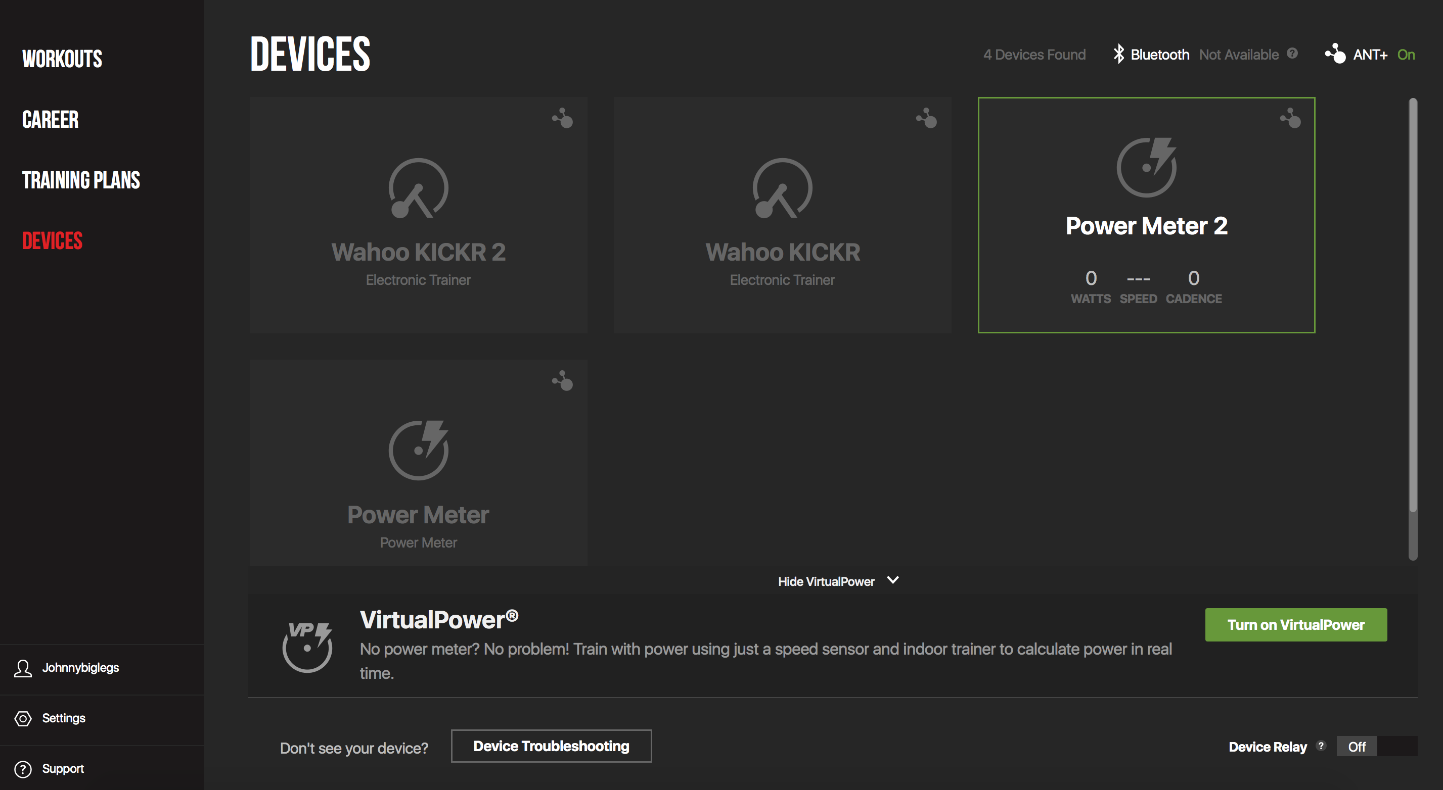

Step 1: Open the TrainerRoad app, go to the Devices section, and confirm ANT+ or Bluetooth displays as "On" (top, right-hand corner of the window).
Step 2: Wake up the power meter by pedaling, hover over the Power Meter tile, and click to begin pairing.
Pairing is complete when your power meter is bordered in green.

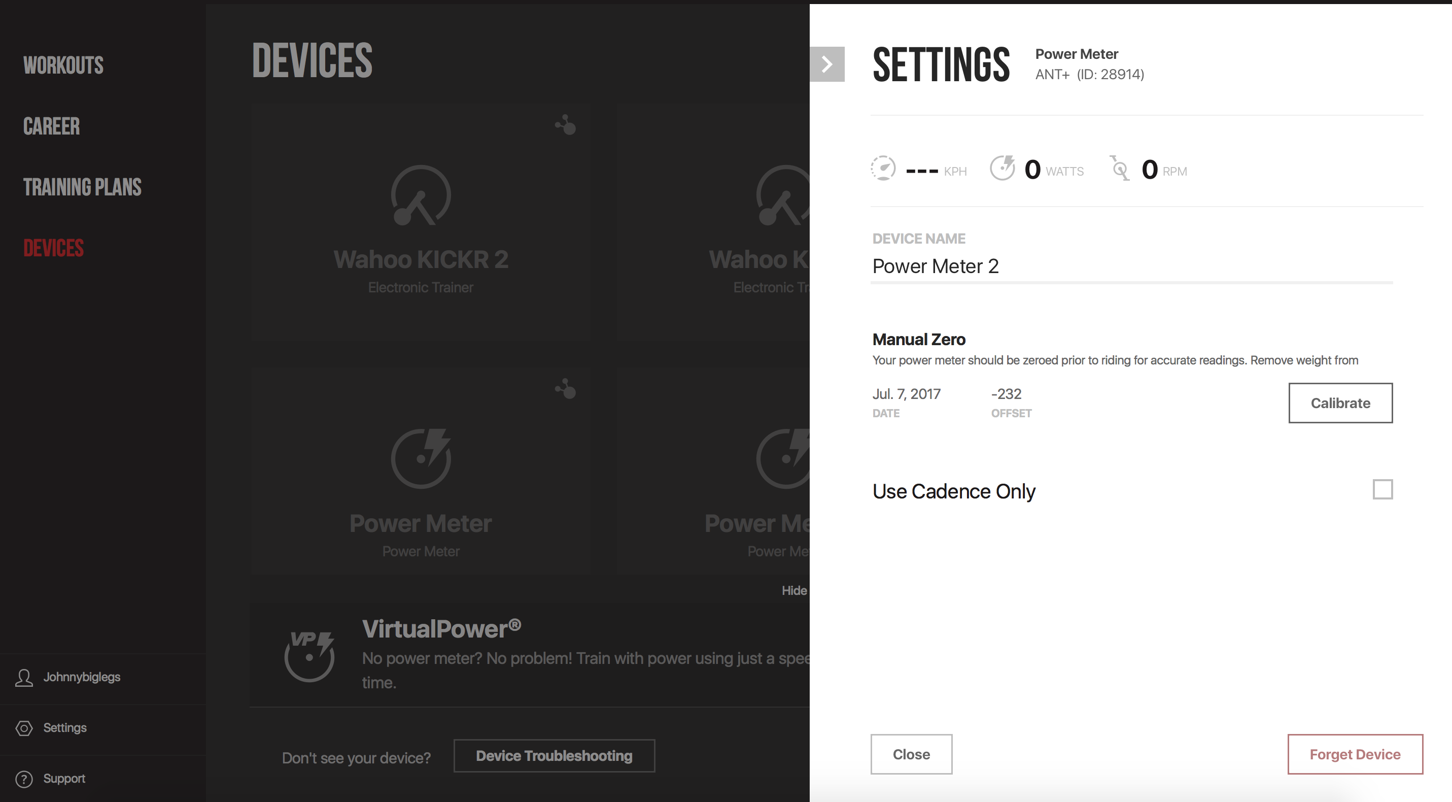

Step 3: After it's paired, click on the power meter tile again to open the Device Settings menu. From here, select "Calibrate".

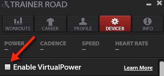

Step 5: Make sure that Enable VirtualPower is UN-checked.
If VirtualPower is enabled, TrainerRoad will ignore readings from power meters and derive power from speed readings. Make sure to un-check the box pictured below. You're now ready to ride!
