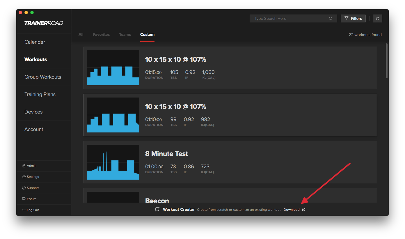

If you don't already have the Workout Creator installed, you'll be prompted to download it from the banner at the bottom of the "Custom" tab of the Workouts section of the app.

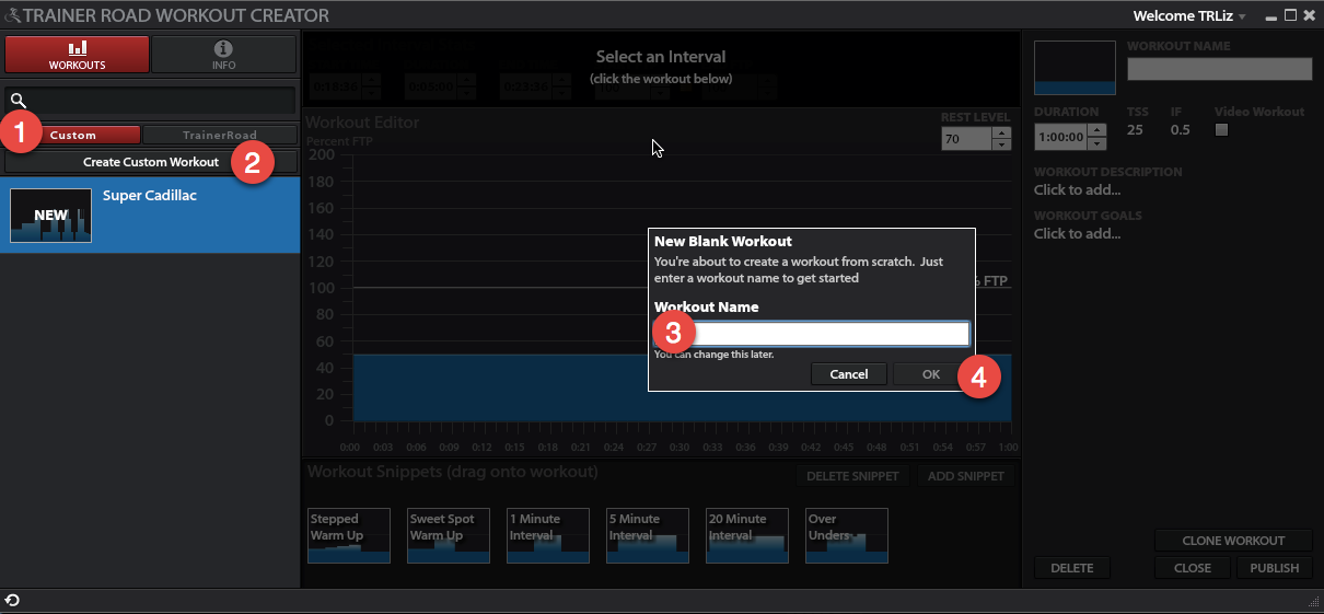

You can either create your own workout from scratch or copy a workout to use as a template.
Once you enter a name for your new workout and press "OK", you'll see the full workout creator where you can drag snippets into the base and customize however you want.

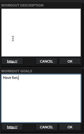

You can also add in a workout description and goals to remind you of the workout's purpose when it's in the app just like the other workouts in the TR workout library.

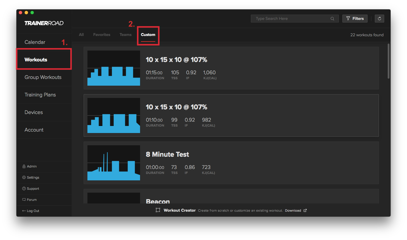

Once you publish the workout, it will be available for you to ride in the app. The easiest way to find all of your custom workouts is to use the 'Custom Workout' filter.
