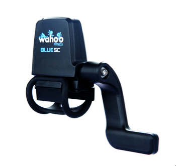

The Wahoo Blue S/C sensor is a popular speed/cadence sensor combo. The latest models can be paired either via ANT+ or Bluetooth Smart (4.0), and can therefore be used with TrainerRoad for speed, cadence, and VirtualPower readings.

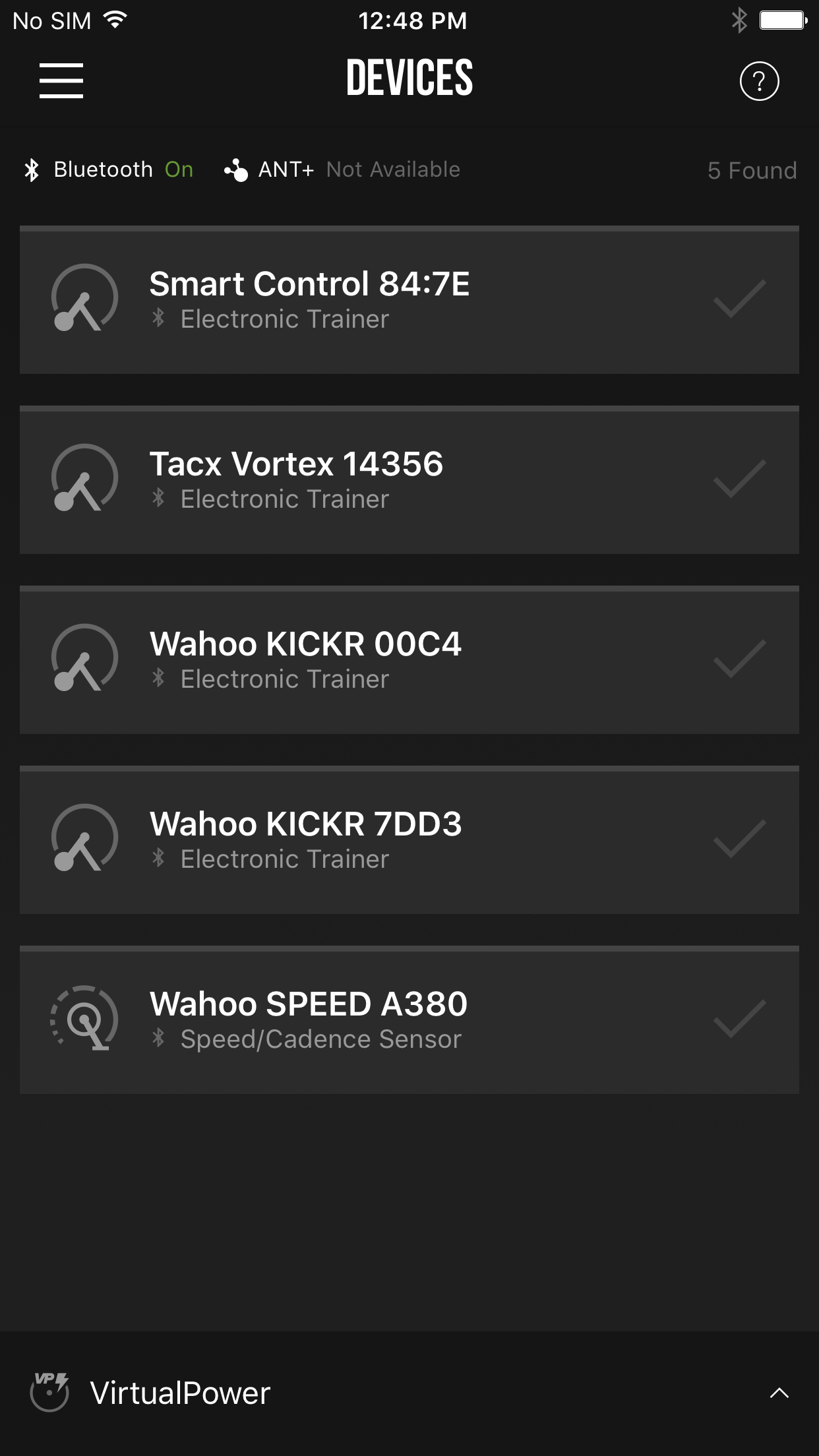

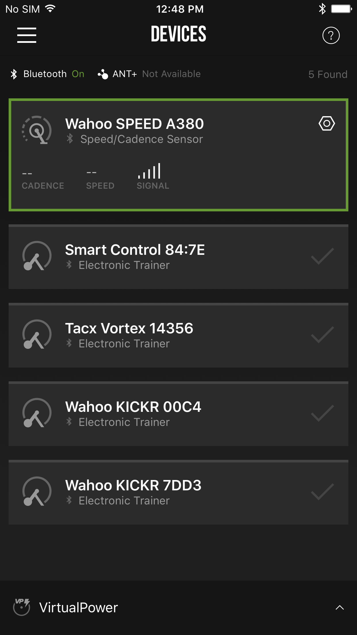

How to Pair Your Speed/Cadence Sensor with TrainerRoad (Mobile)
1. Navigate to the Devices section of the app, make sure you have Bluetooth or ANT+ enabled, and the speed/cadence sensor is awake.
2. Tap on the speed/cadence sensor to begin pairing.
Note: ANT+ users will see the device listed as "Speed/Cadence".

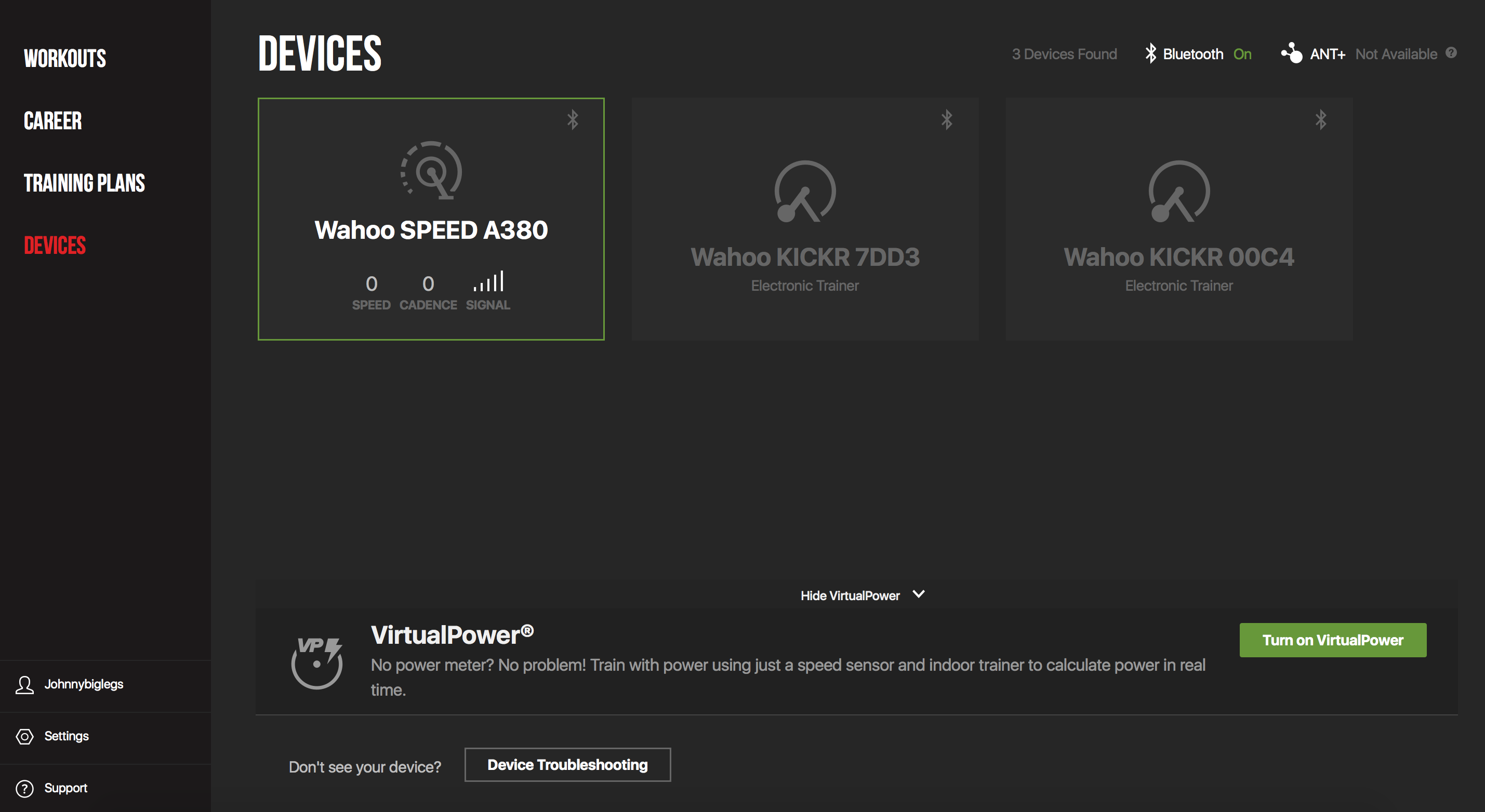

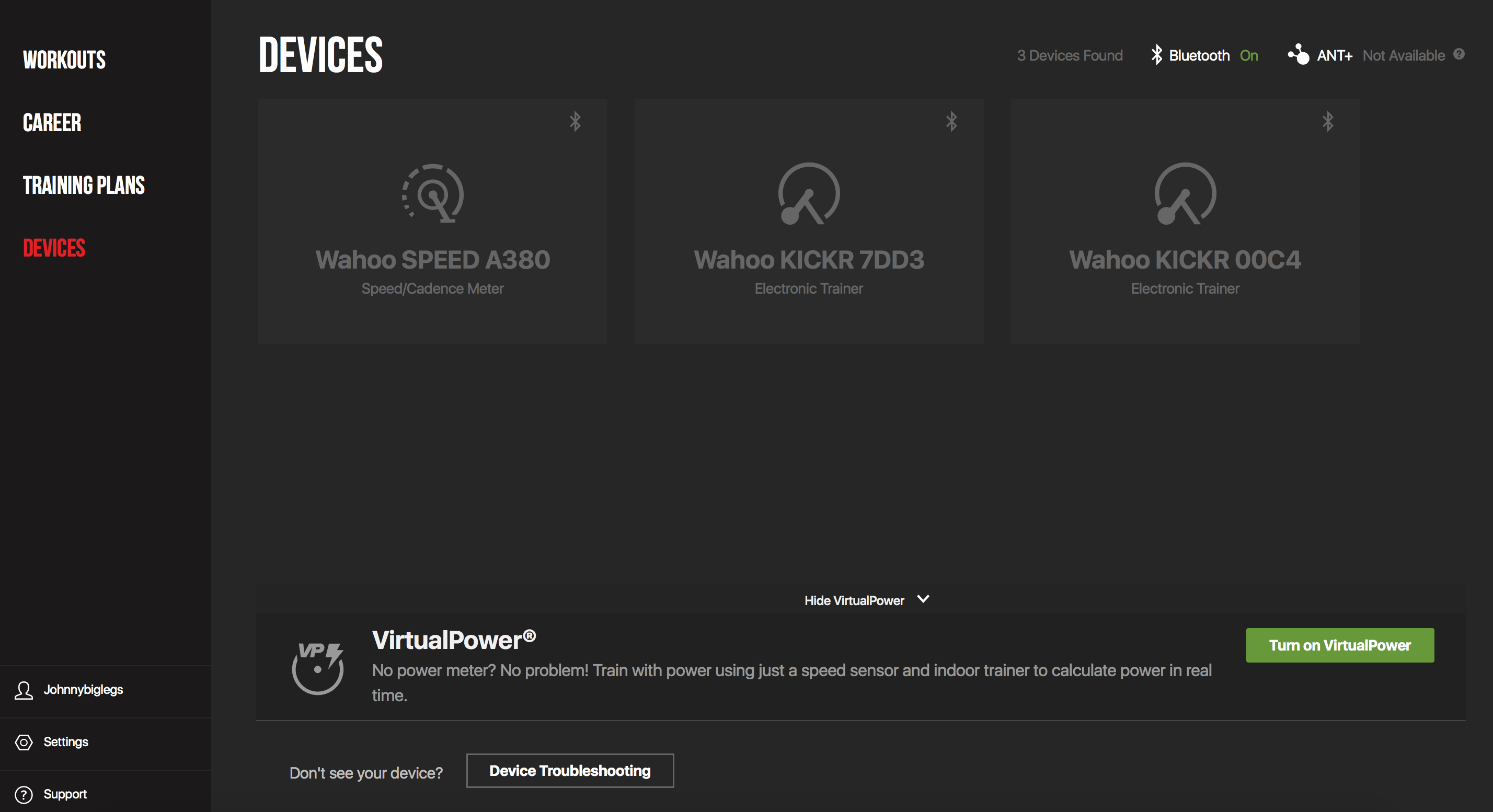

How to Pair Your Speed/Cadence Sensor with TrainerRoad (Desktop)
2. Hover over and click on the Blue to begin pairing. Once the device is bordered in green it has successfully paired.

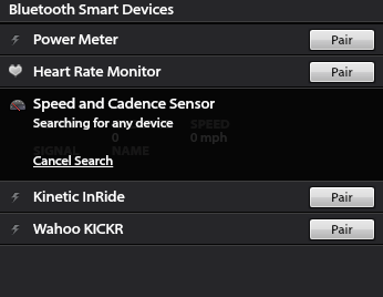

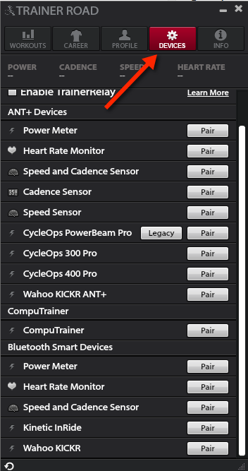

How to Pair Your Speed/Cadence Sensor with TrainerRoad (Legacy)
1. Open the TrainerRoad application, and go to the Devices tab.

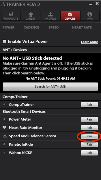

Make sure you scroll down to the list of Bluetooth Smart devices.
2. Click the "Pair" button that corresponds with Speed and Cadence Sensor under the list of Bluetooth Smart devices.
You will need to pair your sensor as a speed and cadence sensor even if you are using only the speed or cadence portion of the sensor.
3. Wait for your sensor to pair with TrainerRoad.
You will likely need to pedal to "wake up" your sensor.
4. Your Wahoo Blue is now paired!
