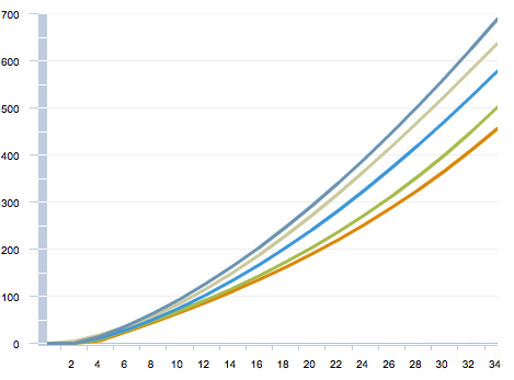

Magnetic and fluid trainers have variable resistance settings, and each of these settings have their own power curve (speed-to-power ratio). For more information on how these readings are derived, learn how VirtualPower works.
This graph displays each power curve for every resistance level on a single trainer. The X-axis represents speed while the Y-axis represents power measured in watts.
Since each resistance setting on your trainer has its own power curve, you'll need to choose which level you're training with.

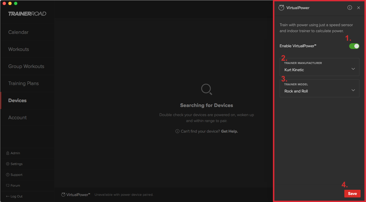

Desktop
Step 1: Pair your speed/cadence sensor in the Device section of the app
Step 2: Select Turn On next to VirtualPower, then select the Enable VirtualPower toggle
Step 3: Select the make and model for your trainer
Step 4: Choose a Resistance setting (if any) from the drop-down menu
Note: Make sure the resistance setting you have on your trainer matches the selection within TrainerRoad's VirtualPower settings. If you change the setting, you'll need to change the selection in TrainerRoad.

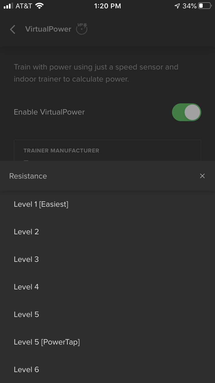

Mobile
