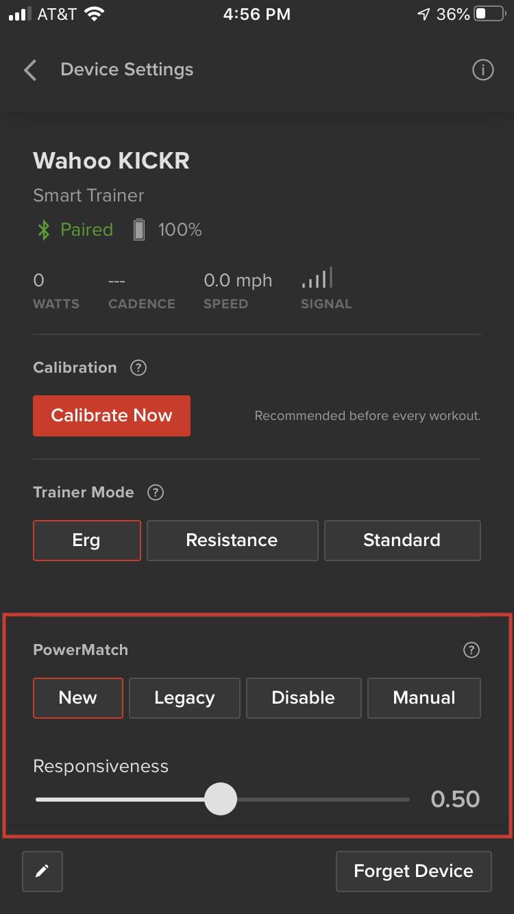

Using PowerMatch with Mobile
TrainerRoad's default PowerMatch setting is to use the power from the power meter to control the smart trainer's resistance. Simply pair the power meter and smart trainer, make sure PowerMatch is set to "New", and TrainerRoad will take care of the rest!
Additionally, the offset between the power meter and smart trainer will be measured, and the trainer adjusted (if necessary), constantly.
Note that the power meter will display as your power source in your Online Career.

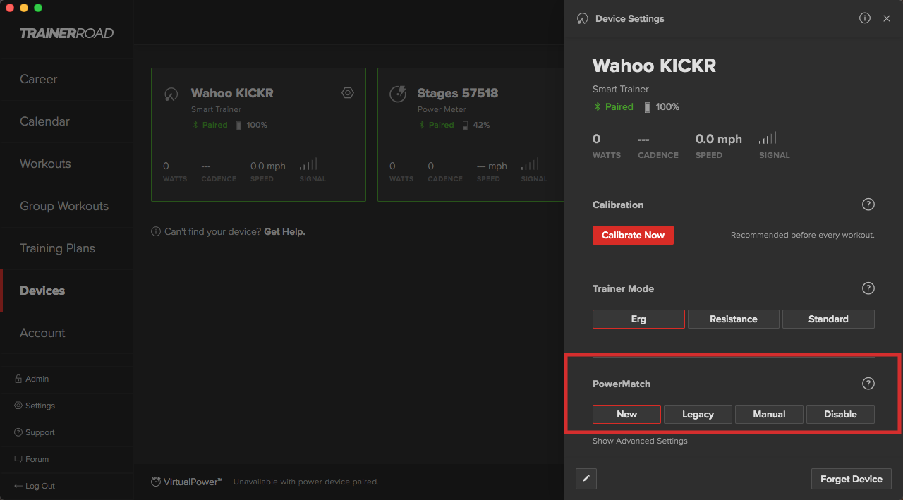

Using PowerMatch with Desktop
TrainerRoad's default PowerMatch setting is to use the power from the power meter to control the smart trainer's resistance. Simply pair the power meter and smart trainer, and TrainerRoad will take care of the rest!
If you wish to disable PowerMatch or apply a consistent offset, you may do so under the Device Settings menu, by clicking on the paired smart trainer.
Sensitivity Setting
Sensitivity is an advanced setting for our newest version of PowerMatch. It is set at 0.5 by default, which proved to be a better experience for most athletes. However, you may find that a different setting works better for your power meter / trainer combination and or personal preferences.
A higher value should translate to quicker update to the trainer / power meter offset. While this may sound desirable, updating too fast can make for jumpy resistance levels. A lower sensitivity will likely result in smoother power, but the resistance adjustments from changes in power offset may take longer.

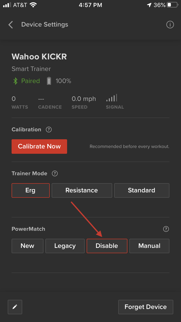

How to Disable PowerMatch
If you wish to disable PowerMatch, you may do so within the pairing screen of your smart trainer.
Disabling PowerMatch will prompt TrainerRoad to display and record power readings from your power meter if both a power meter and smart trainer are paired at the same time. ERG mode is still available; however, the smart trainer will use its own power data to calculate resistance instead of the data from your power meter. If there is a discrepancy in power readings between the smart trainer and power meter, disabling PowerMatch can make it look like you are constantly above or below the power target.

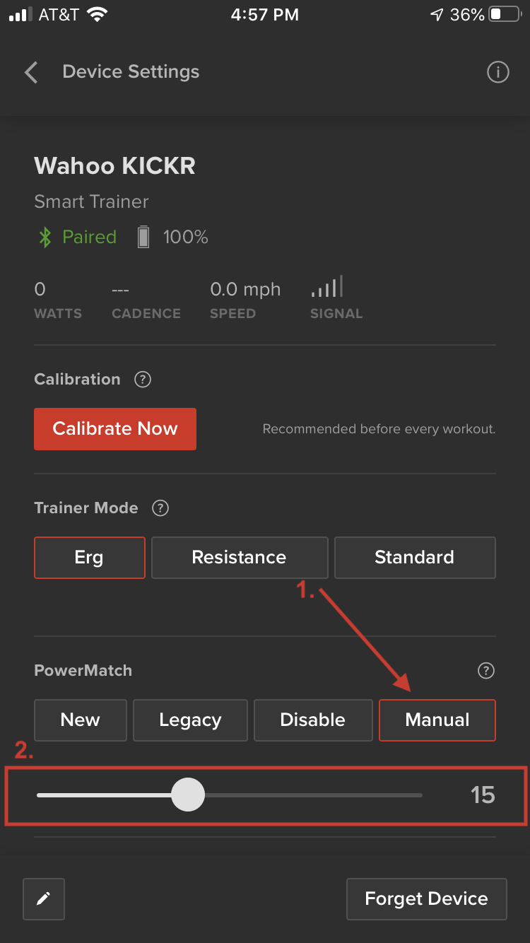

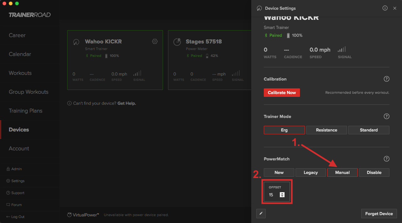

Apply Consistent Offset Between Trainer/Power Meter
If you know the power offset between your trainer and power meter and do not wish for TrainerRoad to continuously measure and adjust this, you can input this offset to be applied to the entire workout. You can do this within the pairing screen of your smart trainer.
Note: The offset calibrates your trainer to your power meter. In other words, the manual offset adjusts your trainer to be at the same output as your power meter.
For example, if your trainer reads 200 watts and your power meter reads 210 watts, you will apply a -10 watt offset.

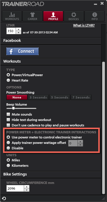

Using PowerMatch with Legacy AIR App
Additionally, the offset between the power meter and smart trainer will be measured and adjusted (if necessary) every ten seconds as per the default settings.
If you wish to disable PowerMatch or apply a consistent offset, you may do so under your Profile tab.
Disabling PowerMatch will prompt TrainerRoad to display & record power readings from the power meter if both a power meter and smart trainer are paired at the same time. According to our device paring hierarchy, the power meter will take precedence over the trainer.
If you don't want to use PowerMatch, and you'd like power readings from only your smart trainer, unpair your power meter.

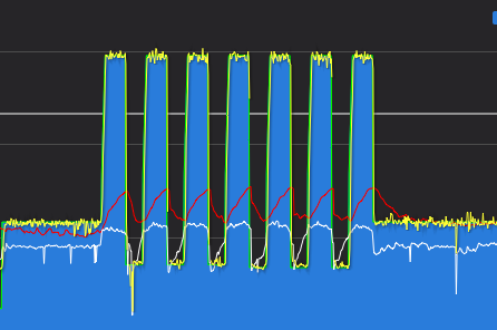

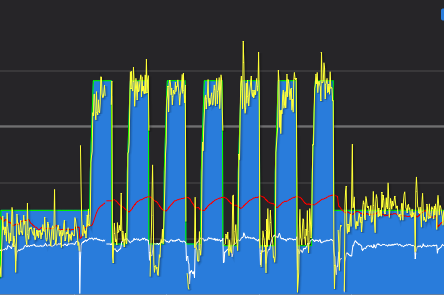

Why Does My Power Appear Less Smooth with PowerMatch Applied?
Those well-versed in smart trainer usage will be very familiar with the smooth nature of graphed power in ERG mode. This power appears so smooth primarily because of natural smoothing that the sizable flywheels of many smart trainers applies.
Many strain-gauge power meters measure power directly from the pedal, crank arm, or crank. This method of measuring power is more sensitive than what most smart trainers use, and thus, even riders with the smoothest pedal strokes will notice "jumpier" power readings. This is nothing to worry about so long as the fluctuations are not drastic.
Power Graphed with only Smart Trainer
Power Graphed with PowerMatch (Smart Trainer + Power Meter)
Despite these graphs appearing slightly different, both users got the same training benefit from these intervals. The top profile simply doesn't represent the actual fluctuations in power as clearly as the bottom.
