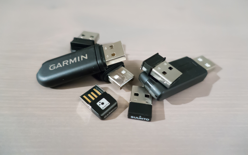

ANT+ USB1 sticks are no longer in production. All recently purchased ANT+ sticks will be of the USB2 variety. However, if you're using an older ANT+ stick, there's a chance it may be USB1.
You can tell if your ANT+ stick is a USB1 model in two ways:

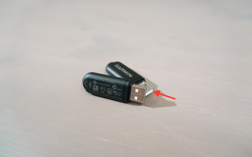

1. The stick will be labeled "USB1-Wireless USB Stick" on the reverse side of the stick.
2. If you have a Garmin-manufactured stick, the inner portion of the plug-in point will be white.

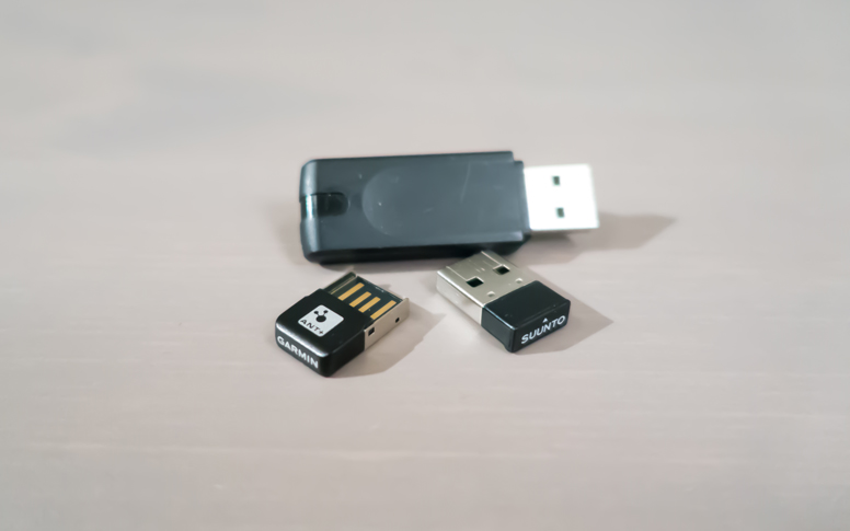

If neither of the above are applicable to your ANT+ stick, it's probably USB2. Additionally, all mini ANT+ USB sticks are USB2.
When do I need a USB2 ANT+ stick?
The above ANT+ USB sticks are all examples of USB2 products.
