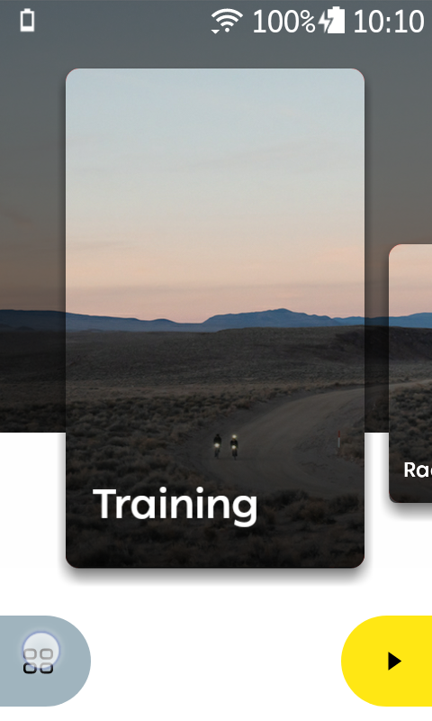

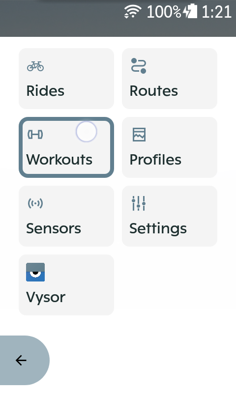

Step 2: Tap the Apps button in the bottom left hand corner of the home screen.

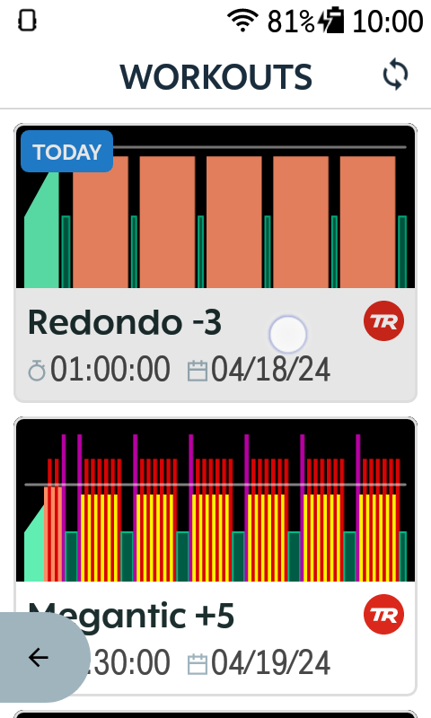

Step 3: Tap the Workouts Tab

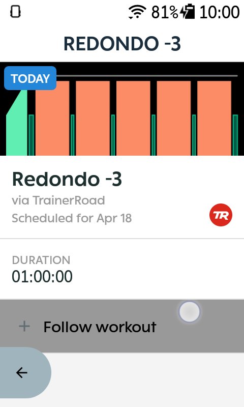

Step 4: Open today's workout

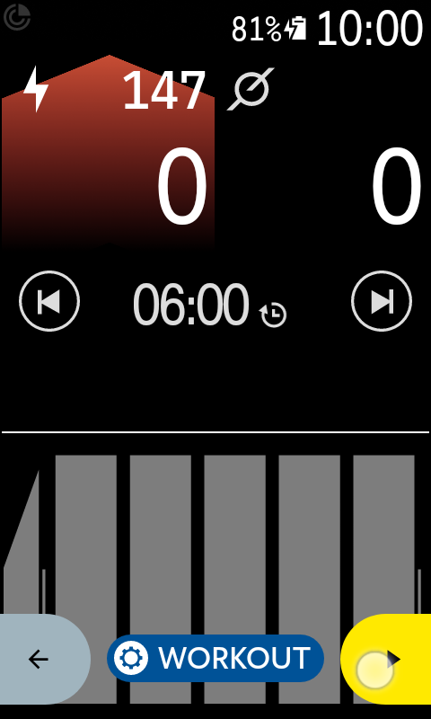

Step 6: Tap Follow Workout

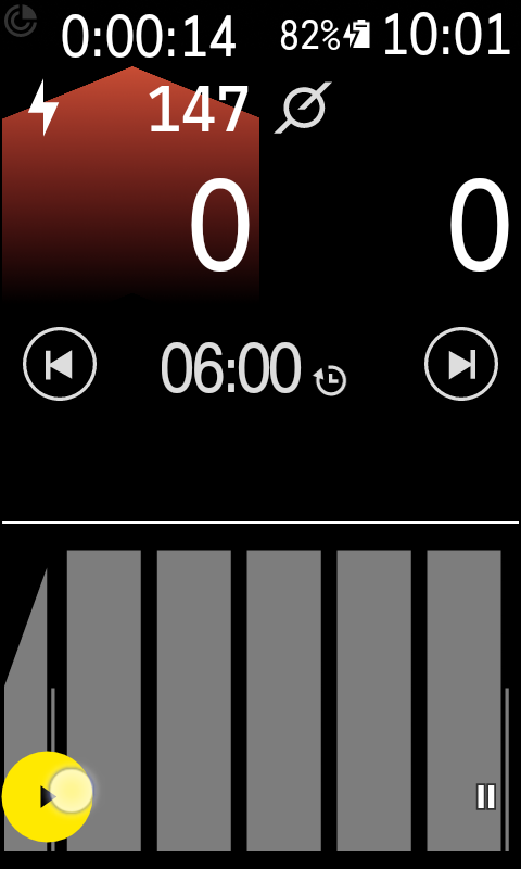

Step 7: Start your ride by selecting the yellow play button in the bottom right hand corner of the screen.
Step 8: When you are ready to start your workout you can start your workout from the Hammerhead Workout Screen by hitting the yellow play symbol now displayed in the lower left corner.

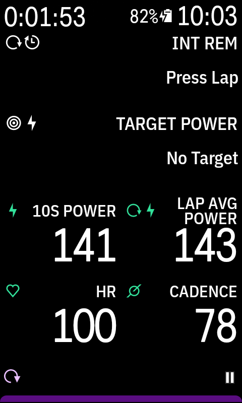

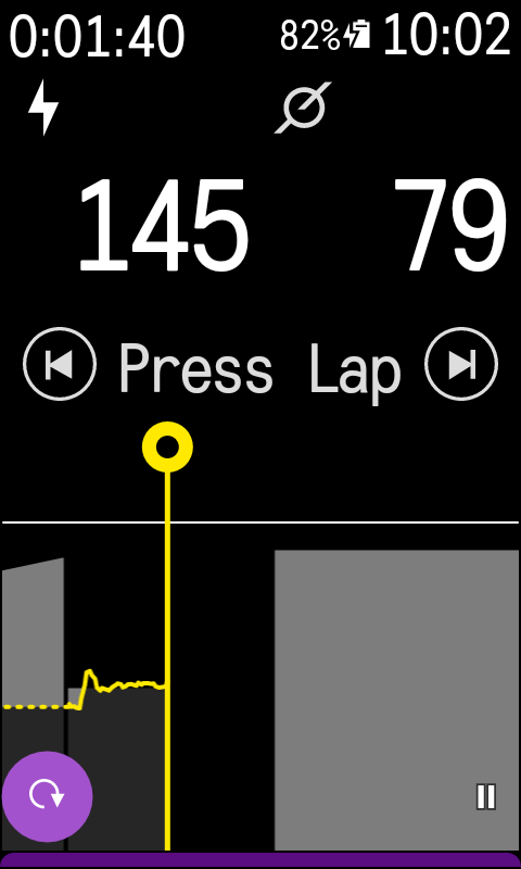

Step 9: Before starting a set, you will be prompted to "Press Lap" to start. This will allow you to get into a safe and appropriate position to do your intervals
You can also complete this step from the custom display you have created.

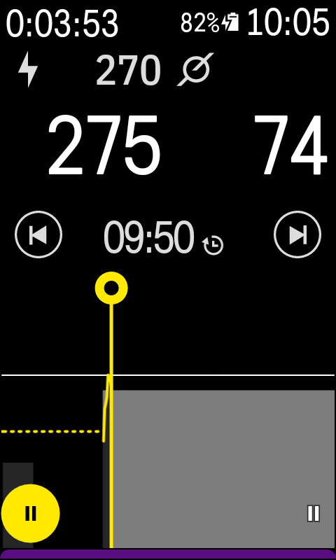

Step 10: Follow the prescribed power targets, using the yellow pause button on the primary interval page to pause and resume your workout when necessary.

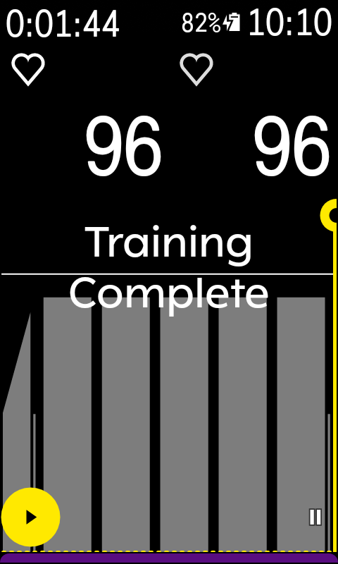

Step 11: Ride until workout is complete!
